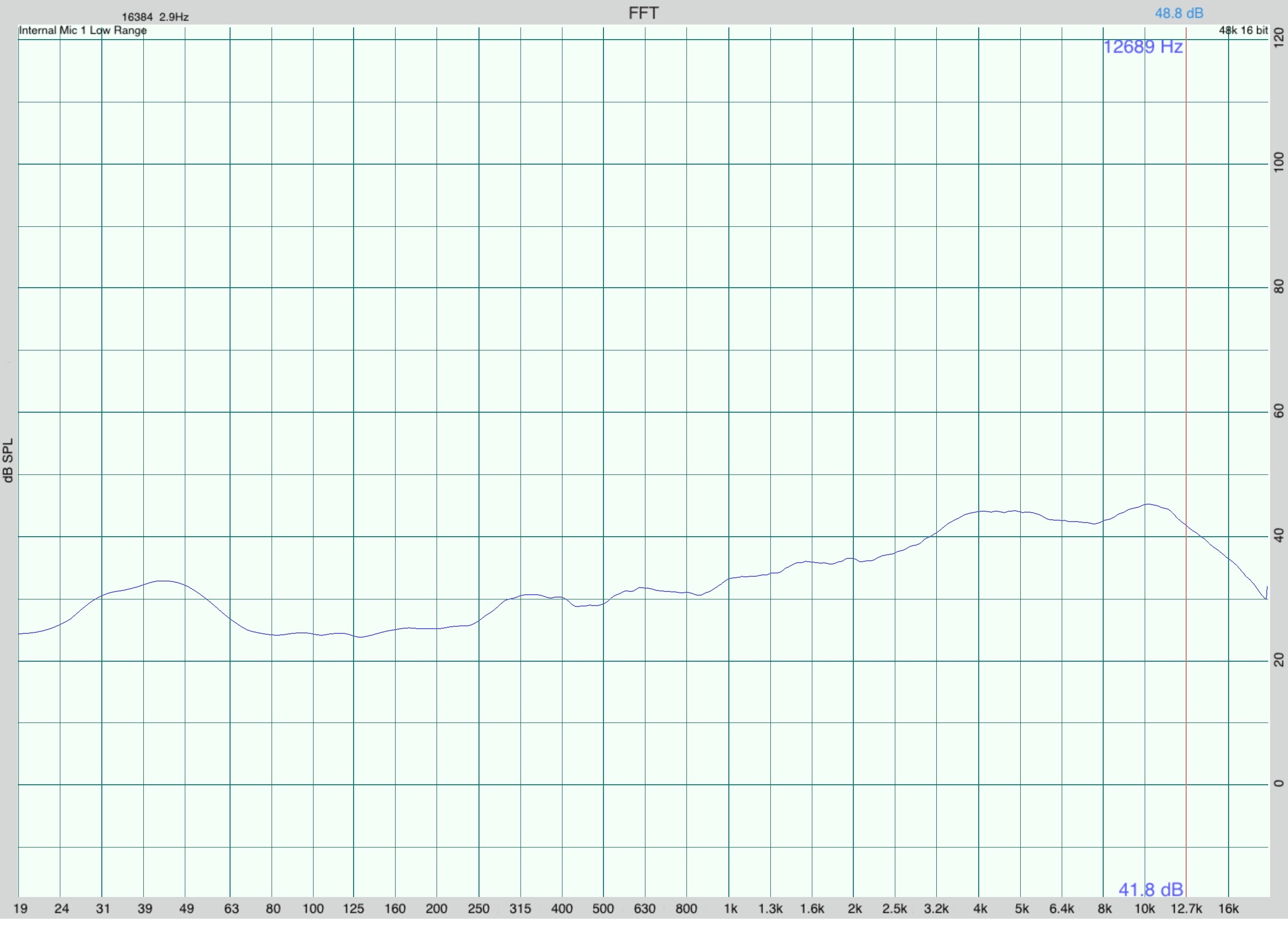

So I have a few things to share on the tests I have been making.
The first is the image. It is a white noise test which shows the raw response of the tall panels, no eq and no filtering. The results are clear, a ‘saddleback response with some eq required to flatten the response.
I attach 2 MP4 recordings of the panels. Both were recorded raw with no eq of any description. These were recorded in a room so there are some obvious room reflections evident, also some noise floor at the start of each recording is very evident. Sorry about that but I could not record at the level I would have liked or I would not be popular.
You may need to download the free VLC media player to listen to them.VLC – Download VLC Media Player for Windows, Mac, Android & iOS
I hope you find the results interesting and please when listening to the MP4 files have in mind Veleric’s warning about the potential for misleading results. This is very definitely a work in progress.

My intension was just to demonstrate that usable bass down to circa 40hz was possible with this panel ratio, nothing more.
I have my thoughts on areas the panels need work on but for now I will leave it up to anyone who wants to comment.

Let me clarify something. Could your main 4ft.X2ft. panels reach down to 40hz? Or was it just that the bass output was less?
@DMLBES The bigger panels rolled off a lot higher, circa 80 hz from memory. The output at 40hz was very low, that’s why I used subs. Similar experience in my other panels although they did go a little lower, circa 50 hz
I will measure them in the morning as it’s late here and then post the plot.

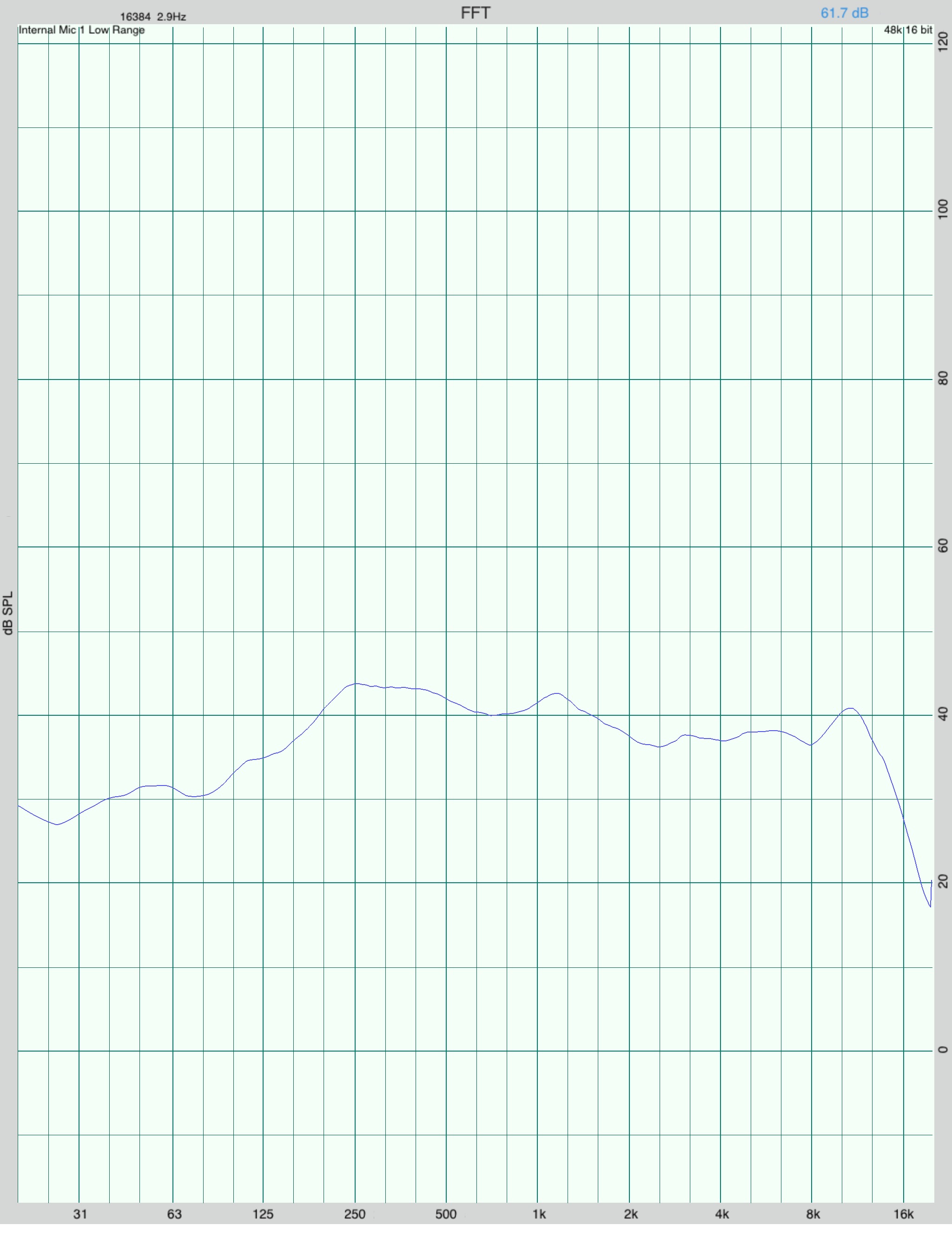

Panel Response
@DMLBES. So much for my memory. The big panels fall away from 250k down. Response below.
Just a couple of brief comments on the plot.
1. It’s an averaged FFT plot using white noise as an input.
2. There is a noisy PC in the room acting as a server which has a lot of low frequency noise which is why the drop in output appears to level off and flatline. The panels don’t suddenly level out at 60 Hz 15 dB lower than the rest of the spectrum, they keep going down.
Good luck with your experiment

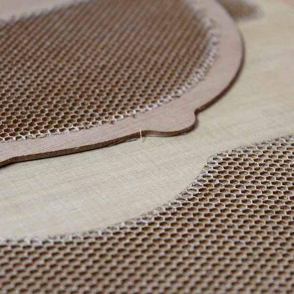

Don't know if you have seen this thread?
Carbon fiber + nomex honeycomb sandwich DML panel construction project
Good panel probably would be double top classical guitar board - nomex honeycomb sandwiched between two thin sheets of solid spruce or cedar. Doubletop guitars play louder...
nesha,
Very interesting, thanks for posting this. I didn't know anybody makes guitars like that, but it makes a lot of sense to me. I have already tried making a DML panel with nomex core and wood veneer skins. It seems promising, but not perfect. Definitely louder than plywood. But I did not feel very confident in my fabrication process. But a concept I'm planning to work more on. Maybe I can learn from the guitar makers!
