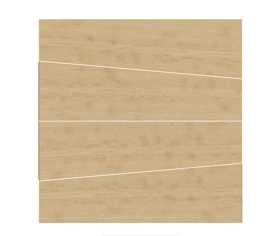

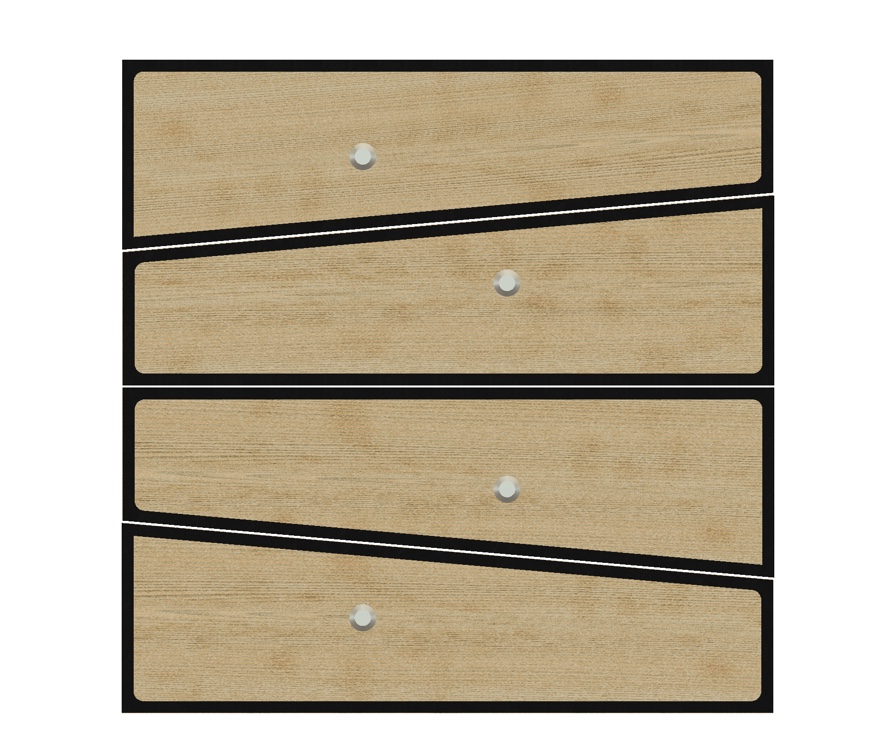

Theory Theory
So treat this as an experiment to test out something new. I make no claim for any superior performance but obviously I hope for something interesting and good.
Here are the factors influencing the design.
1. Long and thin ply panels, in this case 0.3 M by 1.2M by 3mm thick, seem to reach down to 30Hz
2. Long and thin also seems to provide better mode distribution - hat tip to Veleric for that one
3. Non-parallel sides may also provide benefits - hat tip to Spedge and it is claimed by Farad Azima in his 1997 patent
4. Edge treatment via absorbing elastomeric layer to absorb edges reflection and simulate an ideal infinite plate
5. Single exciter per panel appears to be preferable - validated by various sources
6. And finally, multiple panels to allow higher SPL at 30Hz without reaching exciter excursion limit.
Images below illustrate the array.
Normally I would build it first and then let you know what happened but I can’t build anything until the lock-in in France ends in a few weeks time.
Please throw rocks and suggestions as you see fit.

Is it 4 identical panels? Or 1 with 3 braces? Maybe place the exciters slightly differently from each other to excite different eigenmodes?
/Anton
@onni
It is 4 separate panels. I have tried with braces and without in the past and I remain agnostic on them. The reason I am using four panels here is to reduce the excursion of the exciter to levels seen at circa 100Hz so I do not anticipate needing them. For a halving of frequency you need 4X the area for an equal SPL so I am in the right ball park I think. I agree that the exciter position can be experimented with when I get a chance to build them
@Jamu - I agree you could easily try them in a 2 x 2 configuration.
Burnt

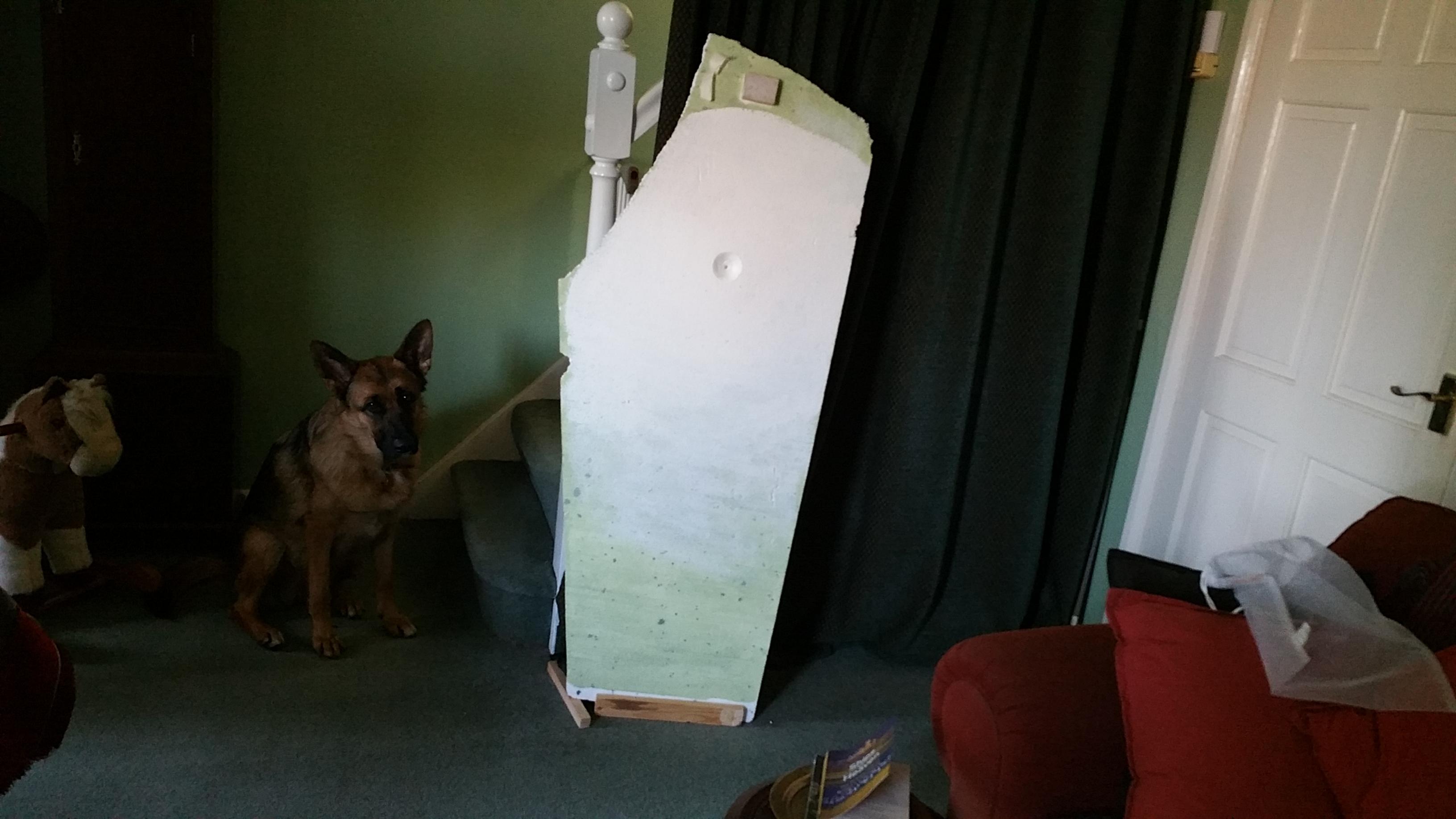

Old panel
Burntcoil.
This was a 6ft tall 1inch eps panel using the same shape as one of your panels,I clamped the panel between two pieces of wood in a vice at an angle ,shown by the wood at the bottom, this tilted the panEl to the side ,which looked better and also made for no parallel sides on the panel.
The panel was destroyed by the culprit sitting next to the panel ,this was what was left,it still sounds very good, which shows how flexible dml is.
The original idea was to have the thin part of the panel at the top and tapered at the top in the sloping side to prevent any paralleled sides,but having it wide at the top saved a lot of space and also when tilted gave me no parallel sides without cutting anything!!
I like win win situations.
