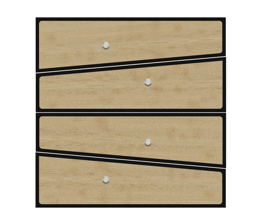

1. Long and thin ply panels, in this case 0.3 M by 1.2M by 3mm thick, seem to reach down to 30Hz
2. Long and thin also seems to provide better mode distribution - hat tip to Veleric for that one
3. Non-parallel sides may also provide benefits - hat tip to Spedge and it is claimed by Farad Azima in his 1997 patent
4. Edge treatment via absorbing elastomeric layer to absorb edges reflection and simulate an ideal infinite plate
5. Single exciter per panel appears to be preferable - validated by various sources
6. And finally, multiple panels to allow higher SPL at 30Hz without reaching exciter excursion limit.
Please throw rocks and suggestions as you see fit.

Thanks for the feedback Eric.
I am going to try a variation of the ABH method we discussed a few posts back. I am going to rout the edges to thin the section and fill that section with silicone filler. Thats the the thick black edge strip around each panel in the second image. It won't be a true ABH, I don't have a custom cutter, but I will get the cut as close as I can get. I will try one panel first and see how that works.
I will also see if the first panel needs additional damping and then replicate that if it works.
On exciters my comment was based on the long and ultimately circuitous journey taken on a couple of the other long threads by early experimenters. However, they were looking at well spaced exciters where you have your two very tightly packed together and thats another new arrangement I have not seen anywhere else. I can imagine that they are so close they act like one hybrid exciter so my comment doesn't really apply to what you do.
I am hoping/ assuming that the wide dispersion combined with the panels being in the same plane and very close together ( I am aiming for a gap no bigger than 5mm) that they act as one big panel. It will be interesting to see what happens.
Thanks again for the input.

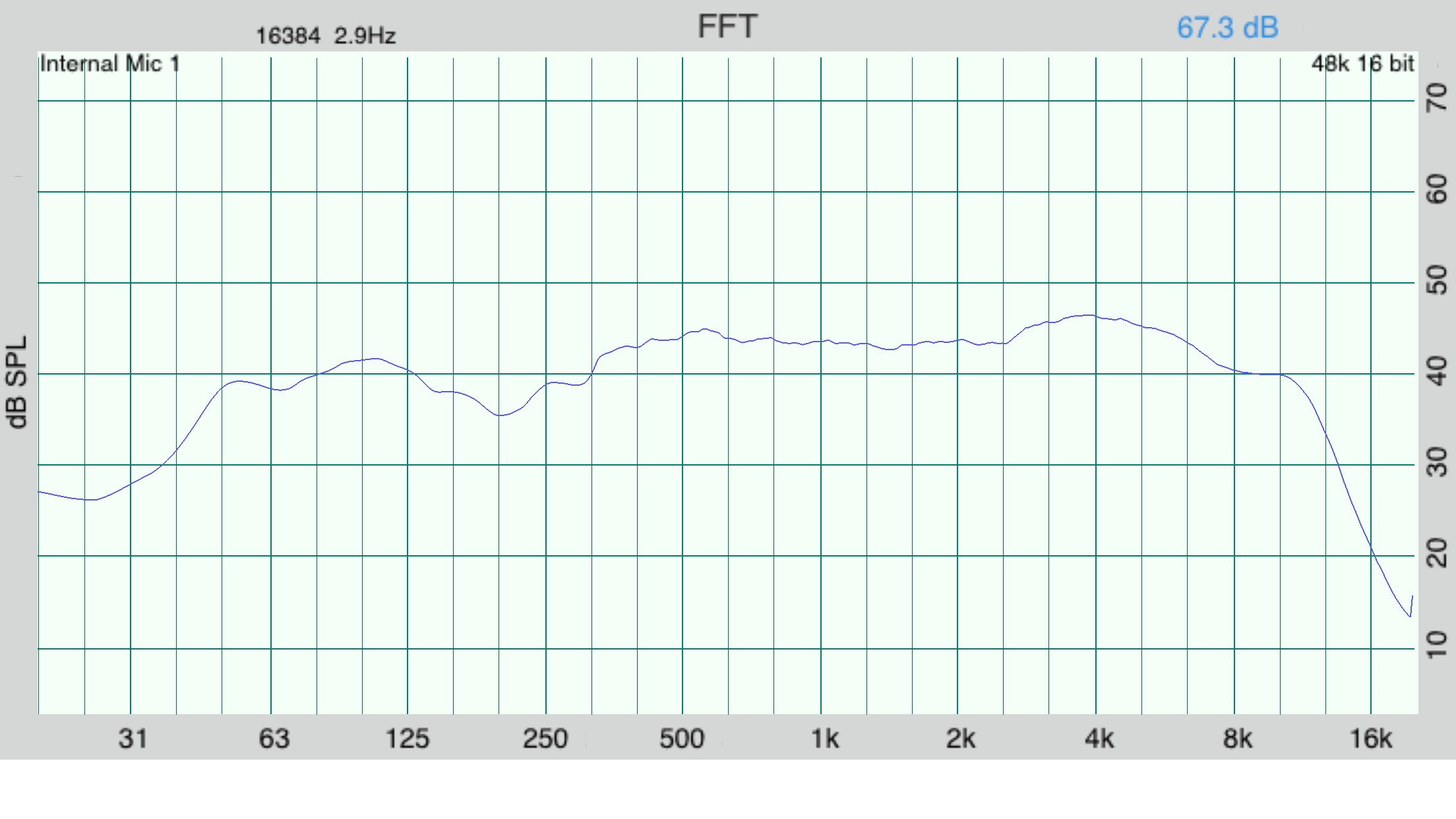

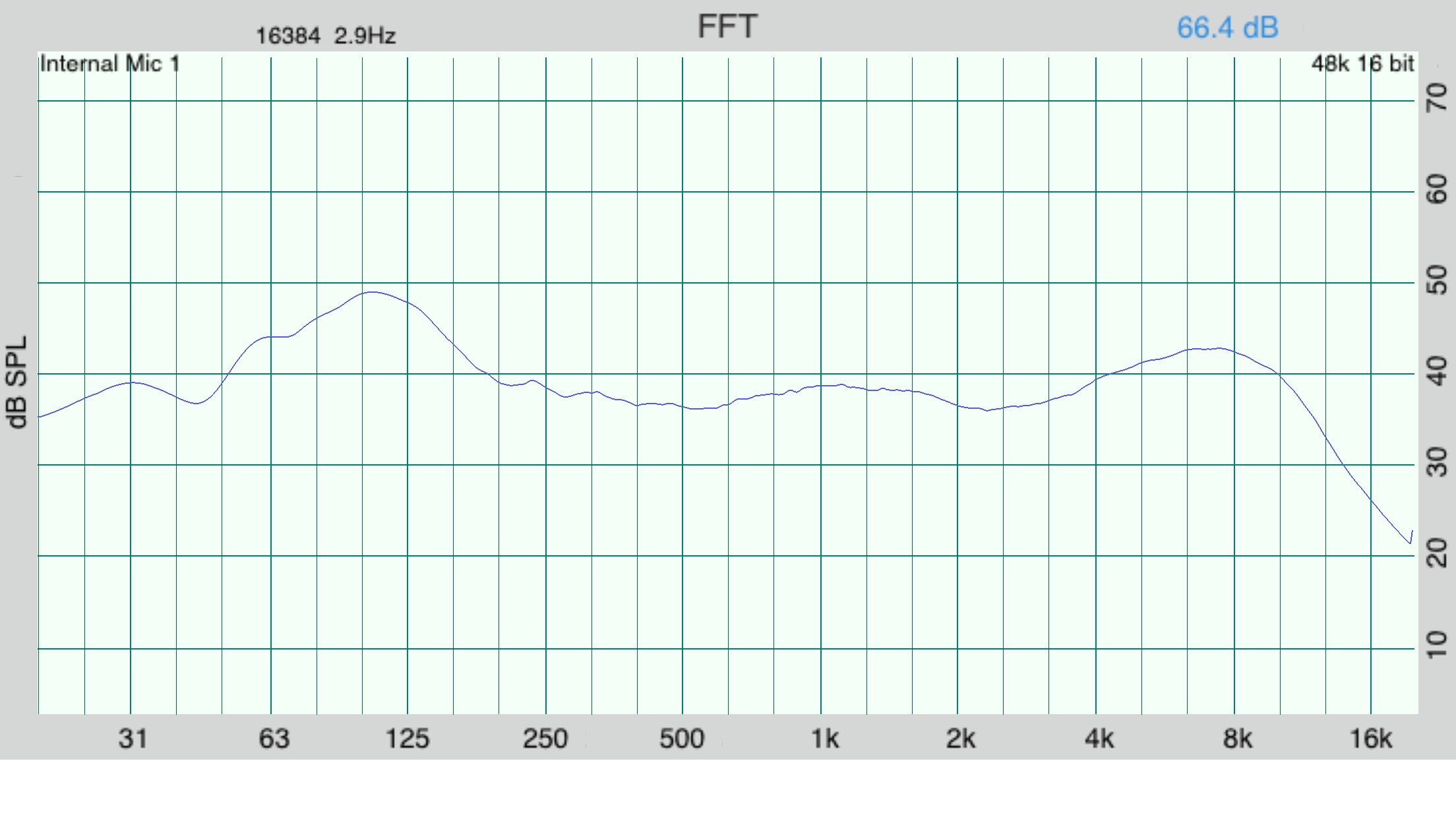

For Veleric
@Veleric.

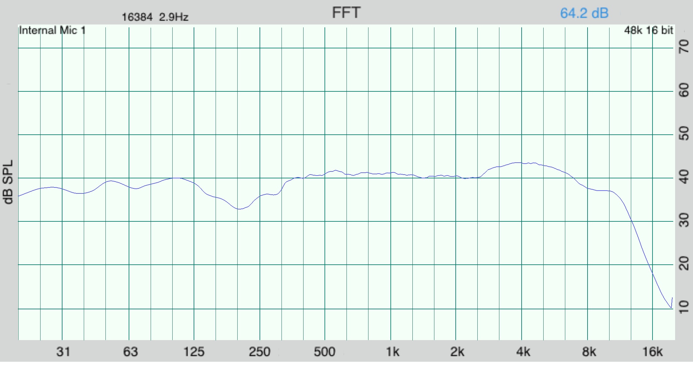

Sorry I forgot to post these yesterday as promised.
White noise tests in the same room with the same amp and source using the Audio Tools App.
1) B&W CM1 reference speakers. Bookshelf bass reflex design
2) Tall panels with no EQ
3) Tall panels with EQ
Burnt

@Spedge,
Much appreciated Steve- notable lack of rock so far.
On damping I think it's important to differentiate between damping the panel and providing edge damping. As I understand it damping at the edges creates a condition where reflections are reduced in amplitude or, preferably stopped completely. This emulates an 'infinite plate' condition which is believed to be ideal. It's in a lot of the research papers on DMLs. I am aiming for this effect, not panel damping. I hope that makes sense.
Burnt
Burntcoil.
It makes no sense to me at all,there is no difference between the edge of the panel and the panel,they are the same.
Hold the panel firmly by the edges as you are playing music,and move them around to different positions,the sound will change considerably.
Reflections are very important for dml, in paper's on dml I have never seen any mention of how damping or any other manipulation of the panel improves the sound ,only it gets rid of this spike or dip or gives a smooth looking response.
I have been down this road a long time ago ,yes you can extend the frequency and make the response look good,but at the end of the day they just sounded like any other normal speaker,all I'd manage to do was suck the life out of it!!!
On the other hand some like that smooth sounding cosy sound ,the shops are full of speakers like that,and have been for many years, especially in the UK.
I'd better also say that touching the edge of a light panel such as eps with just your two fingers will have a noticeable difference in sound.
If a panel sounds good to start with ,you are on to a winner.
Is boosting the LF by what looks like about 10db below 50hz a good idea?
Steve

"By examining the result of IACC and the SPL distribution in a well-damped surrounding, the property that DML is with diffuse sound field is confirmed"
This is what I wanted from DML, a wide soundfield that is resilient to room reflections. It's the primary comparative advantage DML has over cone speakers.
"In addition, the listening test unveils that after equalization the audiences may prefer DML to electro-dynamic loudspeaker, since the problem of lacking low and high frequencies has been fixed by equalization, which also give a possibility that one may improve the frequency response by the use of an equalizer."
Equalization was always inherent in my build strategy because I wanted a virtual CBT array which requires digital signal processing. As a result, I didn't face the same struggles others face when building their DMLs. I tuned with signal processing rather than physical adjustments.
"The simulations also pointed out the effect of the ratio of length/width to the modal density, saying that the length and width should never be the same for the sake of modal optimization and one may have the best ratio by simulation."
True, but that's because most research papers use a single homogeneous panel material, e.g. a sheet of aluminum. I use a plastic honeycomb panel with resin and threads of carbon fiber on one side while the opposite side is the cloth fiber without any modification. A panel's aspect ratio may not matter as much when you have a complex panel structure.
On the other hand, rigid foam is an inexpensive yet homogeneous material DIYers can use to make their DMLs. In which case they'd benefit from shaping their panel edges to create chaotic edge reflections (reduce standing waves.) Even if they want to create an overall square shape as in the attached image.
IMO, the primary reason to build a DML is to achieve a wide diffuse soundfield. These things are the opposite of a high directivity wave guide approach that tries to overcome room reflections by keeping the sound away from walls as long as possible.
Do you get really good intelligibility out of your DMLs in most of your room? Great, you accomplished the primary goal and enjoy a comparative advantage over traditional speakers. Now you can tune with physical materials and shaping then move on to DSP and equalization.
