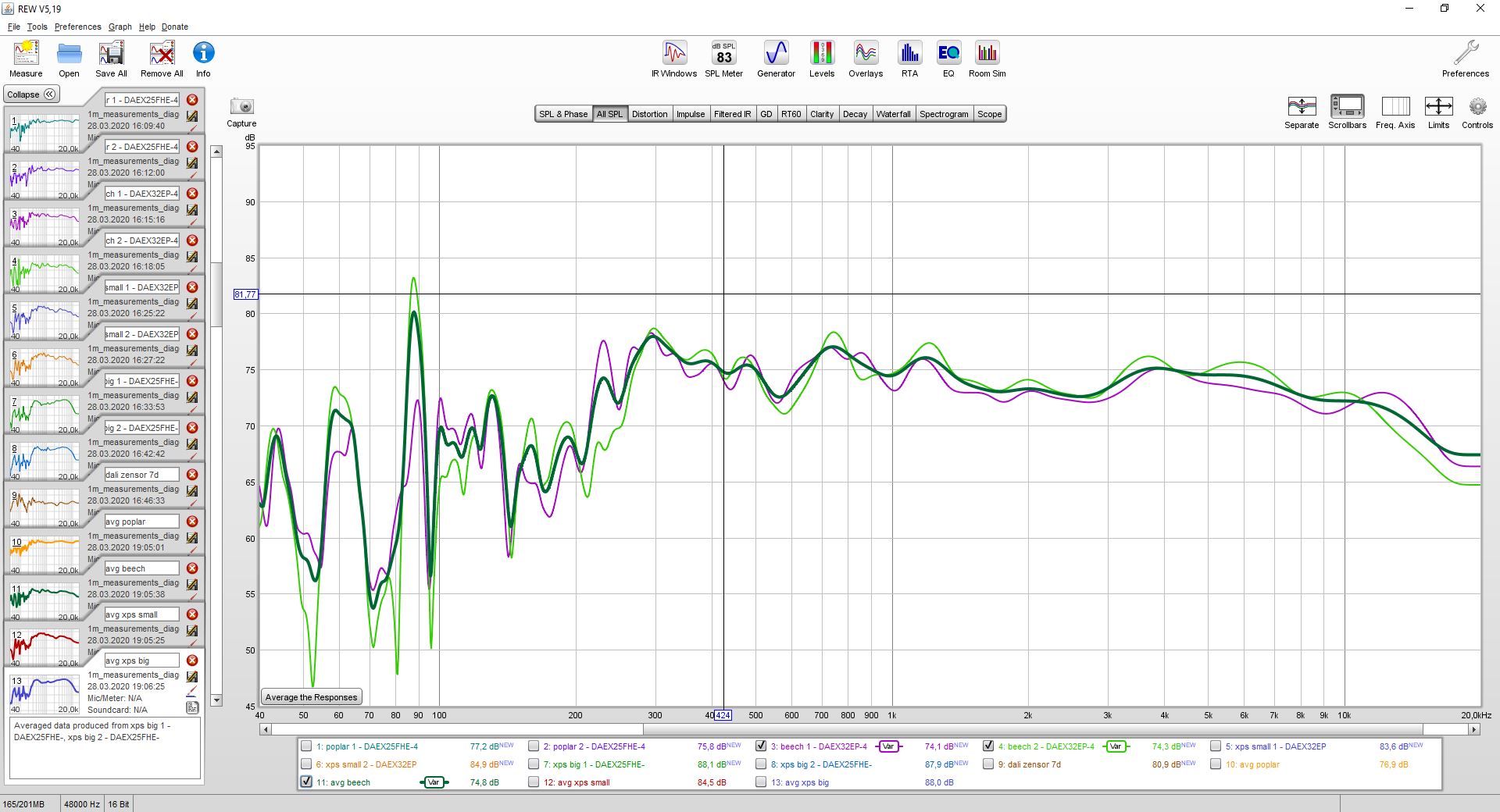

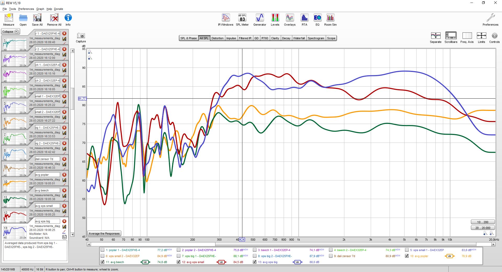

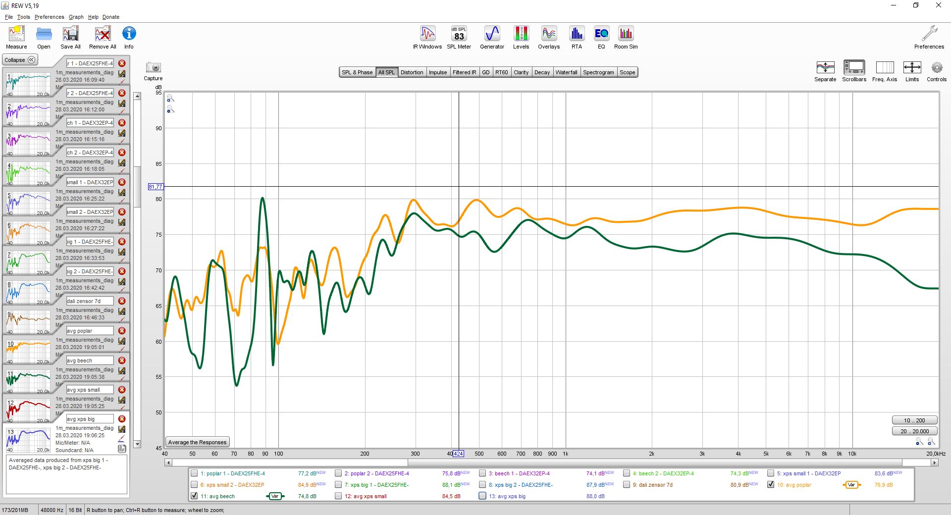

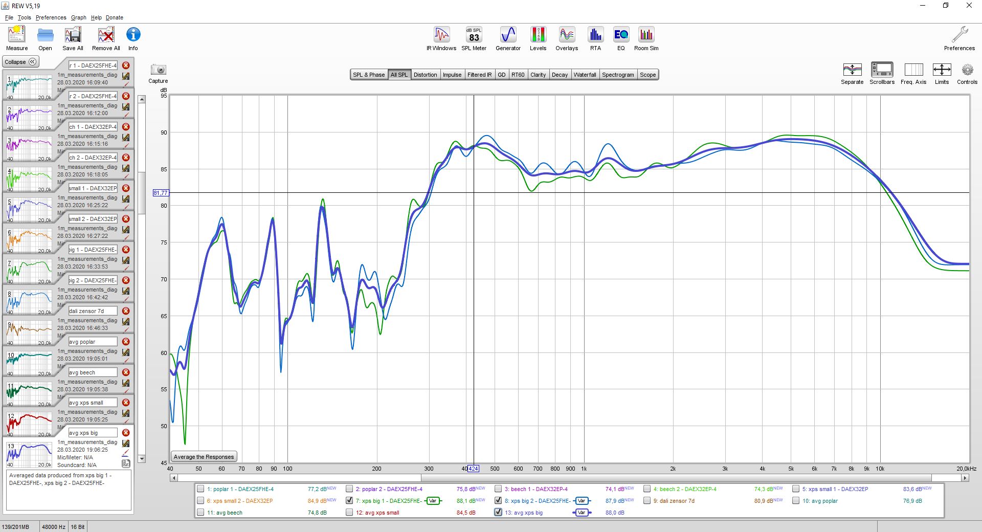

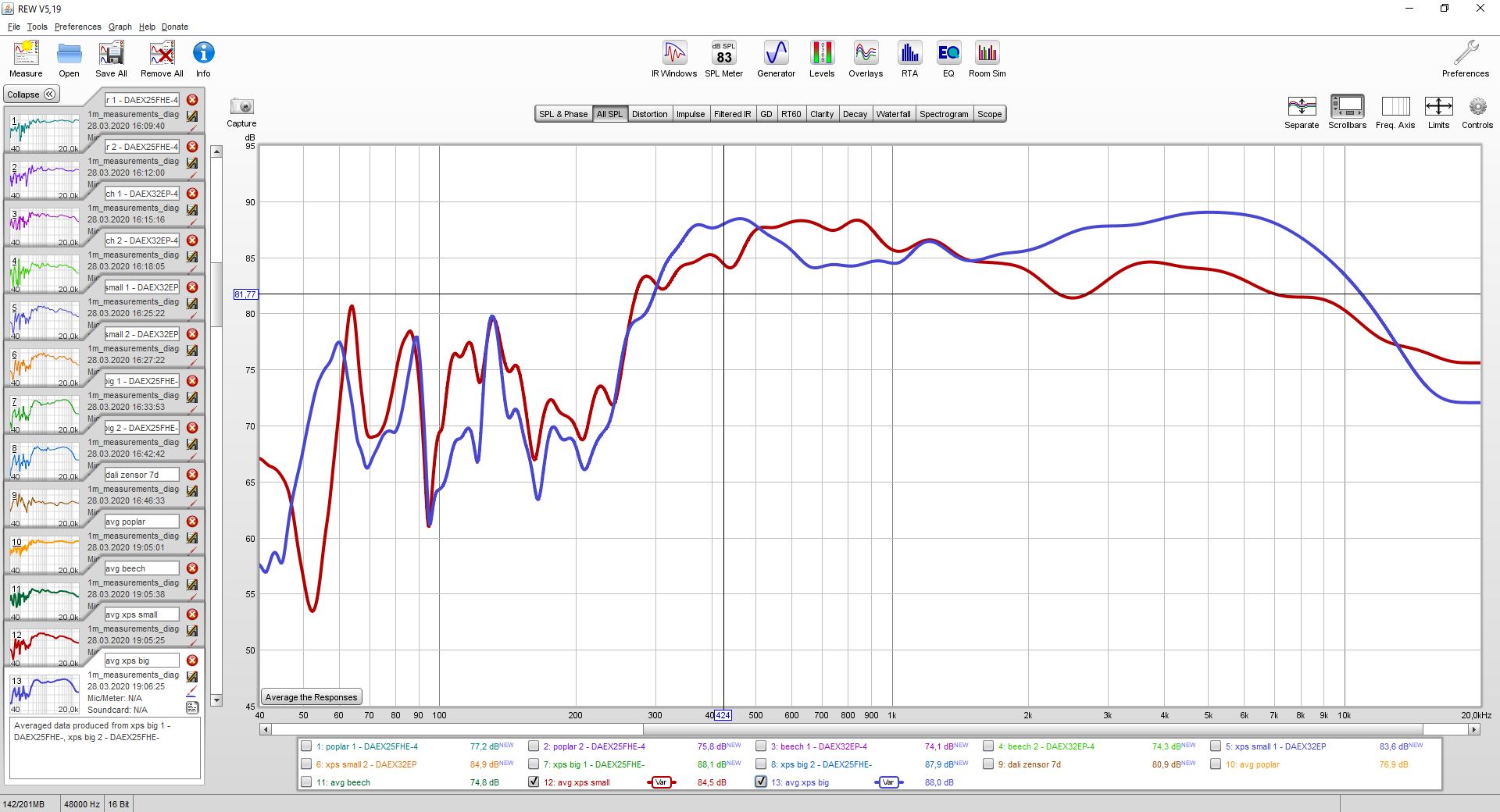

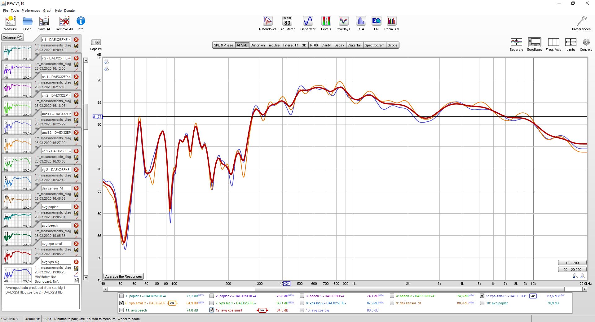

Today I took again some measurements of my different dml speakers, both left and right speaker as they differentiate quite substantially from each other. I measured at 1 meter distance and mic at panel center height.
Actually I took all measurements twice. First normal positioning and then diagonally in the room (which helps in my case against some resonances). I know already that my room does have some room modes, but as I cannot measure anything outside right now this is all I have.
The poplar and birch ply are 1200x600mm. The small XPS panel is 750x600mm and the big XPS is 1250x600mm. I also used different exciters as you can see in the plots.
How do you guys actually reuse an exciter/panel? Because it would have been much better of course if I would use the same exciters on all materials but I didn't want to risk to damage anything because all stores are closed right now... On plywood I can image that you can get the exciter off but on XPS I doubt that (without damaging the panel).
One thing that immediately jumped into my eye when I first measured my panels was, that I have a big jump at about 250Hz - on all materials/exciters. Below that it's pretty wild (to a certain degree also due to my room) and above quite ok. Compared to measurements from many other people that I've seen I don't have any problems with the high end, except from the big XPS panels. Overall I like the poplar the most as it provides the flattest response but it tends to rattle as it's quite soft.
Do you guys also have this wild peaks and troughs below 200Hz? I've tried different forms of frames, splines, panel attachements / dampening but still, I cannot really overcome that problem.
Yes. Everyone does. You're running into small room low frequency modal behavior. You can't solve for it by making adjustments to your DMLs.

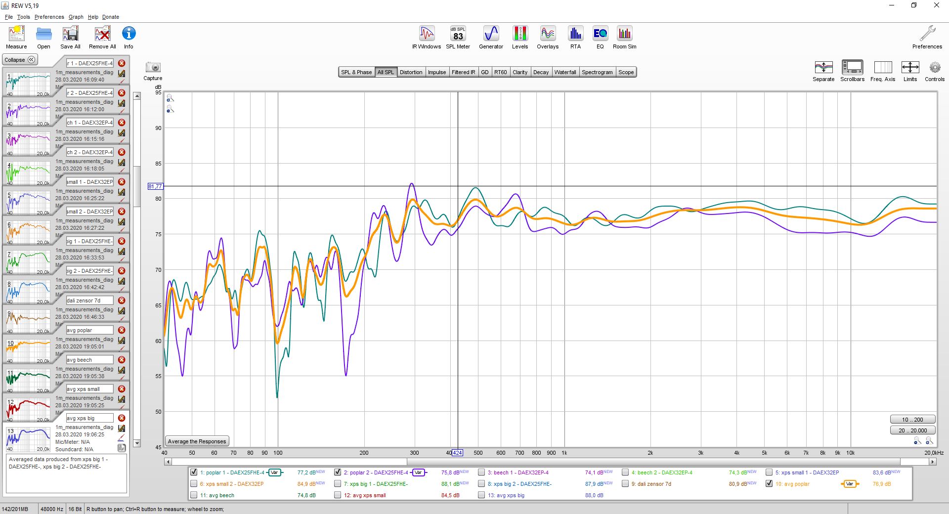

Urpgor,
I just realized that part of the reason your responses look odd to me is because you are using VAR (variable) smoothing, a smoothing mode that I never use. This type of smoothing applies less smoothing at low frequencies and more smoothing at high frequencies. This will naturally make the low freq end look bumpier than the high frequency end, regardless of whether it actually is or not.
According to the REW instructions, VAR should be used for "responses that are to be equalized". I can't say that makes sense to me.
I tend to use Psyhcoacoustic smoothing since it (at least supposedly) corresponds to what our ears/brains perceive.
I don't think there's really a right or wrong smoothing to choose. But I do think that using VAR smoothing is making it look like your response is wilder below 200 Hz and pretty flat above. But I bet it will look a lot less like that if you switch to a more consistent smoothing.

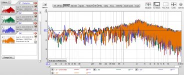

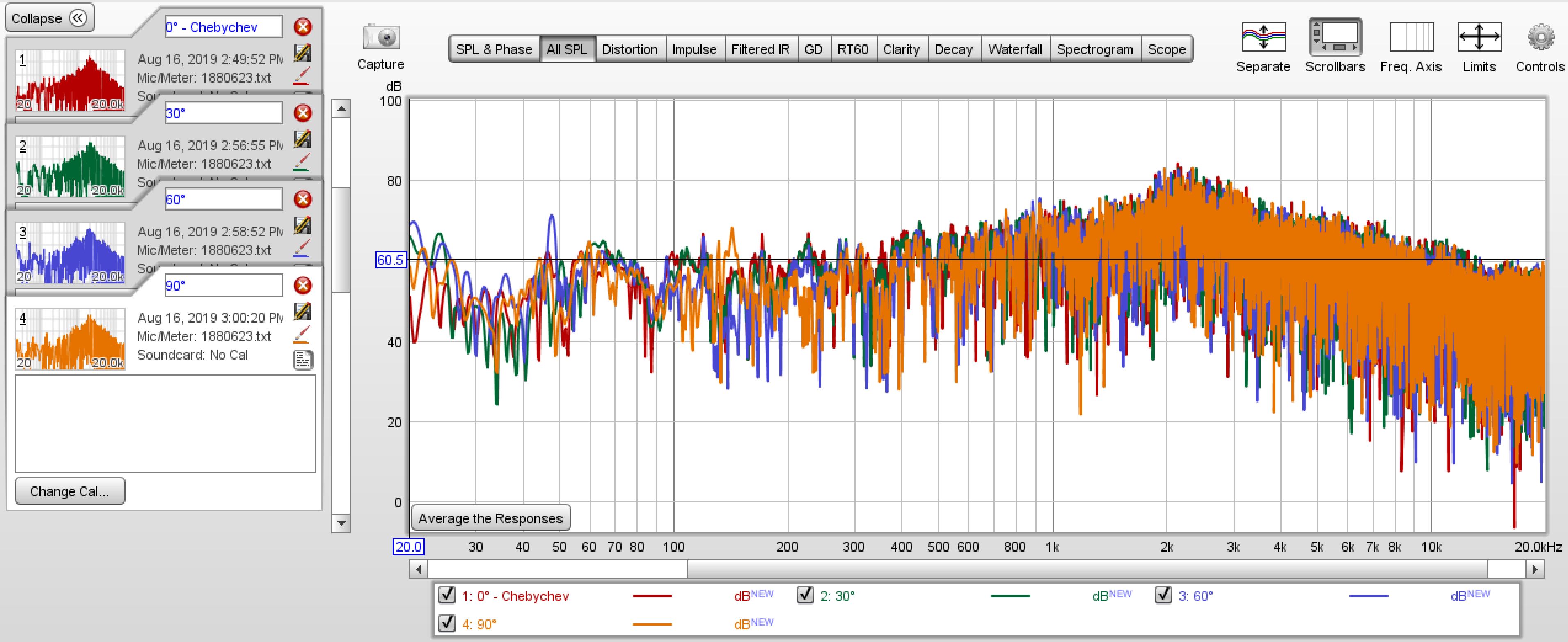

IMO, the comparative advantage DML offers is a wide diffuse soundfield in the higher frequencies. You get good intelligibility regardless of room reflections.
The patent said bending wave/infinite panel was the opposite of "a modal object." Instead, the bending waves go out like throwing a pebble into a very large lake. The reason they did it was to improve low frequency performance. But there's no comparative advantage in that over a traditional cone speaker. You get a design advantage because it is flat and you can hang it on a wall, but it doesn't sound any better than a cone in a small room.
To obtain the comparative advantage of a DML over a cone I'd want it to be modal. The more modal the better.
Another reason is that if you are pursuing the goal of improving low frequencies in a small room then you are probably going to use a small room low frequency room strategy. All those strategies separate the low frequency sources from the mains. Toole/Welti use four sub located in corners. Earl Geddes uses three or more in an uneven room placement. That's why you'd want your low frequency bending wave panels separated from your high frequency DML panels.
I accidentally built low frequency performance into my DMLs but it doesn't do me any good. All it does is excite uneven low frequency room modes. I have no way equalizing that from my mains.
You can see the modal high frequencies collapse in the graph as you move toward the lower frequency spectrum.

If you look at your response of the poplar and birch,you will see a dip around the 10k Mark and a peak around the 15k area,it's lower on the birch ,this is a classic response and shows the what I call the tin can effect.
The xps shows roll off in the 10k region ,so HF is damped by the panel material,similar to eps but more so.
Hopefully I will get in my room today to do some measurements on various panels to show this in more detail
