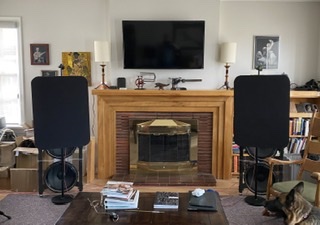

There is the old adage “ No speaker sounds better than one you made yourself”
In that light, others should try this and see if my impressions are true.

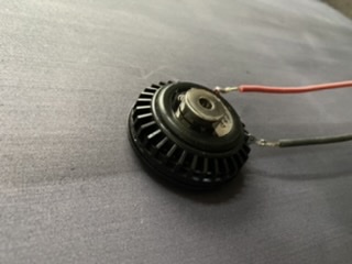

I stuck a 3/4 inch diameter N52 ring magnet on the back of my DAEx32ep-4 vibrators on my DML panels. My thought was to increase flux density of the driver without adding significant weight(or a second panel vibrator) I would thereby be hot rodding or souping up my DML vibrators.
I think I am hearing more mid and high end detail in familiar recordings... maybe my imagination...
I’d love it if someone else could try it and post their opinion

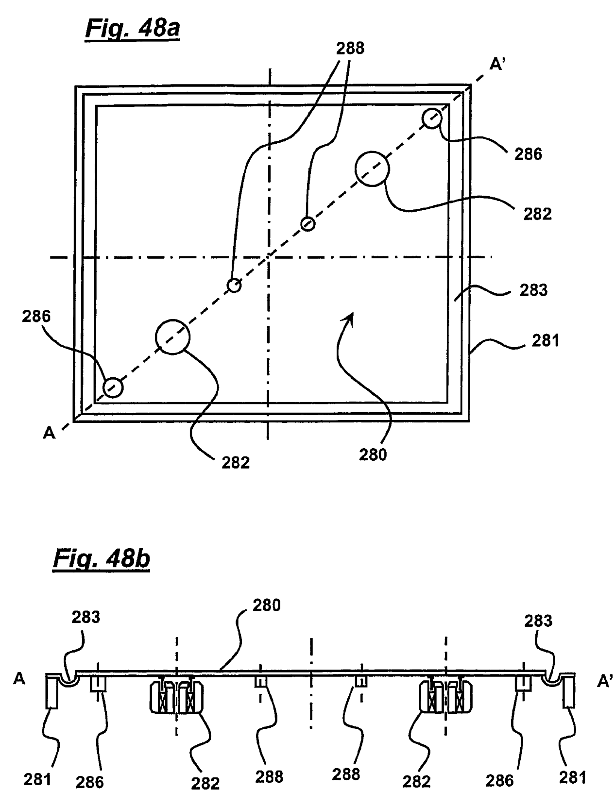

I want to draw your attention to Figure 48a in the patent.
FIGS. 48 a and 48 b show a loudspeaker comprising a diaphragm in the form of a rectangular panel 280 and two transducers 282 mounted thereto. The panel is made from skinned, cored lightweight composite material. Two pairs of masses 288, 286 are mounted at locations at 19% and 88% of the distance from the centre to one corner of the panel (i.e. over the half-diagonal of the panel). The voice coil of each transducer 282 is mounted at a location which is 55% away from the centre of the panel along the half-diagonal. The panel is mounted to a chassis 281 by a suspension 283 and sealed in a baffle (not shown).
The locations of the transducers and masses are calculated in a similar manner to the earlier embodiments. The mode shapes for the X-axis and Y-axis are considered separately and may be computed from the bending stiffness and the surface area mass of the panel. The average nodal positions are calculated from the minima in impedance. In the embodiment shown, the locations of the masses and transducers are average nodal positions for both axes when the first three modes for each are considered. There are additional effective locations along the diagonal if four modes are addressed. For a panel of 460 mm by 390 mm, the (x,y) locations of each of the masses and transducers are given as follows:
First (x, y) Second (x, y) Component location location 1.38 g masses  186 mm, 158 mm) (274 mm, 232 mm)  6.4 g masses (28 mm, 23 mm) (432 mm, 367 mm) Transducers (104 mm, 88 mm)  (356 mm, 302 mm)
The voice coils each have a mass of 4 g and the value of the masses is scaled to that of the voice coil as follows:
Half-diagonal relative Relative actual mass ratios ratios mass (gm) 0.88 1.35 1.35 6.40 0.55 1.00 1.00 4.00 0.19 0.35 0.35 1.38
The coil masses are not summed when obtaining the values for the balancing masses because each transducer relates only to the axis which it drives.

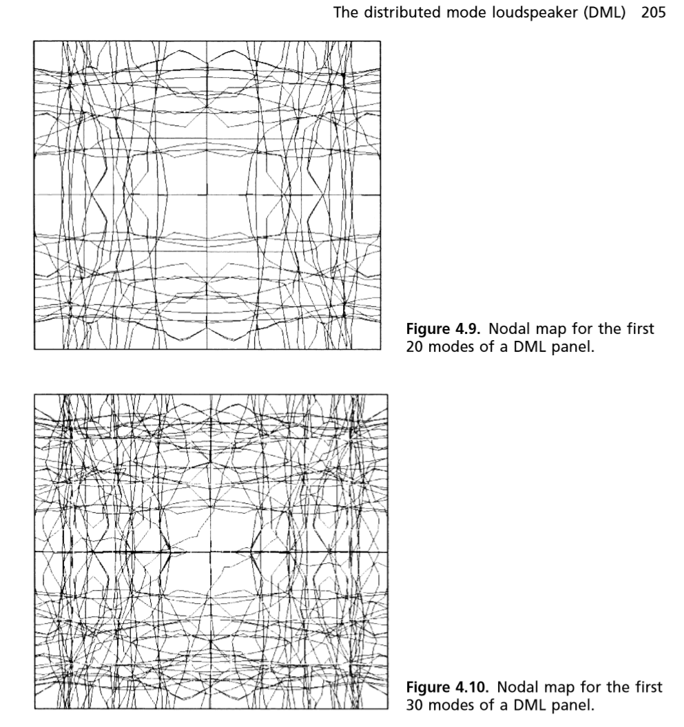

4.9 Drive points
For an infinite panel, the location of the drive point is meaningless, but not so for a finite panel. To give optimal results, the drive should be at a point that couples to all the panel modes, and while ensuring de-correlation between panel velocity and drive point.
There are a number of locations on the panel that achieve this objective, and these can be determined by a number of methods. FEA is one such approach, and the eigenvalues for a free panel can be determined, along with the related mode shapes. These mode shapes are converted in contours of nodal lines, where the displacements are a minimum. Regions of no nodal lines represent potential positions to drive the panel. It is usually only necessary to look at the first 20 or so sets of modes in the nodal map in order to find suitable candidates as drive points. These drive points are already known for complete sets of panel sizes and aspect ratios, but for optimal performance the ratios of panel length to width, as well as the most appropriate target values for B and are already known, as an integral part of the invention.
By way of example, an FEA model was constructed for a typical DML panel, and the model solved. By extracting the panel displacements associated with each mode, it is possible to generate composite maps for 20 modes (Fig. 4.9) and 30 modes (Fig. 4.10). Care should be taken with higher mode orders because of the accuracy of the FEA solvers at higher eigenfrequencies.

Wouldn’t the node map indicate that the exciter should be placed roughly in the center of the panel but not on the node line? That would place the exciter near the (1,1) mode but not on it? It seems most of us hobby types have been placing our exciters at a position using the so called 2/5, 3/5 measurements which places the exciter on top of the area of highest node line density(least movement). The 2/5, 3/5 placement seems counter to idea of placing vibrator at max vibrational area if nodes are where little move to occurs in the node map (chladni pattern) of a panel.
They don't place the exciter in the center because...
"To give optimal results, the drive should be at a point that couples to all the panel modes, and while ensuring de-correlation between panel velocity and drive point."
Decorrelating (decoupling) the initial impulse from the modes improves the soundfield.
The advantage of DML is a wide *diffuse* soundfield. You would probably get the wide soundfield if you placed the exciter in the center but you'd harm the diffuse soundfield.
A diffuse soundfield is an advantage because it tames undesirable room reflections. The result is better intelligibility, better imaging (stereo), and a wider sweet spot.
