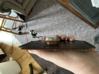

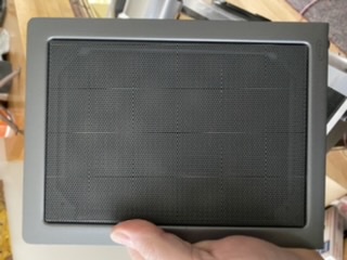

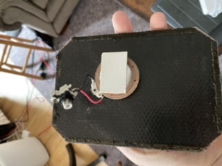

Here you go. Real NXT panel. Light duty exciter typical placement Nomex panel. Small weight on listening side for modal adjustment. Terrible sound.

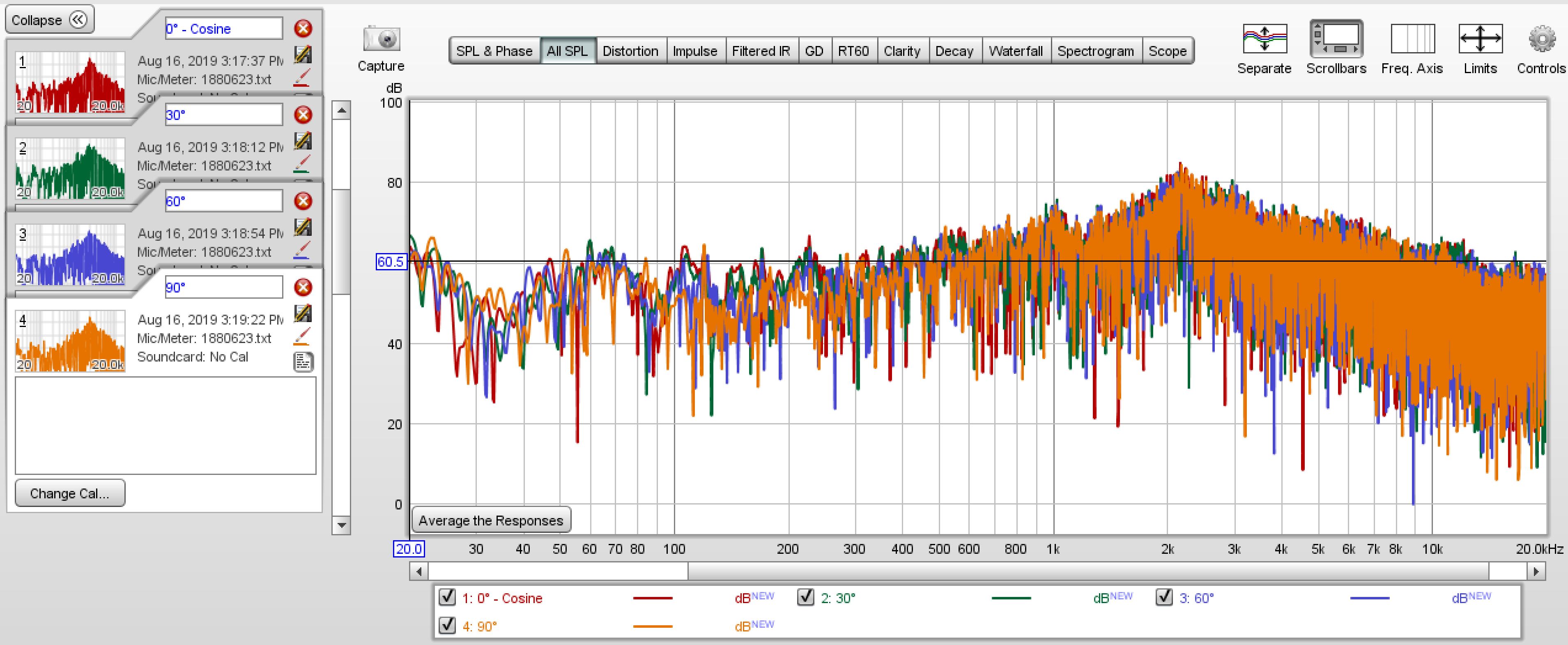

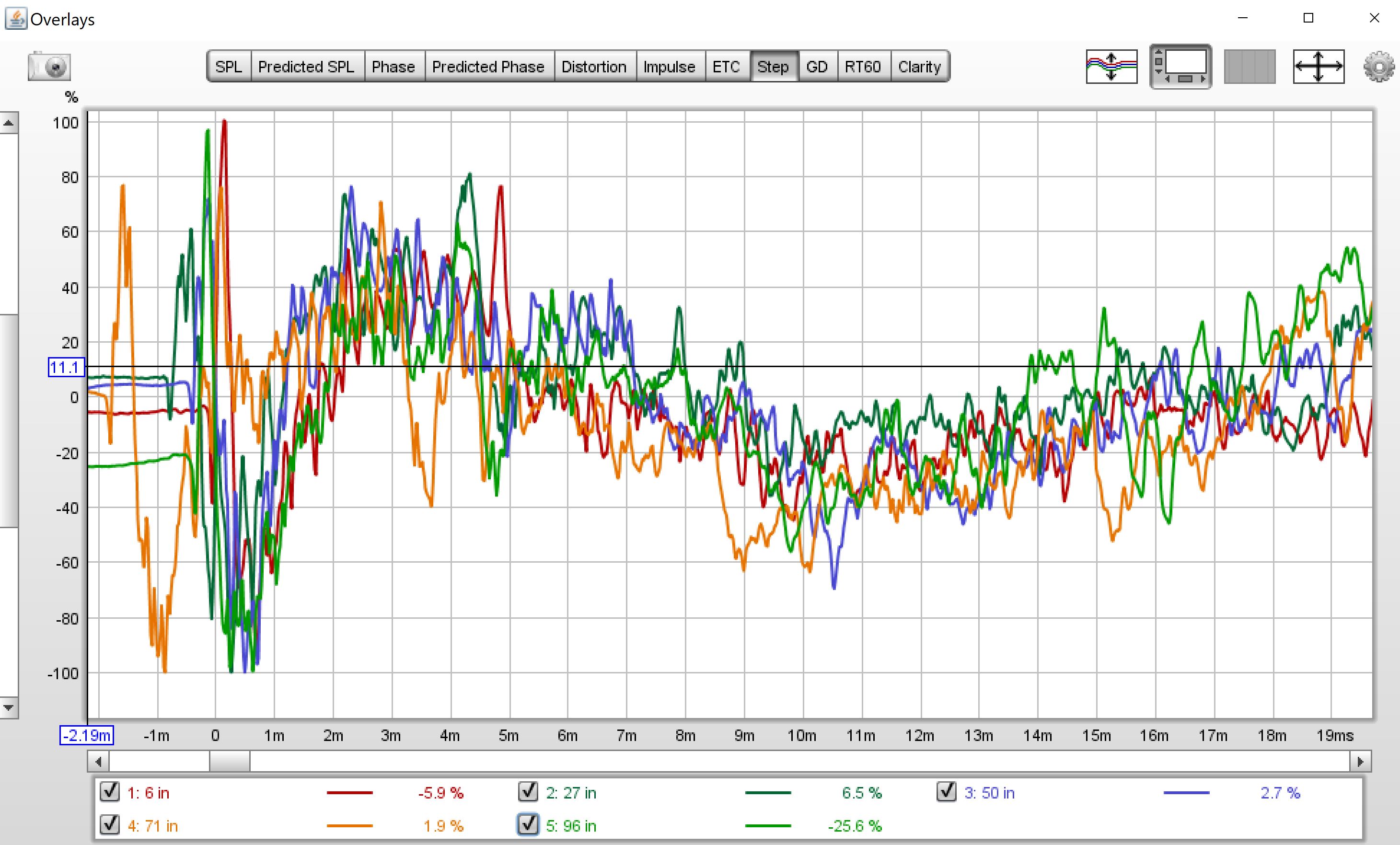

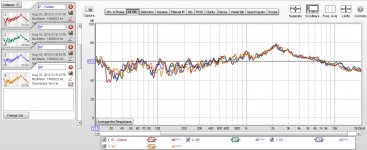

I should have placed the raw and smoothed REW measurements together. I also have an impulse graph.
These aren't useful for designing panels because my panels aren't good examples. It's just to present the concept that typical REW frequency response and impulse graphs aren't what you'd want out of a DML.
If you had a flat frequency response like a typical cone speaker you'd wind up with a strong correlation between your speaker and your first reflections. Typical cone speakers also want a flat tail on their impulse graph.
I don't know what good quality raw DML REW graphs are supposed to look like. NXT does, but I don't. However, we can at least listen for high intelligibility above Schroeder. You won't have any control below Schroeder so you can't beat yourself up over that (or run in circles trying to fix something you can't fix.)
If you guys have a microphone, get the free REW software and collect much easier to read spectrum data vs little screens on your rack mount equipment. It’s better than nothing but would be nice to see vertical axis in 5dB major ticks and frequency labeled from 20Hz to 20kHz in log scale.
I can’t really make out the units on either axis here. Maybe -45dB to -50dB vertical and horizontal starts around 150Hz and goes up to?

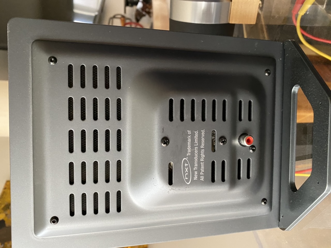

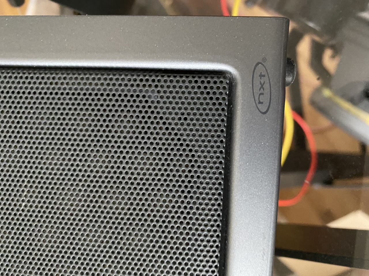

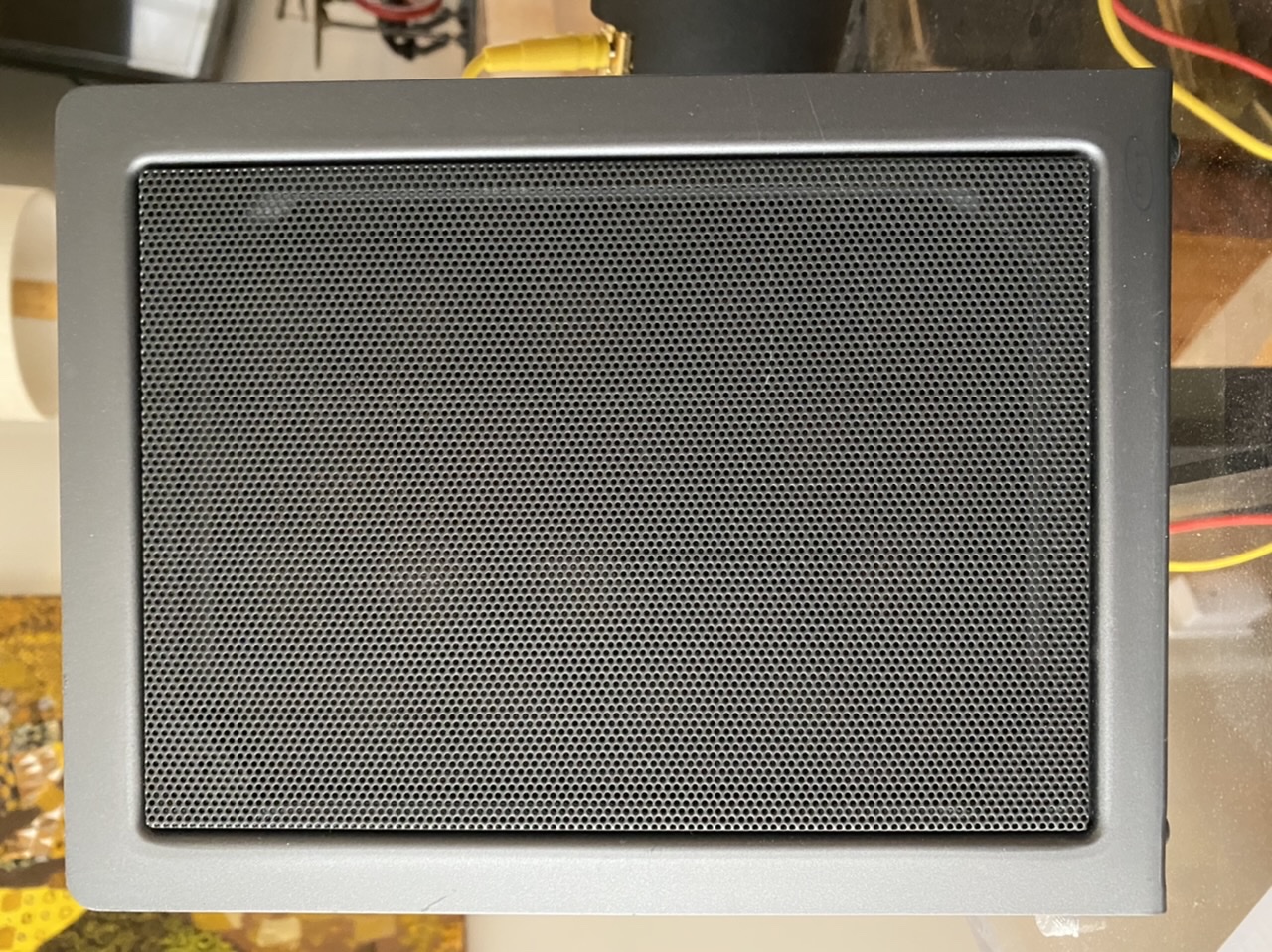

Here is detailed pic of a authentic NXT made panel. Historical value only for sure. Lots of these on EBay
