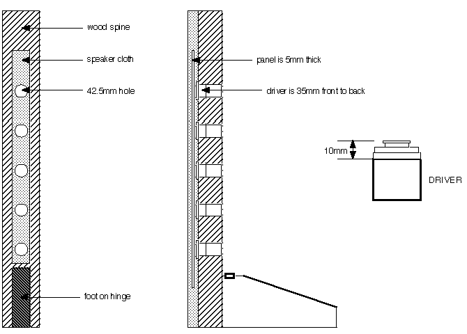

I don’t know for certain but judging by the pictures in the article the Podium panel looks about 4/5 mm.
I think this is close
Aramid Honeycomb Core - 3.2mm cell - 4mm thick
Burnt
How thick do you estimate the honeycomb in the podiums are?
Also, I seem to be able to source kevlar honeycomb locally but i cant find Nomex, is there a difference?
In the article it says 5mm

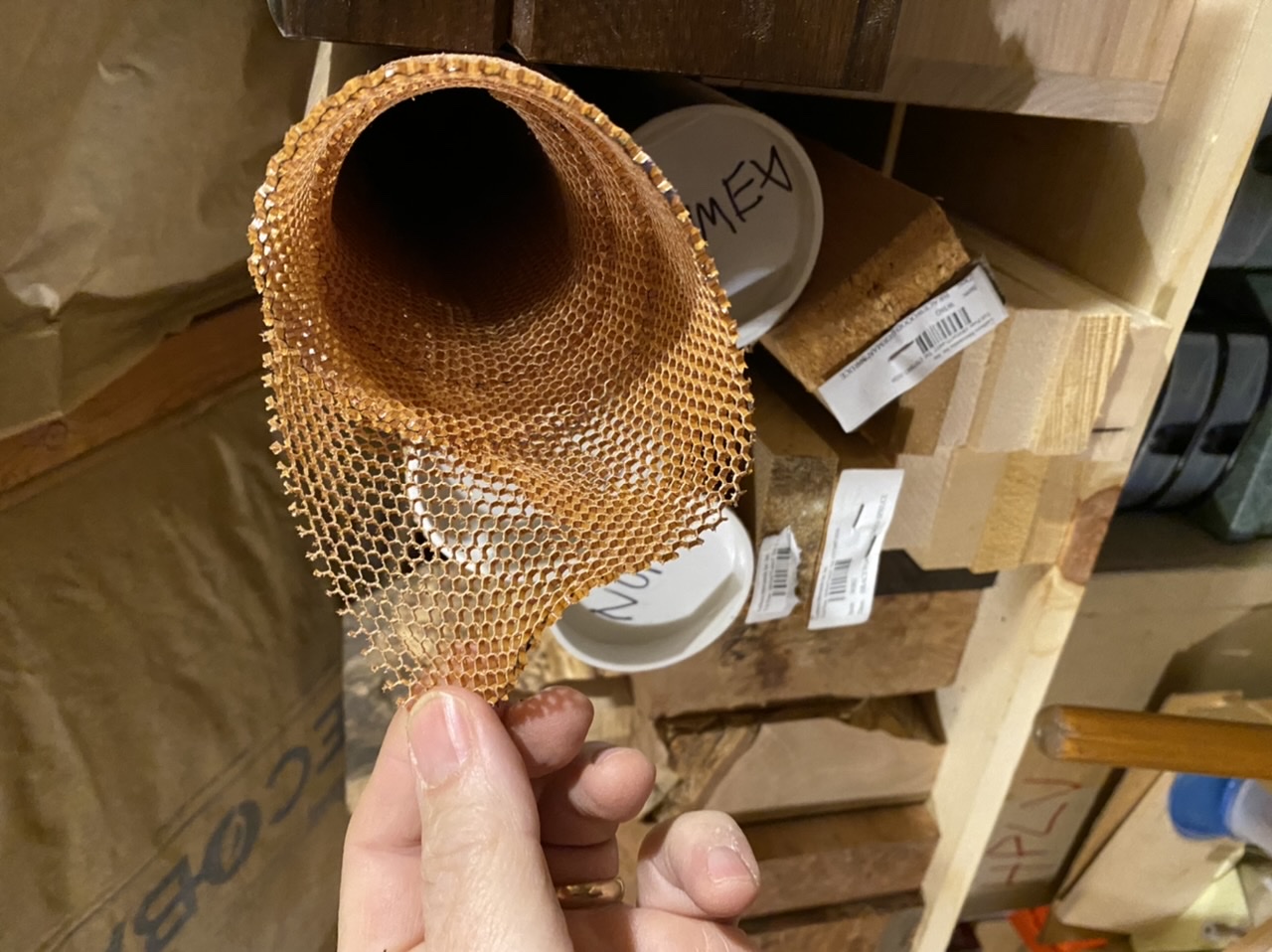

NOMEX is made of a material called aramid. There are many other honeycomb materials made of carbon fiber, aluminum. NOMEX is made by DuPont. I believe that aramid is to some degree fire proof. There are many sources of premade Nomex core composite panels. Most of them are, in my opinion, too heavy for use in a acoustic panel.

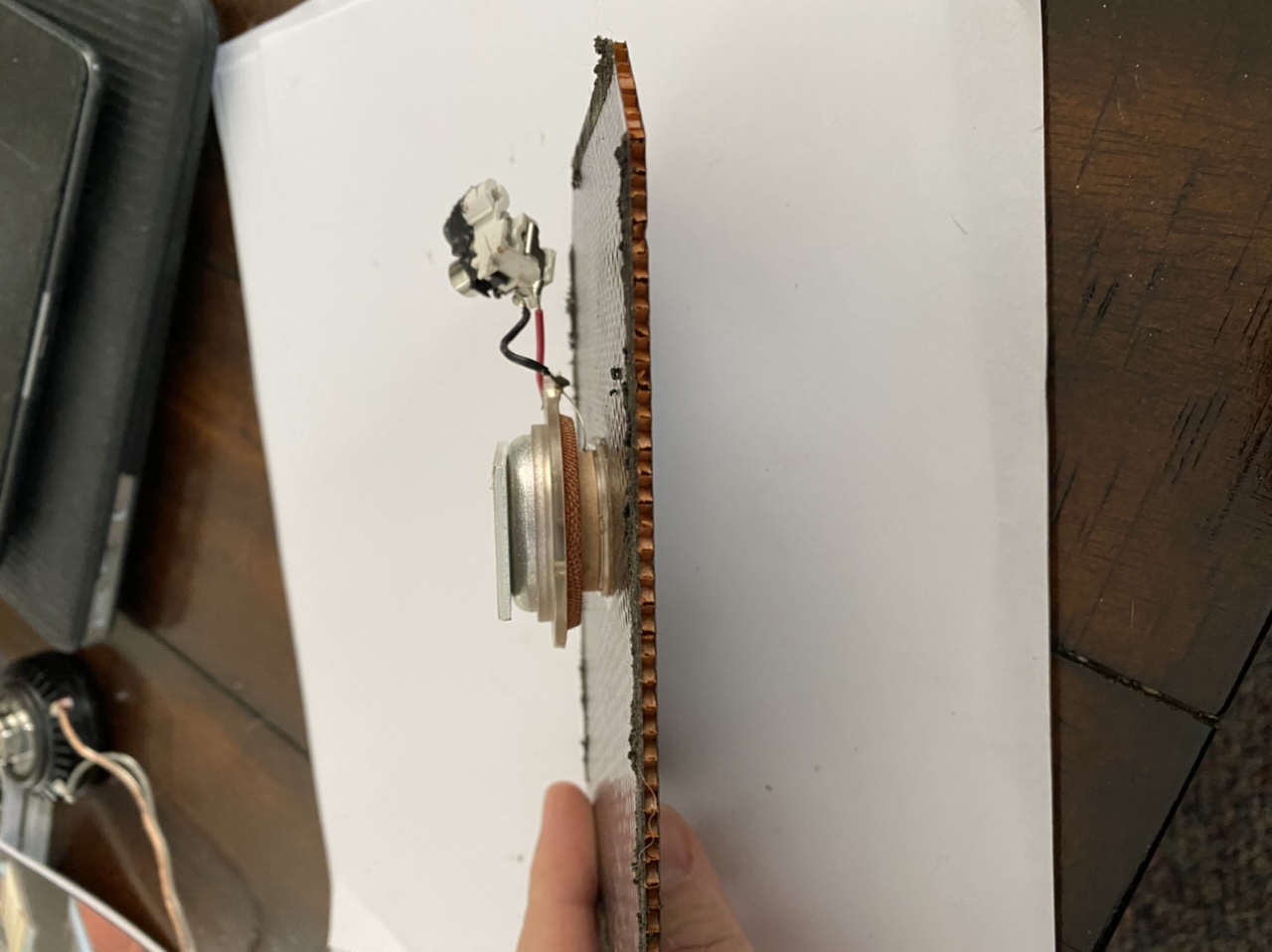

In my understanding the goal is an very light ( low density ) panel that has high stiffness compared to its density. That is why FOAMULAR 150 works well. To me it makes little sense to take a Nomex core and put two layers of high density Woven carbon fiber on the core. To my reasoning a composite with Nomex should have a very light weight skin such as wood veneer or mylar(thanks Burnt).
This is my opinion based on my experience with NOMEX soundboards. I am not an engineer. So, follow my advise at your own peril. The photos are of a roll of NOMEX and how NXT used it in and exceedingly lightweight panel.
KEVLAR honeycomb is very heavy(dense) compared to aramid honeycomb or NOMEX

Thanks for the clarifications, I managed to find aramid honeycomb locally although they don't specifically call it nomex.
