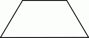

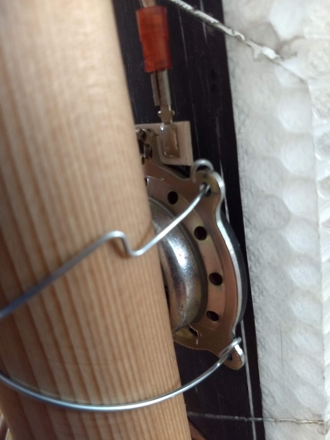

I modified my plastic honeycomb polyester skin panels to see what would happen.
1) one side resin other side original polyester fabric
2) both sides resin
3) Number 2 plus exciter side cut with hacksaw between exciters to form alternating trapezoid shaped surfaces for each exciter - simple angled cuts with the hacksaw. (see image)
4) Number 3 plus holes punched into resin side opposite exciters (see image)
They all sounded bad without DSP equalization. Number 2-4 required more high frequency reduction at a large bandwidth than the Number 1.
My subjective perception was number 1 and 4 sounded the best. I'm thinking that a single modal radiating surface is better than two. Which might be a reason to ditch foam.
I'm going to build a new set. I'll use the same plastic honeycomb polyester skinned material. I'm going to use carbon fiber on the active side. I will probably cut the active side like Number 3. I will not punch holes in the polyester fabric side. Which is too bad because the polyester is ugly and difficult to dye.
Honestly, I don't know if I'm imagining things or not between one hard modal surface vs two. I'd describe the difference in sound as "closed" with two surfaces and "open" with one surface. It's such a subjective observation that I'm embarrassed to say it. I notice it most clearly on piano solo music. The single surface sounds more like a real piano.

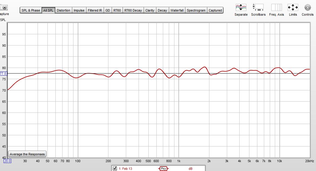

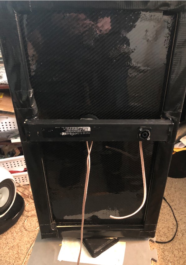

I settled on 2’ high by 1’ wide CF/cardboard panels and a pair of cone driver subwoofer speakers (for below 120Hz). I used DSP for EQ and crossover.
I glued (spray adhesive) CF fabric to heavy-duty two-ply cardboard. Then applied a two-part epoxy coating on the CF. The panel was mounted between two picture frames supported by foam tape around all four edges (both sides of the panel). I used a PUI 20watt exciter mounted slightly off center on the CF side and attached to a spline. The amplifiers I'm using are 25w class A current drive.
The sound is very dynamic and detailed. Since I only have one layer of CF I'm wondering what the sound difference would be to add a second CF layer to sandwich the cardboard?
Thanks, Dave

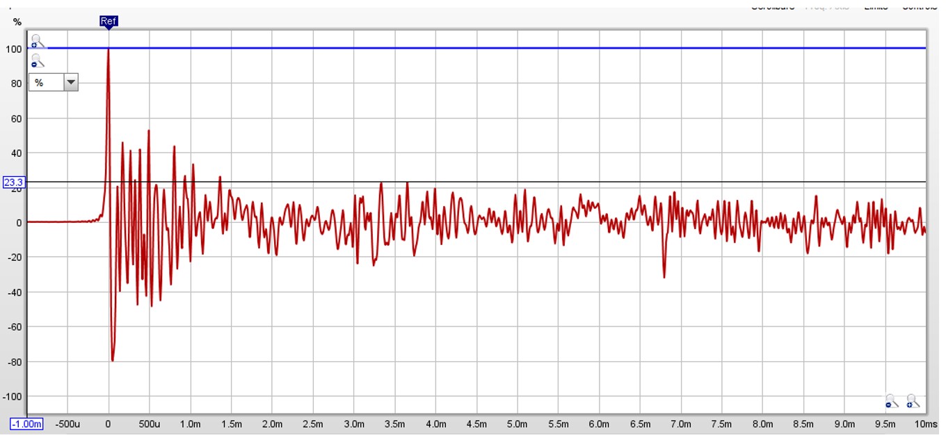

Is that response the raw, unequalised panel?

This is valuable. You proved you can get a flat frequency response from the upper range of human hearing all the way down to Schroeder with a 1x2 panel.
Does your frequency response remain flat as you rotate the speaker off-axis? Do you get good intelligibility (human voices spoken at frequencies above Schroeder - female voices or children) as you walk around the room?
I need to take measurements off-axis. It does respond very well to EQ (I use a MiniDSP HD). I do try focus on the quality of female singers and it's very good. That's kind of what I meant by detail, along with separation of instruments and stereo image. The dispersion appears to be very wide, My room is rather small (9'x10'). I need to move it into the family room and try (assuming my wife let's me).
Thanks, Dave

I don't know if I could bring myself to put my CF on cardboard, but your results look great! How thick is your heavy duty two ply cardboard? Is this corrugated cardboard you are talking about? Any pics of the cardboard itself?
I'd be interested to see the frequency response without the sub and dsp.
As far as adding more carbon, my guess would be that it wouldn't do much if any good. Probably just make it too stiff and push the resonant frequencies higher, making it cut out at something higher than the 140 Hz you already have. How heavy/thick is your carbon? Is it 3K, 6K or other?
Eric
Eric
Eric, I will try to take measurements without sub and DSP. The CF is 3K and the corrugated cardboard is about 1/4" thick (presentation board from Staples). Thanks for the feedback regarding adding CF.
Dave

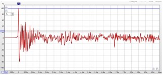

Dave

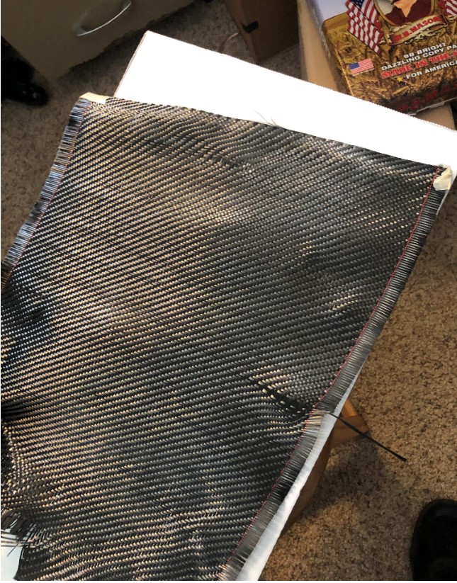

Thank you. I see why you made the panel 12 inches wide now. It's the width of your fabric, it looks like.
I recently made a small 8" x 12" prototype with 3K fabric over 1/16" balsa. I like it and plan to make some larger ones with the same or similar construction.
Eric
