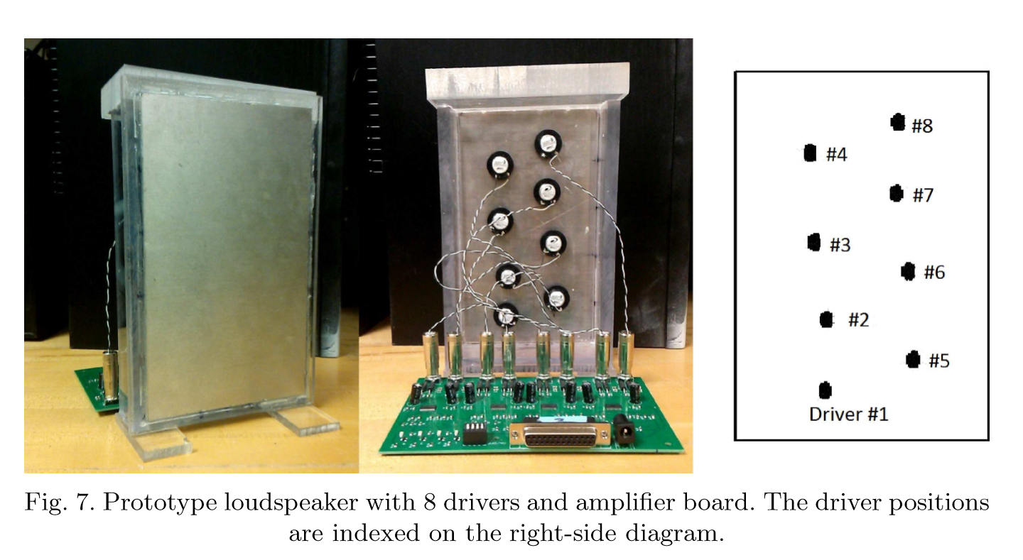

The good thing about the center is that it's easy to locate. The linked paper has a more complicated method. My intuition is that if you use DSP you're safe in the center. I also suspect non-parallel sides helps but researches prefer materials and shapes that are easier to sell in a commercial market. Maybe a guitar or piano influenced panel is best but it would be hard to sell because it would look goofy.
Optimized Driver Placement for Array-Driven Flat-Panel Loudspeakers | ANDERSON | Archives of Acoustics
