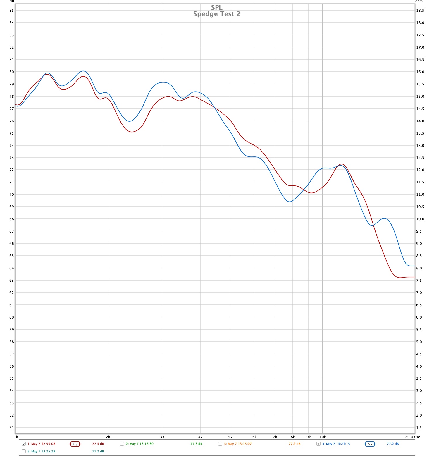

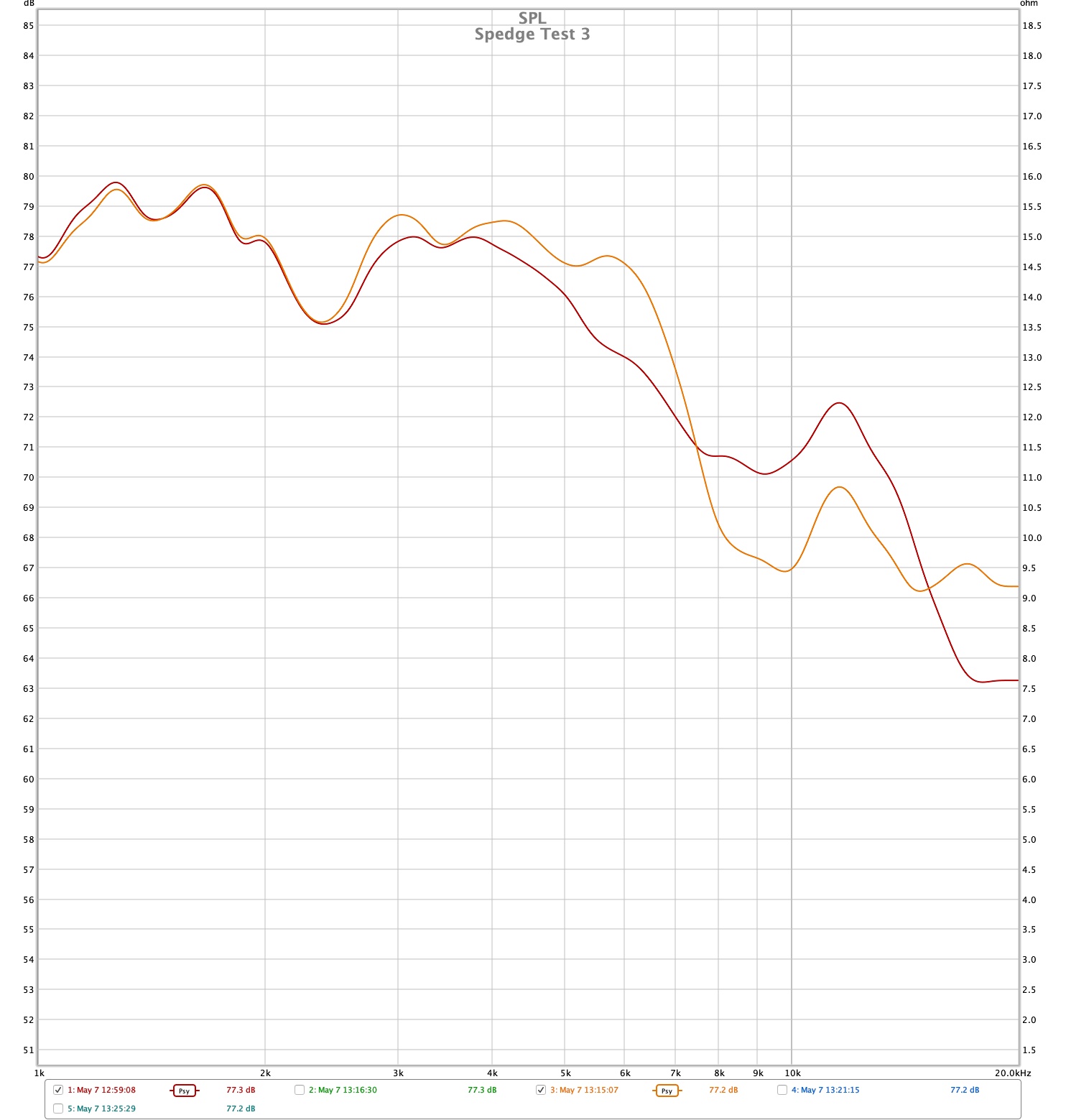

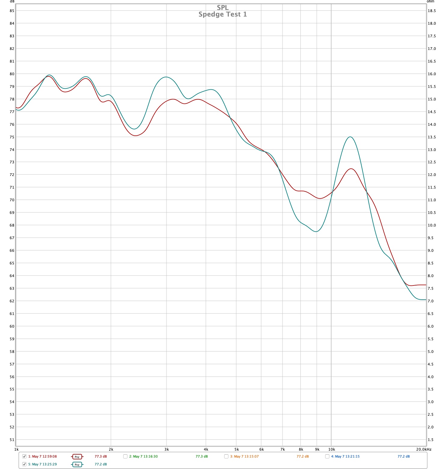

@Spedge
I thought you might like to see the measurements I took. Please note I have expanded the vertical axis to show 1dB steps so although the LF to HF slope looks alarming its only 10dB.
The red line is the 'natural' panel response
The paper strip was attached using sellotape and the different measurements are different positions relative to the exciters.
Cheers, Burnt

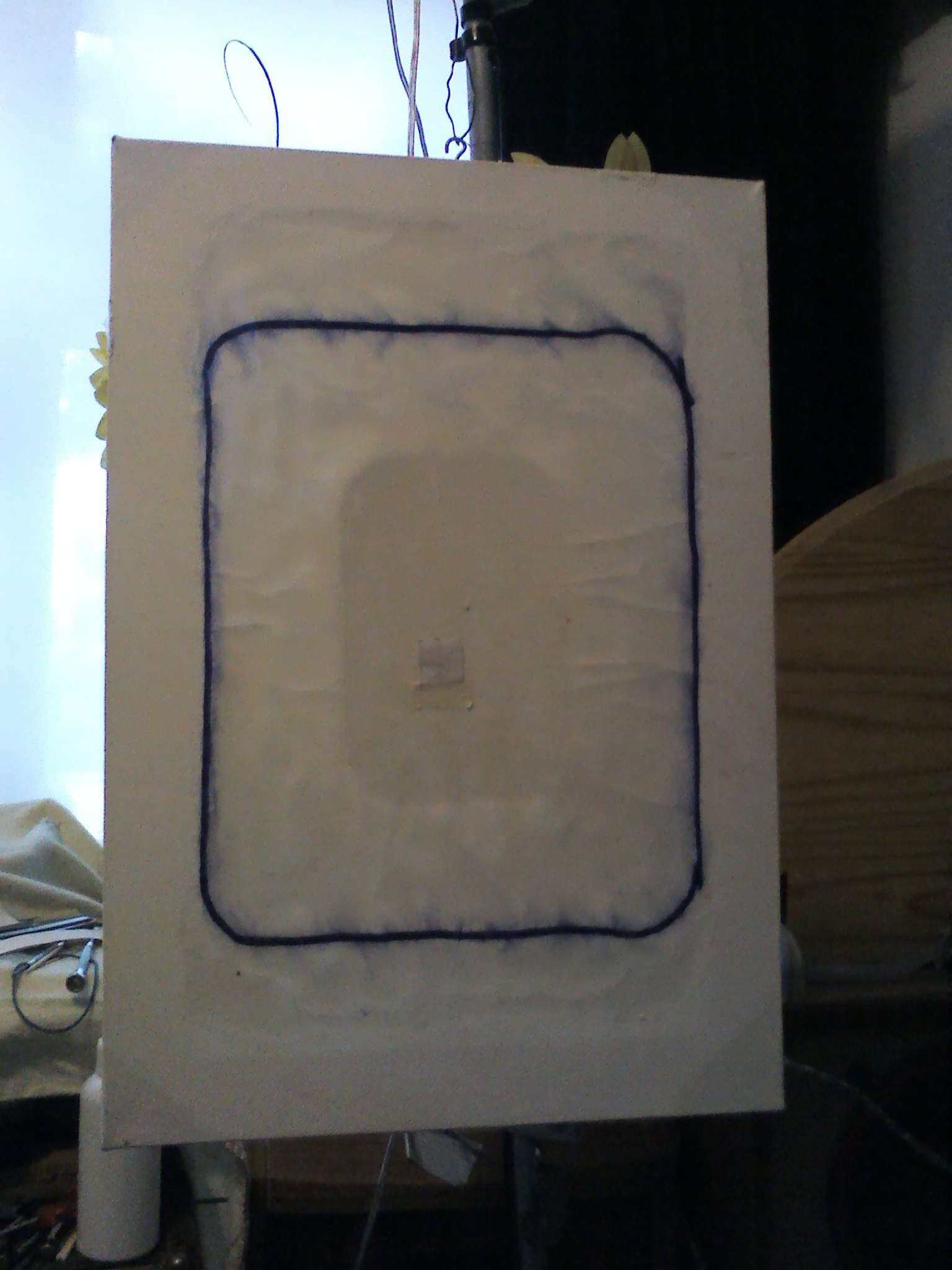

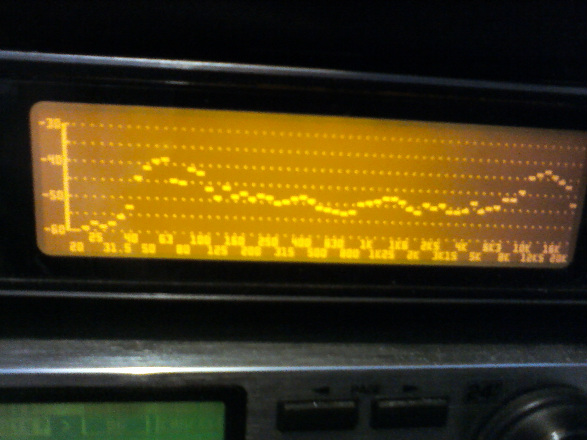

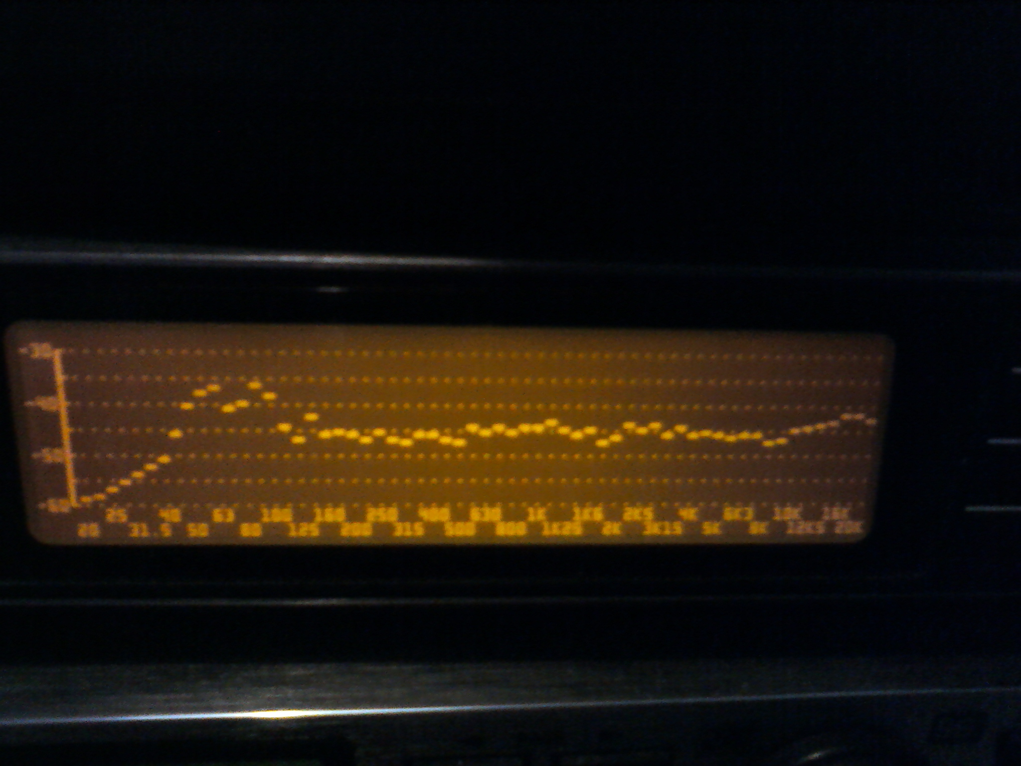

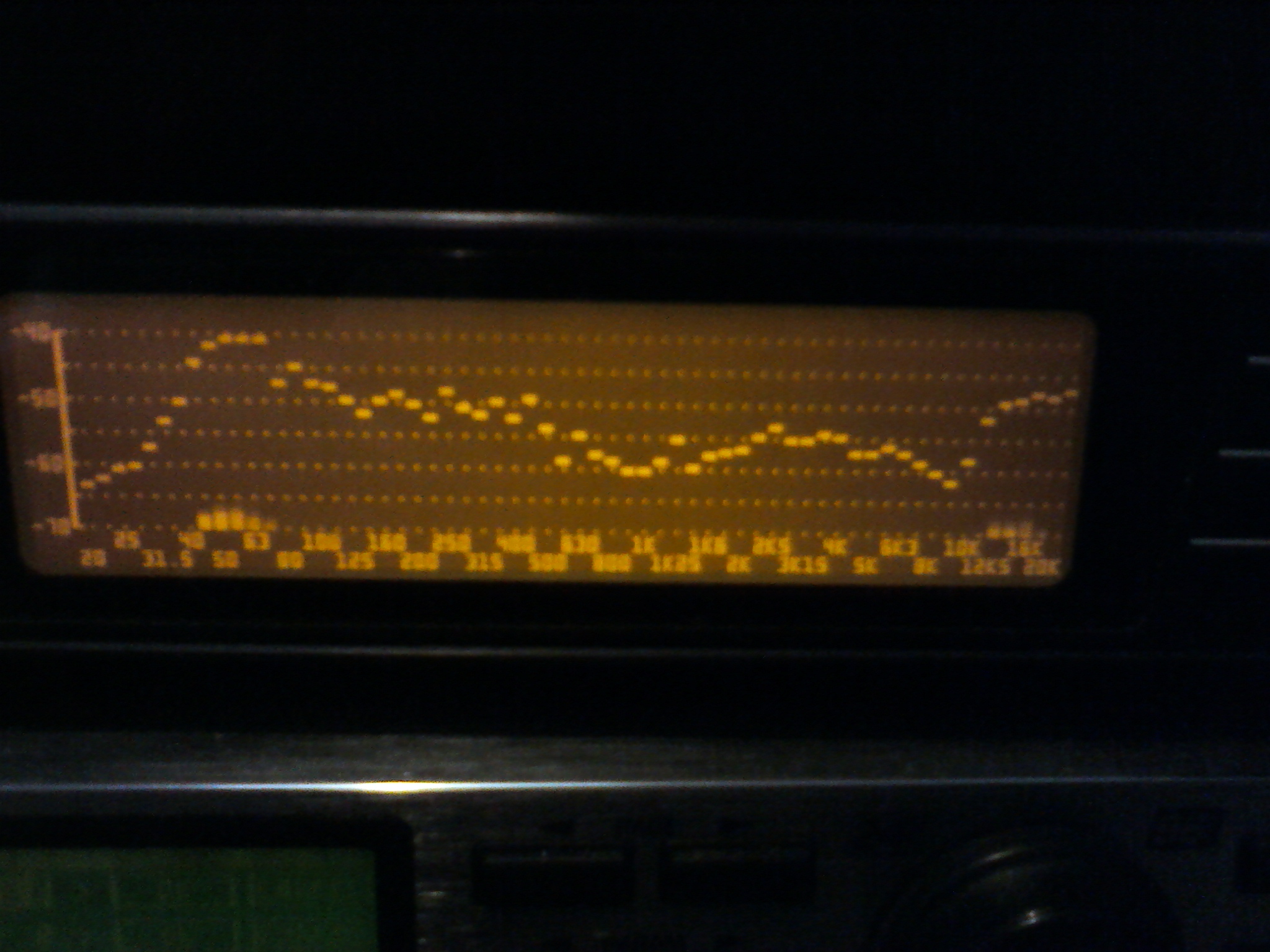

Burntcoil.

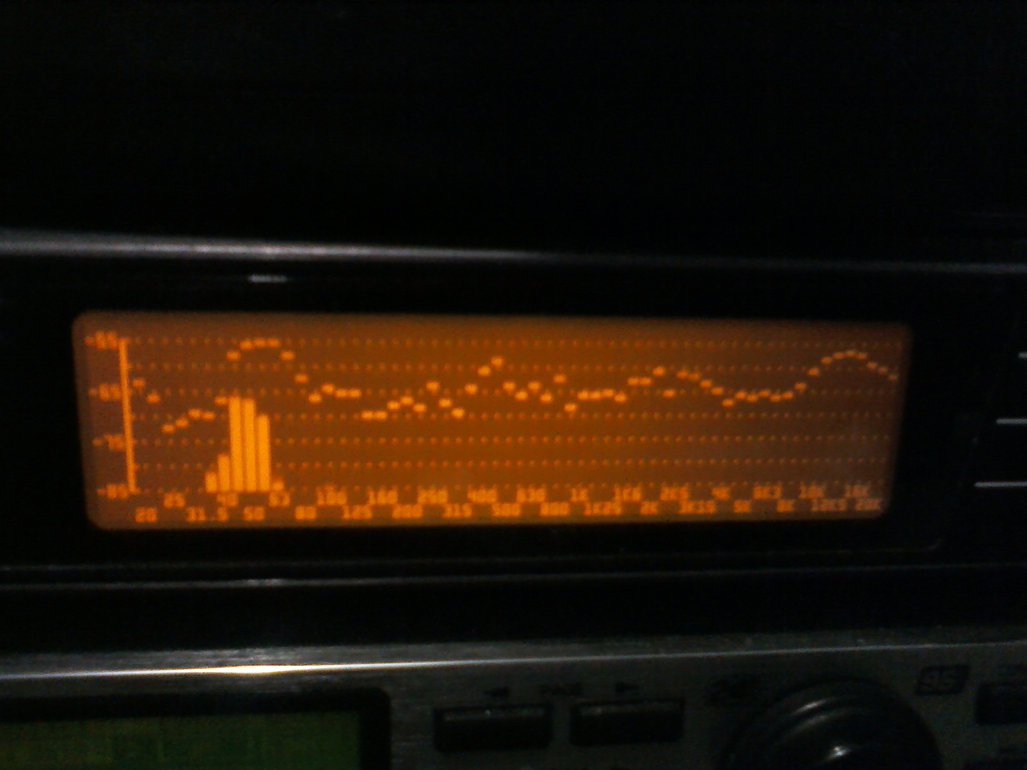

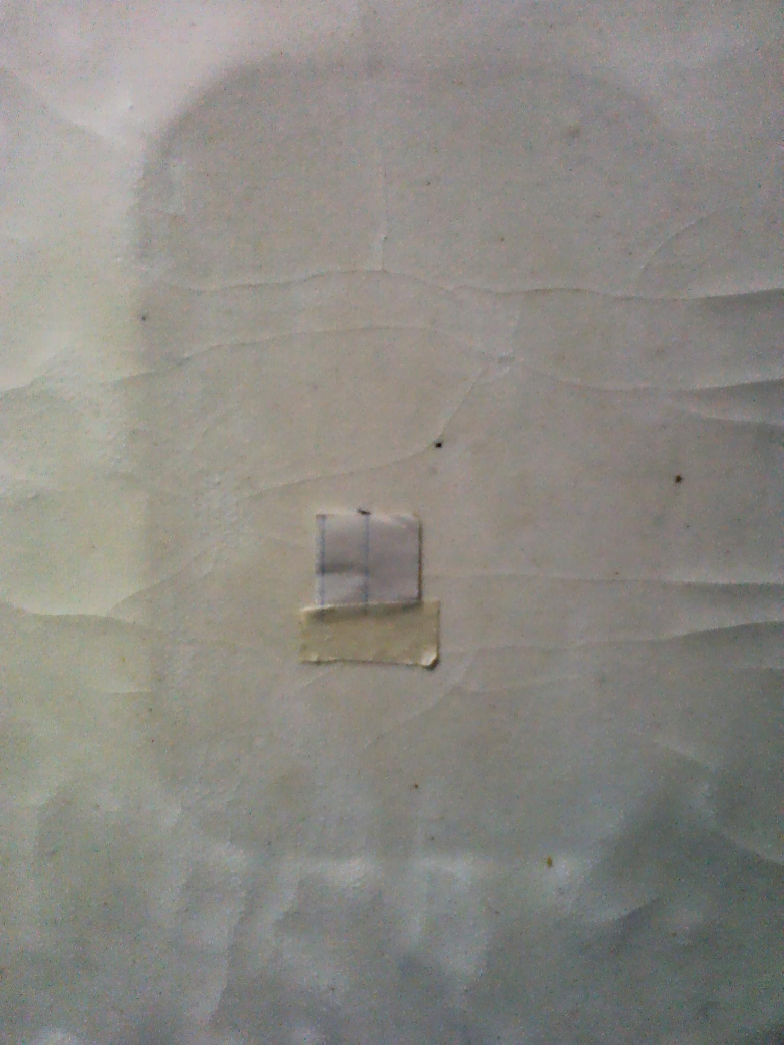

Would you believe it I managed to sneak into my room🙂
The first photo is with the mic 1in or so in front of the paper square.
The second is with the deq on peak hold and moving the mic around the edge of the square ,not over the square but over the panel.
The third is of the top edge of the ply panel in the frame.
The last deq photo is at 1m from the panel.
The other two are of the panel cracks and all, the black dot at the top of the paper is the centre of the exciter coil.
What I thought was interesting was the fact that the paper seems to be mimicking the panel response but around the the paper area seems to have a pretty flat response?
Is it acting like a phase plug?
But at the end of the day it is the sound difference that I am most interested in,you get the benefit of a light panel (paper) and a heavy panel ,you name it.
This was never ment as a permanent fix, but to find ways of curing the problems associated with this area,but it could be a permanent fix on heavy panels if needed.
I should mention that the paper should not be pressed hard up against the panel, there must be a small gap to let paper vibrate freely , hopefully without buzzing.
Different weights of paper can change things too,I did use a thinner paper ,but felt this didn't work so well?
I am desperately trying not to say anything about the the bad interference you are going to get from those two exciters in close proximity on your panel,or even on the same panel, it's bad enough using two normal tweeters that close .
Say no more.
Steve.

Very interesting and lots to explore. I am going to experiment more in a systematic way over the next week or two to see if I can zero in on the sort of improvement you are getting. Current theory - and as you know I have a lot of theories- is that the paper is acting kinda like a parasitic tweeter like whizzer cones. What still surprises me is just how sensitive the response is to such a small amount of material and the positional differences. The panels are far more sensitive to change that I would have expected.
On twin exciters, it's an experiment. The Tectonic exciters have a better high end response than the Daytons, the only problem being that isn't showing up in the measurements.
On the ever growing list is retesting with the Daytons, then the Tectonics and then both together so I have reference data for my file. I will share when completed as always.
On interference I have heard others talk about this and I was a single exciter advocate for a while. As two appear not to effect the subjective experience I am no longer so sure but remain open minded on the issue, its just my needle has moved a fraction. On interference, and assuming normal physics applies, the distance between centres is about 50mm which is the wavelength for 6880 hz. Any phase cancelation will occur at twice that or 13760hz so I will see if I can measure that region when I do some more testing. Yet another one for the list.

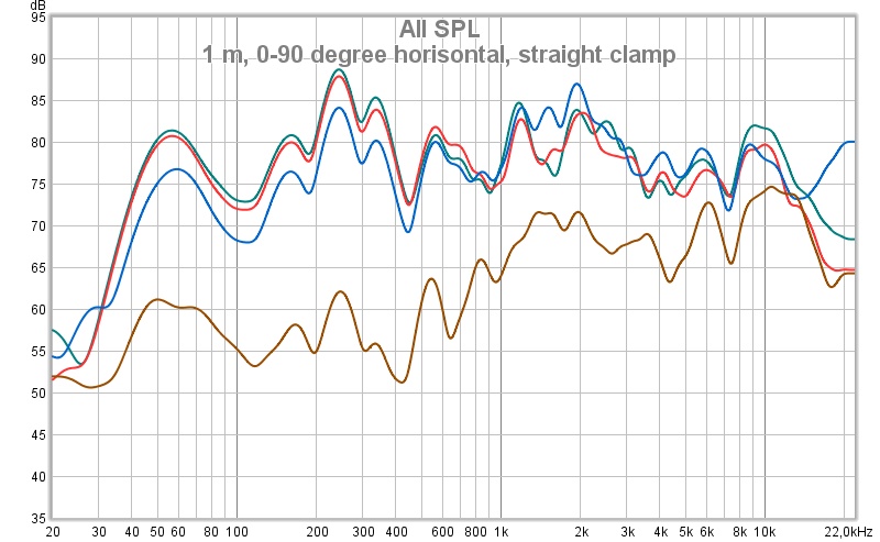

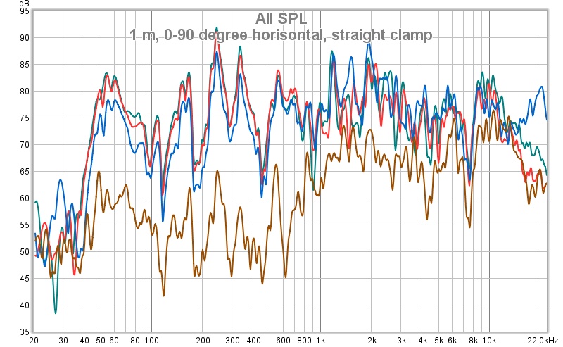

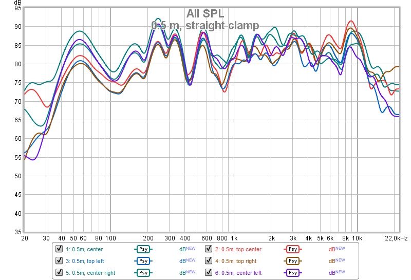

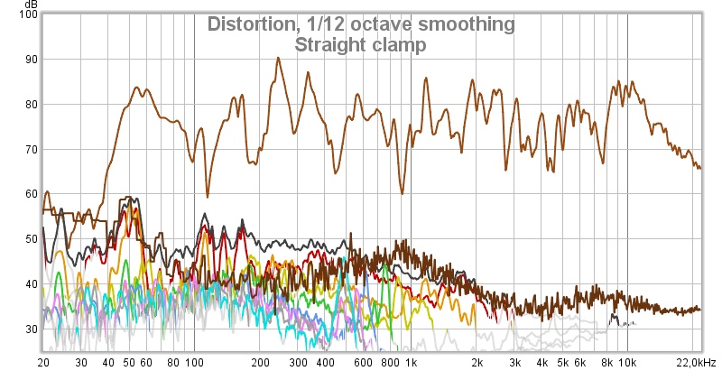

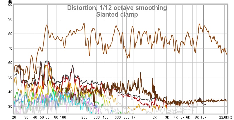

Outdoor measurements of 120x60 cm ply panel
Today I got around measuring the 4 mm thick 120x60 ply-panel with DAEX32EP. The panel is clamped at the bottom and that's it (effectively 110x60 free surface). Here is at 1 m distance on axis:
Here is response at 1 m distance (24th octave smoothing) for 0, 30, 60 and 90 degree horisontal angle:
And with psycoacoustic smoothing:
Very little output straight to the sides (90 deg), which is very obvious when you listen to the speaker.
These 6 measurements are from different parts of the panel at 0.5 m distance (center/center, top/center, center/left, center/right, top/right, top/left):
Quite uniform, the top measurements show bass output.
Then I tried slanting the clamp:
The panel now has one edge that is 80 cm and one that is 110 cm. That does look better IMO.
The results are interesting, but to me they sound like the singer is in a (wooden) box. Acoustic instruments sound fine, but they are wooden boxes, so I guess that is expected. Should I try to add more damping or a frame?
/Anton

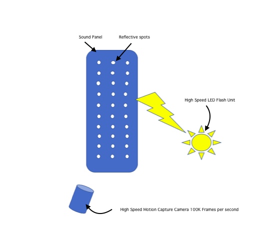

High Speed Flash Test of sound panels
High Speed Panel Testing:
I am developing a test for measure the actual panel physical distortion that the panel to exciter has. It is based on using a high frame rate motion camera that our combustion lab has and a high speed LED flash unit that I developed for the Lab.
The LED flash generates a burst of short pulses that the duration of each pulse can be adjusted from 100 hundred nanoseconds to 10 microseconds in duration and can deliver a pulse bursts of 1 microseconds to 100 milliseconds in each burst. The LED Flash unit is sync to the High Speed Frame camera so that each Flash of LED light is captured by the camera.
The sound board will have a matrix of small 1mm diameter retro-reflective paint spots spaced in a pre determine grid that are applied to the sound board with a cardboard mask that have the spot array cut out with a laser cutter.
There is image software that the high speed camera analysis that can map the displacement of each spot to each other to create a surface profile of the sound board distortion due to the excitation.
This can allow testing of different sound board material and different exciter placements. There are several students that want to take on this project for their student design project and putting out a paper on it . So hopefully can start when things here open up and start getting back to normal.... Here is a schematic of the concept.
Steve

Looks like slanting the clamp has reduced the 15db peak to peak to 10db peak to peak!
And the main response is being held mainly within a 10db window,so a smoother response overall.
Your panel is also maintaining response way above 10k hooray!!
Did you try my method of pausing the music to hear if the panel makes a shoom sound after the music stops(panel keeps on resonating),this is a problem with large panels.
XO the panel around 300hz and see if it is still happening so bady,
As for damping,There are at least two thoughts on this ,my way would be to solidly clamp the panel in a heavy frame ,you would have the same sort of sound but louder ,but which would hopefully control the resonances better.
Or you could use foam to mount the panel onto a frame to dampen it,this would affect the sound , making it sound softer and smoother , like applying doping to a cone driver.
Obviously a frame would be needed for both,so you could experiment with both types,I would recommend a heavy rigid frame for both types,for less play in the frame.
Steve
