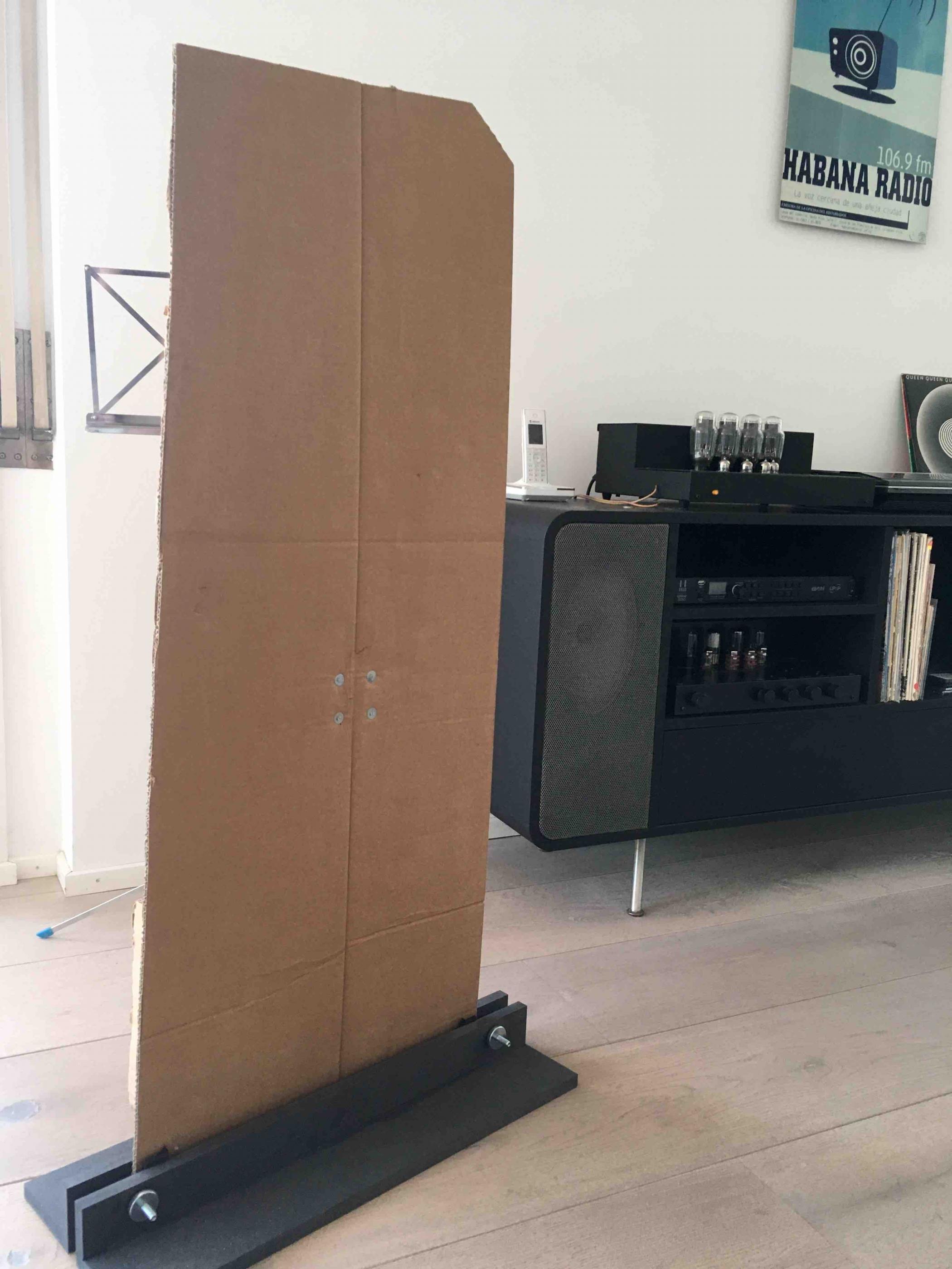

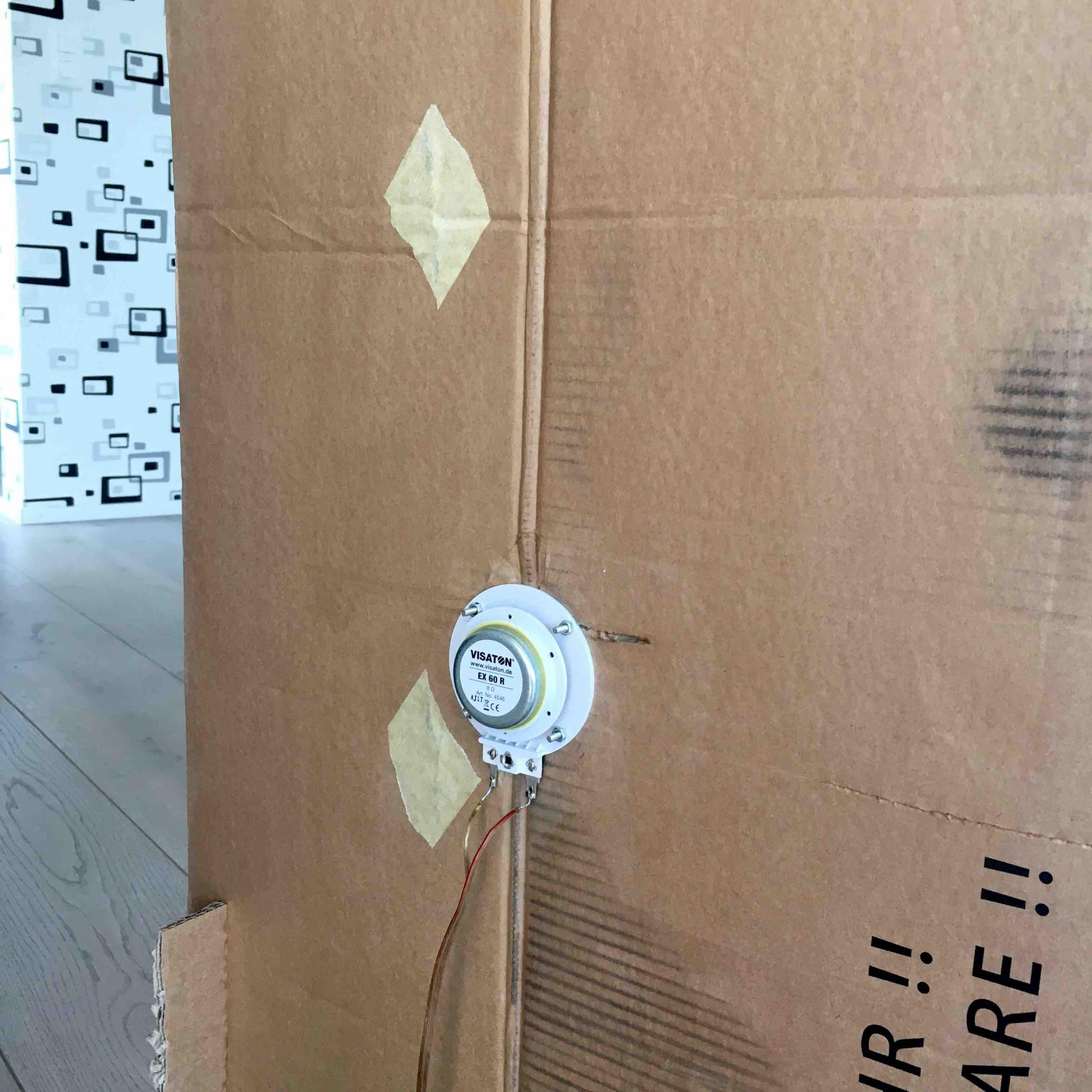

yesterday one speaker on Swap (honeycomb cardboard) mounted.
The panel measures 390 x 810 x 13 mm and the weight is 480 gr. The exciter (Visaton EX 60 R / 8) is mounted slightly off the center in the diagonal. The clamp is made with MDF and one thin woolen felt jacket used for damping.
The soundstage is amazing. The sound balance I'll try to improve ; )

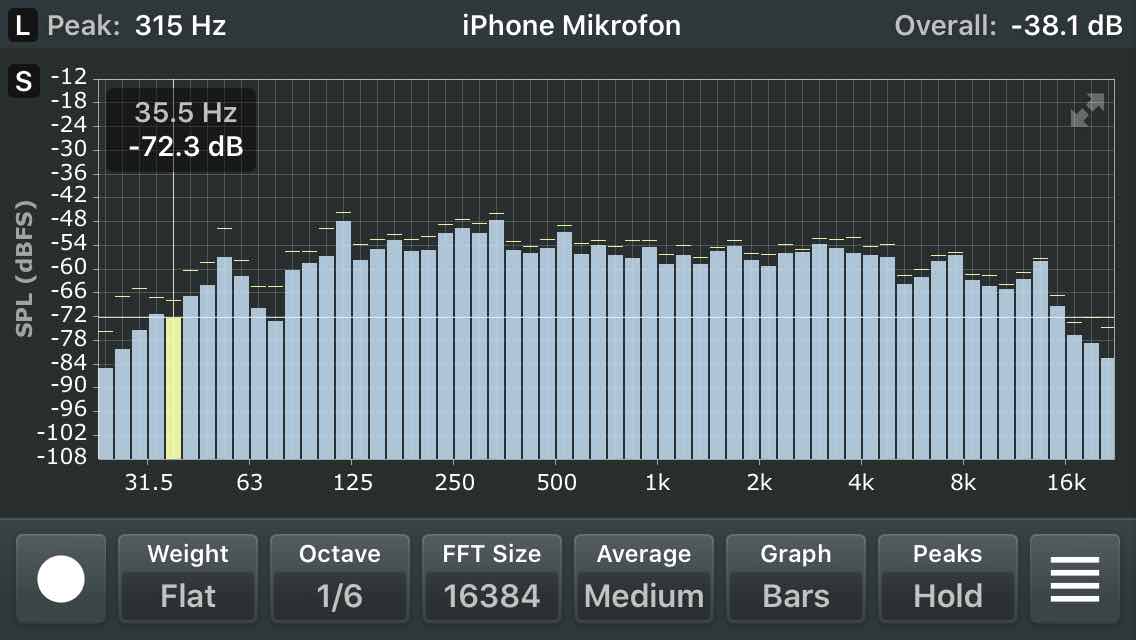

Pictures show the speaker with clamp, pink noise at 30' and 10' (approx)
At the recycle bin corner of a bike shop I picked up yesterday some double layered corrugated cardboard, made a panel of about 47 x 115 x 7mm with no parallel sides, one cutted corner and one 90° angle. The cardboard needed repair on some spots and I did a slight coating with PVA/water. The exciter (Visaton EX 60 R / 8) is mounted at 1/3rd from the bottom. Both panels are fixed with my clamps and some soft (packaging 'worms'/fillings) and/or medium (rubber foam).
When only soft damping material is used, the bass is slightly better.
Compared to the honeycomb cardboard the details of the corrugated cardboard are not that clear but overall the sound is pleasant and looks a bit better flattened over the useful frequency range.
My preference is the honeycomb cardboard but I will go on with the corrugated double layered to check out my options list.
By the way, the panels sound better from day to day. Maybe I get used to that sound,-)

Hi Steve100ohms
The dip at 180hz can probably be filled by sliding something like an AA battery around the panel surface until the cancellation spot is found,wouldn't be surprised if this was going towards the top left of right corners from the exciter ,but it's different for every panel type,so check the whole panel.
The dip at 5.6k might be filled by using my strip of paper technique,by sliding a 1inch strip of paper across the exciter central point,usually when one edge of the strip of paper, is on or near the centre of the exciter coil,while monitoring the response in the exciter area ,this will also alter the HF,try to get a flat response.
Hope this is of some help.
Steve
haven't made yet your suggestions of physical resonance amping / equalizing...
The graph with the corrugated cardboard has a smaller dip at 5.6 kHz. The picture of the panel shows the exciter mounted on a bended line of the cardboard and this probably is the cause for that.

OK, inspired by this thread, my DMLs are starting to take shape. I largely took inspiration from your French design, BurtCoil.
This is how they are behaving with a cheap sub, and a hint of HiFiBerry DSP.

They sound great. I'm wearing them as headphones in the office and they compare quite well to my KEF system.
