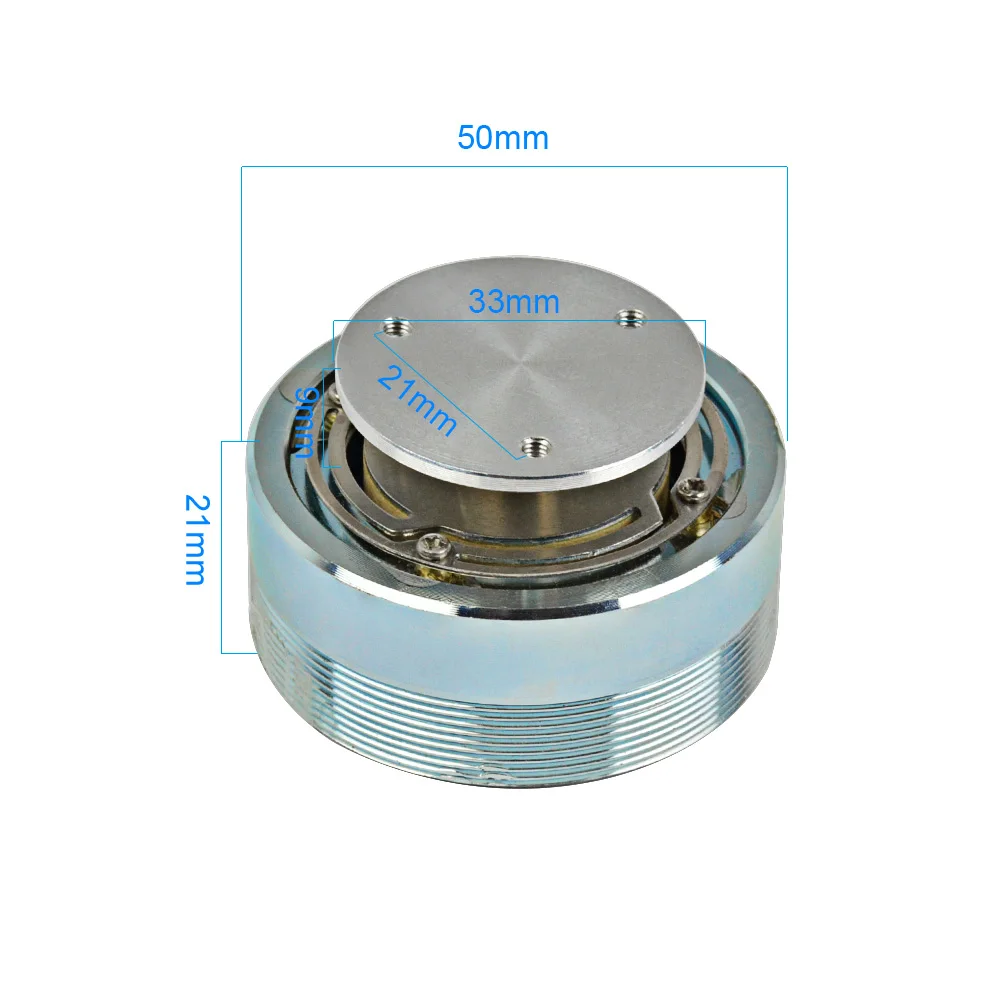

Cheapvega.
They look like a very robust exciter.
My only concerns I have are the coil is attached to the very stiff spring plate and then you screw it on to the plate that you screw to the panel.
I'm not sure if it was you who suggested screwing the spring plate directly to the panel but this could be a good idea as it would drive the back and front surface at the same time.
Maybe better used on heavier panels such as ply .
The springs are not as free as the spider on my type of exciter and will be harder to drive and will probably have a sound of their own?Steve
You would also be screwing the panel to the plate centre not the coil directly.
If you try them let us know how it goes, you should still I think get a pretty decent sound out of them with the right material, hopefully.
Steve.
