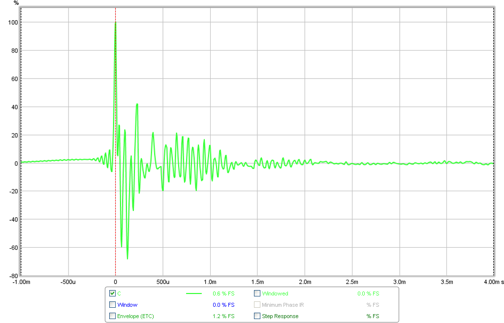

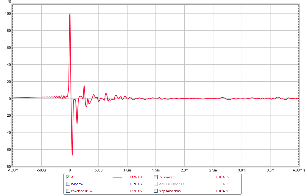

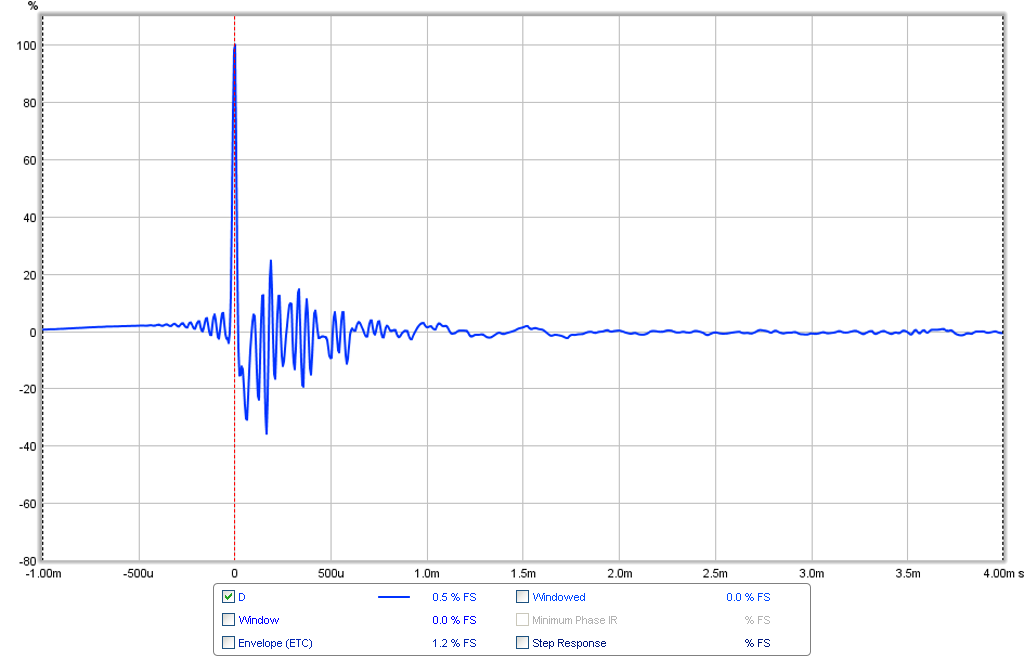

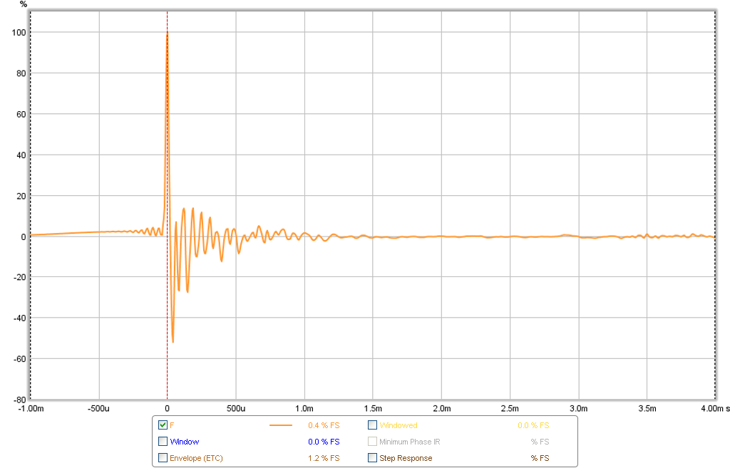

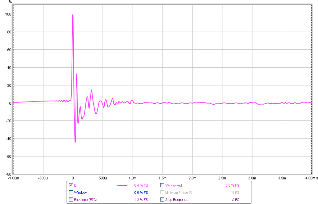

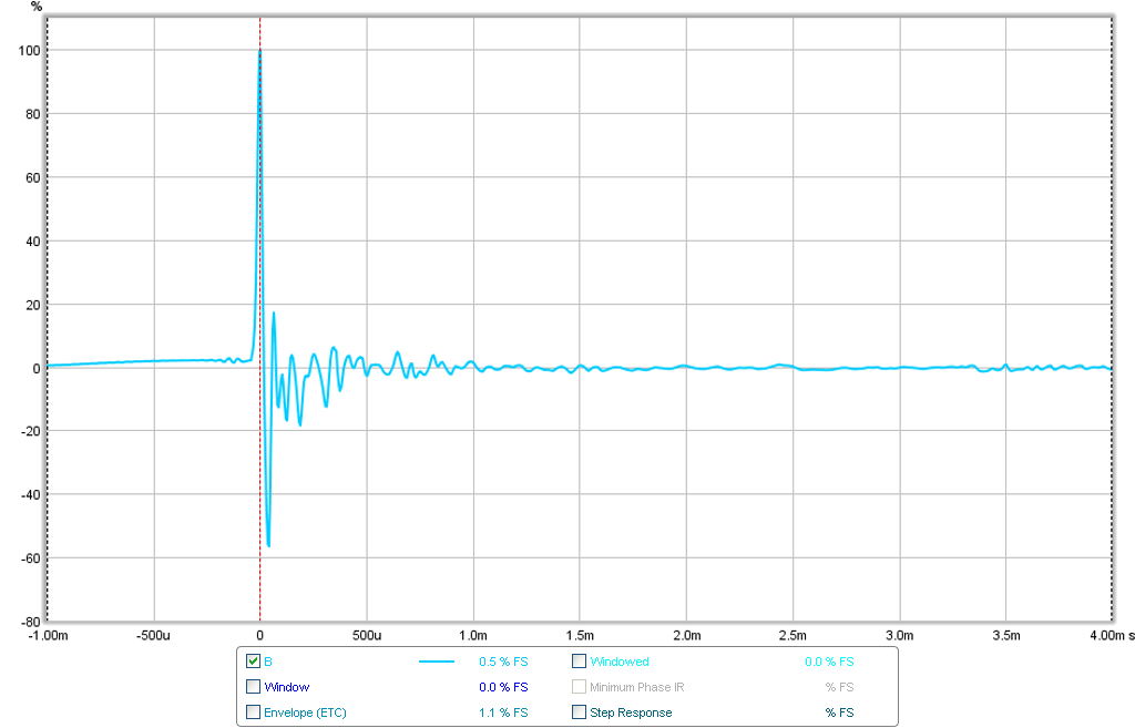

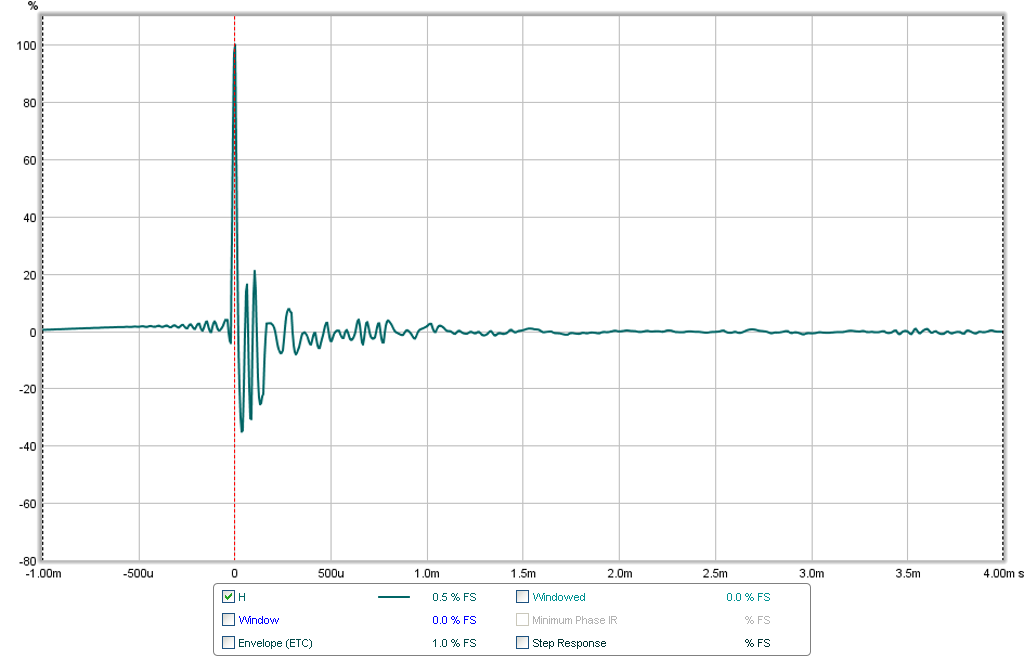

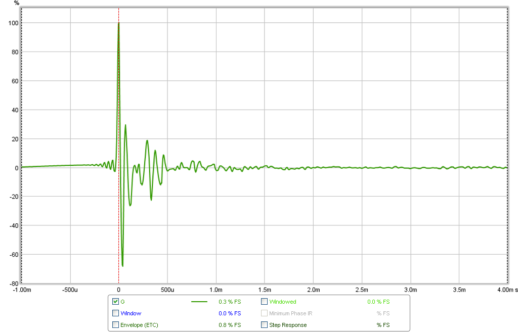

Measurements of Round 3 Drivers
Measurements were made with a miniDSP UMIK-1 microphone calibrated by an independent 3rd party (Cross Spectrum Labs). Mic was 0.5m meters away from driver, at zero degrees (on axis) of driver under test.
Here are the Impulse Responses for
Driver A:
Driver B:
Driver C:
Driver D:
Driver E:
Driver F:
Driver G:
Driver H:
Driver A:
Driver B:
Driver C:
Driver D:
Driver E:
Driver F:
Driver G:
Driver H:

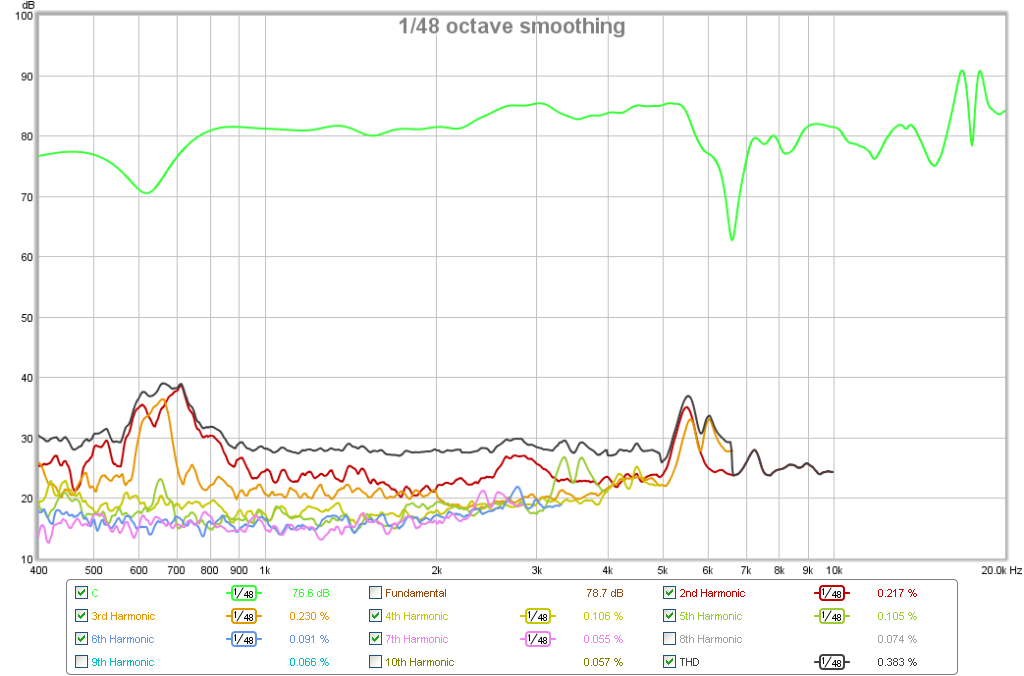

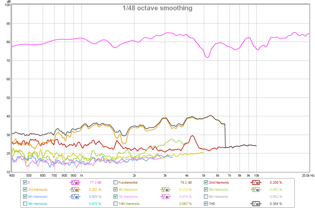

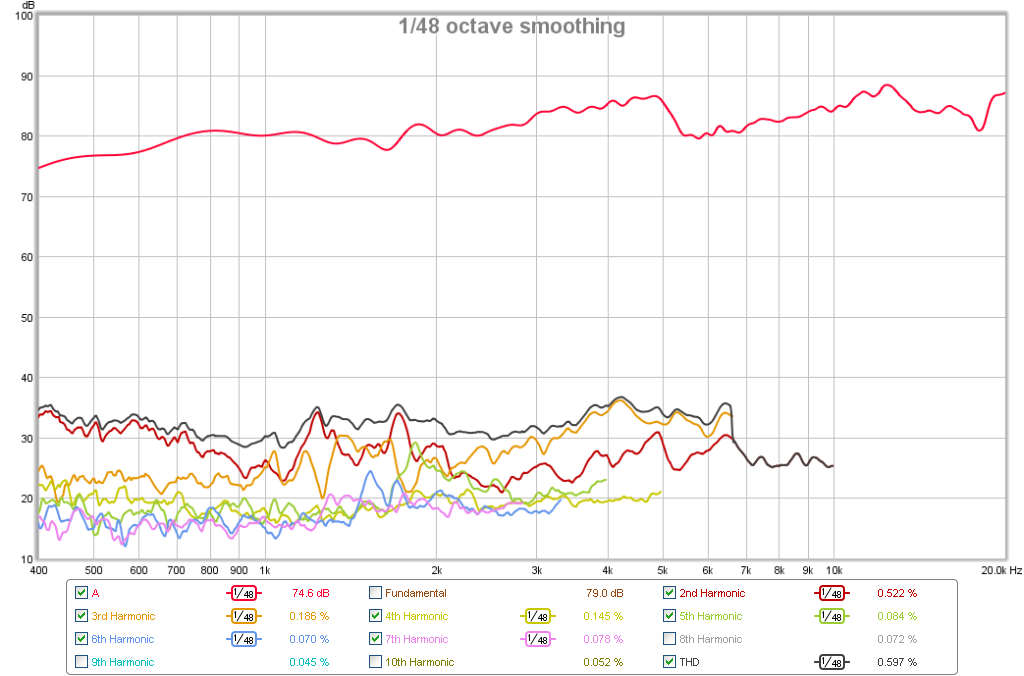

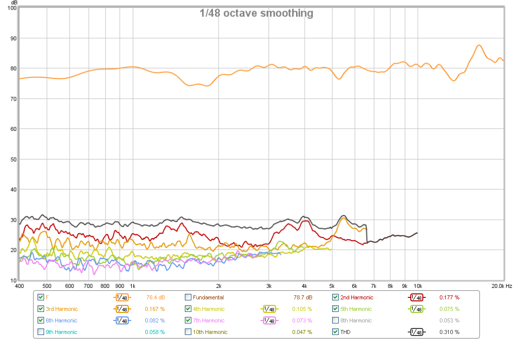

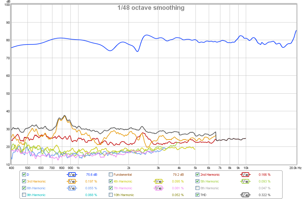

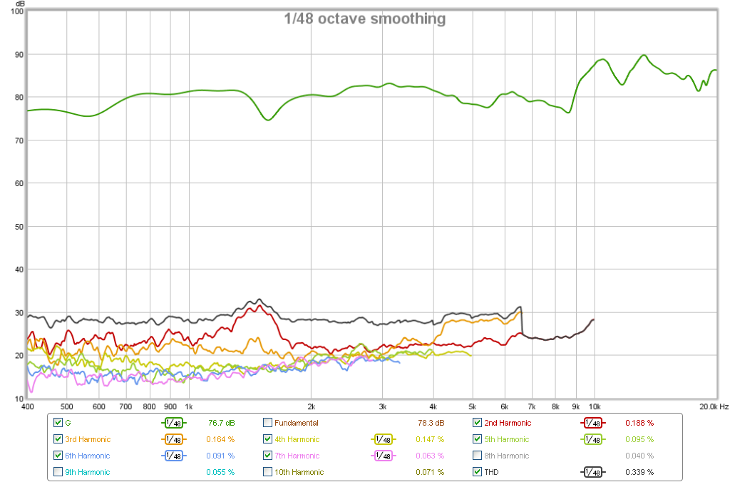

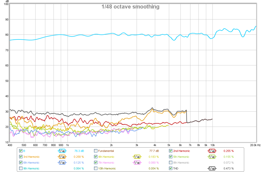

Measured Harmonic Distortion
HD data taken with mic at 0.5m and 1.4v drive level. Not particularly challenging drive levels, but just happened to be what I used for the main frequency response and impulse response measurement. A driver should have very low HD levels at 1/4 watt drive levels. If there are peaks, they are indicative of a much larger problem at larger drive voltages, for example, voltages required to reach 90dB.
Driver A:
Driver B:
Driver C:
Driver D:
Driver E:
Driver F:
Driver G:
Driver H:
Driver A:
Driver B:
Driver C:
Driver D:
Driver E:
Driver F:
Driver G:
Driver H:

Thanks for posting the IR and frequency response. Looking at the impulse response, you can see why some weren't liked; they ring like a bell. But when you look a A the IR isn't bad and decent frequency response one wonders why it didn't get more votes. Any thoughts?

As predicted the Tang Band (F) has the most dominant 2nd order distortion. But it didn't attract enough listeners as I thought it would. And I couldn't relate the HF fatigue with the HD plot.
But may be there is something need to be changed with the charting options?
I didn't need to think twice for C and A, as they are the most fatiguing of all. C is the most fatiguing, probably from the frequency response. A is the second, and you can see it has probably the worst THD.
Jay
I can see why you don't like C; rings like a bell. I don't like it either. A doesn't ring. On further examination it does have a rising frequency response. That's what probably disqualified it for most people. As to distortion, most of the drivers are acceptable. See Geddes and Lee.
Jay
Jay
The more you listen to A, the more it sounds like buzzing piece of paper.
Drivers with Nd motors appear to be better ranked drivers too. It would be nice to see these with burst testing showing IMD. In particular the W3-1364SA; specs claim very limited linear excursion, yet xmax is generous.
I've worked Peerless 830970 2" 4ohm driver with burst signals that span 120volt p-p; above 1kHz the driver is resilient and quite capable.

I'm actually rather impressed by the performance of the FRS5X (A), though the THD is marginally higher across the band than the others, there are no real peaks to speak of (like C & D) or a rising THD like E, despite their overall level being lower. Absence of THD peaks at the LF end of their usable range is a bonus for the FRS5X and the others (excluding C&D, and maybe E).
Also the impulse responses of A and H look like the cleanest of the bunch too. Not too shabby for a €7 driver!
Until now.i had read your last plots upside down....
I think I don't believe the THD charts, I mean, all drivers look similar here. In reality, small difference can make or break.
I didn't listen or examine C and A in detail. I didn't even listen any of them in full, so I don't know exactly what is wrong with them... But for other drivers I listened in detail and I know the difference between them, their strengths and weaknesses.
