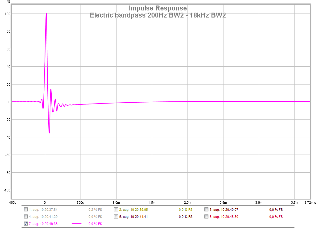

.....Why? Alpair can never catch a break during listening tests.....

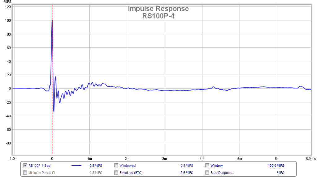

Think it can't stop its energy soon enough, see IR below how a electric bandpass filter 200Hz-18kHz looks, then see how close but acoustic a 10/8424 gets to this, and last see how A7.3 rings. For fun show RS100P-4 from round 1 because this driver audio able for me was the best at ACDC track to sound as dry as possible compared to reference track which is really dry.
Electric bandpass 200Hz BW2 - 18kHz BW2:

xrk971's RS100P-4 plot linked from round 1 http://www.diyaudio.com/forums/full...in-5in-full-range-drivers-34.html#post4251796.
Byrtt,
Thanks for reminding us of how clean the IR of the RS100P-4 was. That is an impressive result and may warrant me to explore that driver a little further. It may deserve to be the mid in my next 3-way as it seemed to lack a little bit on the top end - but the clean IR and flat mid response may make it ideal for a transient perfect 3-way speaker. Something like RS225-8 for bass, RS100P-4 for mids, and RS28F-8 for the tops for an "All Dayton 3-way transient perfect speaker" using either a B&O "hole filler' XO or the symmetric (BW4-BES2-BW4) Harsch 3-way XO.
