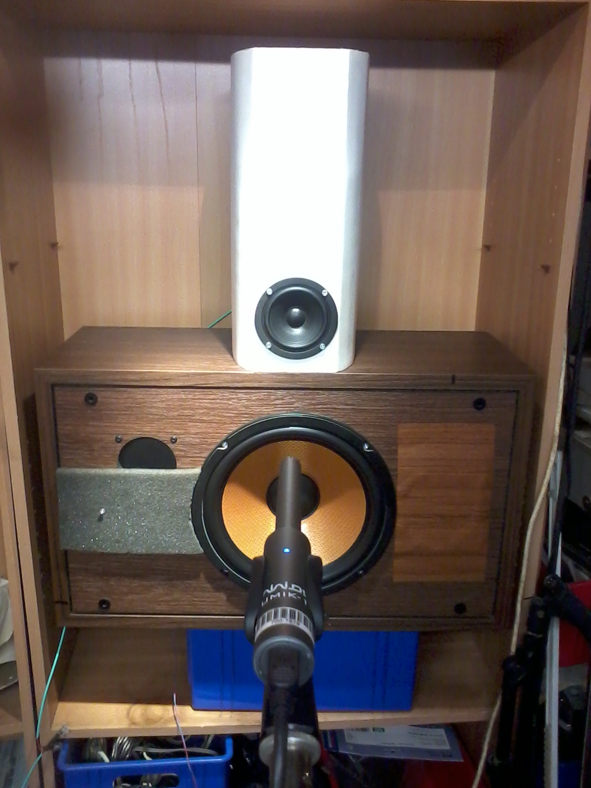

This round only listened via speaker but it was tuned 😀 with driver winner from round 2..... http://www.diyaudio.com/forums/full...3in-5in-drivers-round-2-a-46.html#post4397112
Anyway how it turns out had been fun as usual, and when revealed including the objective measurements we get later when xrk971 get to his computer will be very 😎 diy data as round 1 and 2 was.

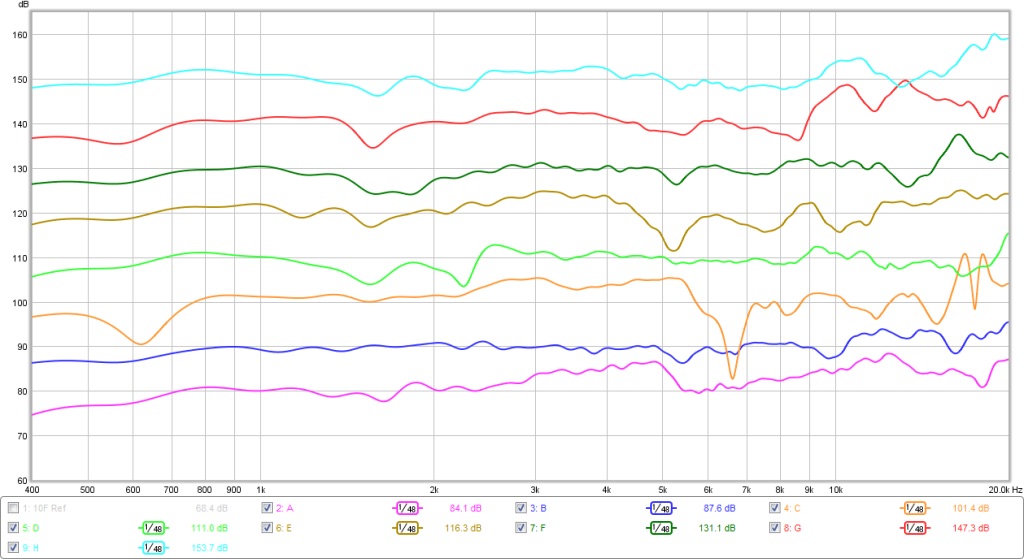

And here are the measured frequency responses (shifted 10dB to allow plotting on same graph). Measured at same location as recording mic (0.5m). Spectrum show gated at 4ms and 1/48th octave smoothing.
Very interesting results. I was hoping that the B80 wasn't one of the top results and that B was something cheaper lol. I'm intrigued that the P830983 measures so badly (10dB variation at 2kHz) yet, we still liked it. Interestingly the SB65 has almost the same freq response problems around 2K that don't really appear in the datasheet. Are the drivers flush mounted in the test baffle and is it chamfered at the rear for airflow?
amazing the little 2" peerless P830983 (D) ranked second with 5 votes.
I picked H which is the 2.5" SB65 (4 votes). So my top two picks were both under 3"
I recently pick up a fostex fe83en which I am also really enjoying.
I hope more people will start to use and explore these high quality small drivers even though they are weak in bass and need to be used with a sub or bass driver (FAST).
And yes I provided the sample of the P830983. I am glad this little gem made it to #2 even though I ended up picking the SB65 in the blind test. I think I might have to pick up the SB65 at some point too.
I do wish more people would have joined in the voting though this time.
