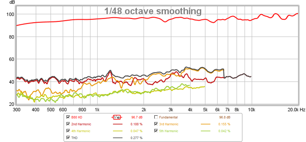

Here is HD measurement for B80 at equivalent to 90dB at 1m drive (96dB at 0.5m). I get the same bump at 1.2kHz, otherwise seems cleaner. Sometimes the mic adds noise and HD. This UMIK-1 is cleaner than the UMM-6 when it comes to HD data.

3rd harmonic still biger than 2nd..Here is HD measurement for B80 at equivalent to 90dB at 1m drive (96dB at 0.5m). I get the same bump at 1.2kHz, otherwise seems cleaner..
Other tested drivers have different distribution of harmonics, that may be reason for victory..
Doubtful at the low listening levels that the test was done at all drivers exhibited very low distortion. It's only under duress that the cracks start to appear.
