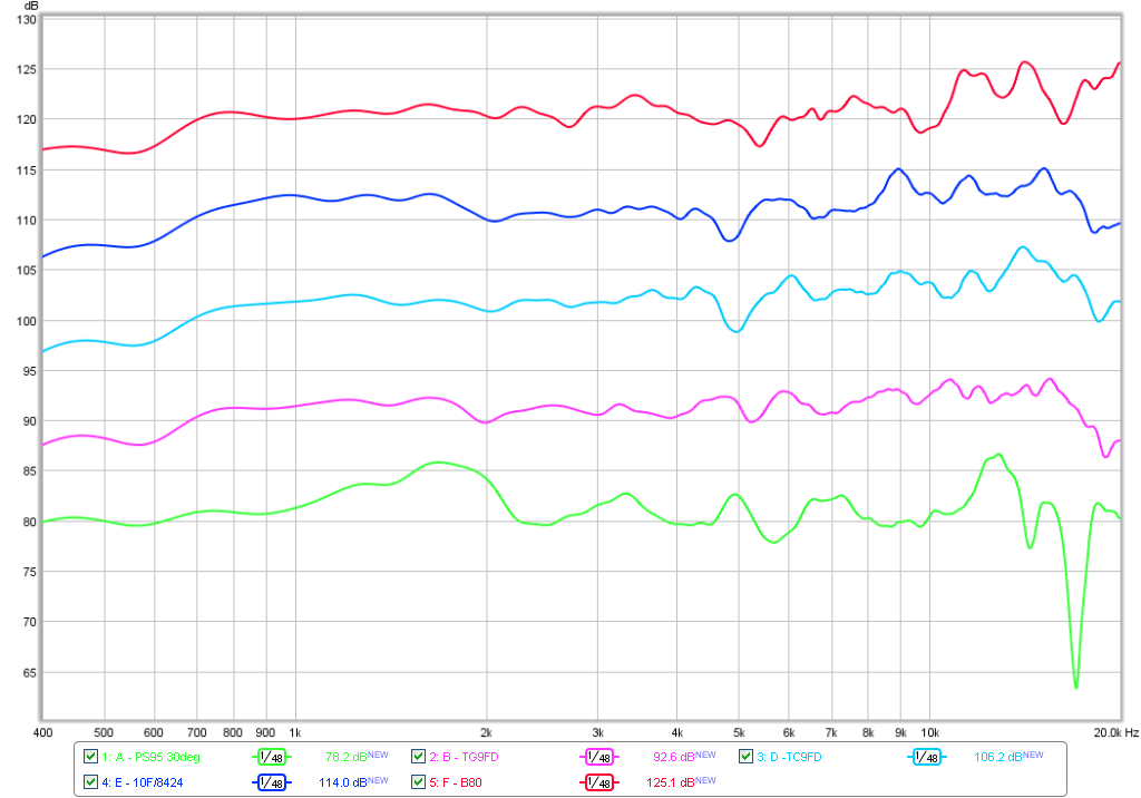

There is one area that A differs from all the rest: it has a +3dB Q=1.6 bump at 1.7kHz. This area is very sensitive to our perception of presence and soundstage. I have heard of mastering engineers juking this spot (up to 2.5kHz) by just a mild 2dB low Q boost to bring out the presence of a track. I know the the specifics of this particular bump because I was able to flatten it perfectly with the same values with -3dB cut. I actually recorded all 3 clips with this EQ and was going to submit to the poll as driver "C".
I changed my mind at the last minute because I thought you all would have a riot once you found out I tricked you with the same driver but with one EQ'd flat at this one spot. Now thinking back, it may have been an interesting psychoacoustic experiment.
It could be some people prefer this lively little 1.7kHz rounded peak.

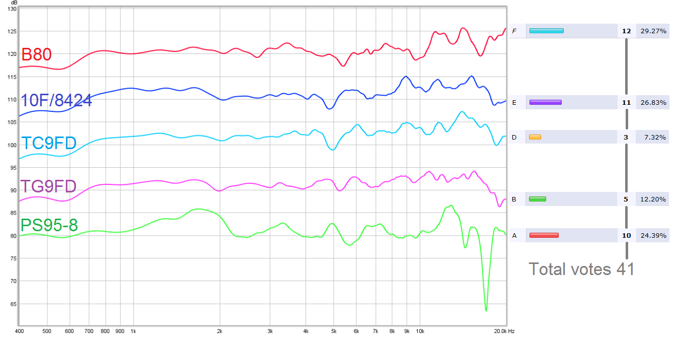

Regarding PS95-8 being real voted in as third seems a got a lot attention now and notice at reveal X did write: A = Dayton PS95-8 at 30 deg off axis.
Like to hear how PS95-8 CSD/FR/HD plots is measured, because is they measured at 30º off axis as sound clips were recorded at to replicate what we heard ?
Comparing FR between TC9FD/PS95-8 that both were present at round 1 and 4 have no consistency (especially PS95-8 very different) in my eyes even knowing it was not same baffle/woofer setup these two rounds and why i could suspect PS95-8 is measured here round 4 at 30º off axis.
Round 1 black is TC9FD purple is PS95-8.
![497966d1439219891-subjective-blind-comparison-2in-4in-drivers-round-3-round_1.png](https://www.diyaudio.com/forums/attachments/full-range/497966d1439219891-subjective-blind-comparison-2in-4in-drivers-round-3-round_1.png)
Round 4 light blue is TC9FD lime green PS95-8.
![504223d1442325845-subjective-blind-comparison-2in-4in-drivers-round-4-round-4-reveal-all.png](https://www.diyaudio.com/forums/attachments/full-range/504223d1442325845-subjective-blind-comparison-2in-4in-drivers-round-4-round-4-reveal-all.png)

So judging from your story here and viewing the graph:
![504231d1442331363-subjective-blind-comparison-2in-4in-drivers-round-4-round_4.png](https://www.diyaudio.com/forums/attachments/full-range/504231d1442331363-subjective-blind-comparison-2in-4in-drivers-round-4-round_4.png)
The biggest peak between 1 and 2 KHz sounds more distorted, so more in line with the reference? That's A, on the graph. But the B80 is the lowest in that same range with the Vifa's and Scan Speak in between. Makes absolutely no sense to me what you're trying to say. I see no relation to A and F based on the output at 1-2 KHz. They do share some design features.
For me F was tonally more correct on Barracuda than the rest, compared to the original FLAC file. Seeing the FR response it makes sense to me.
I don't know what A was doing but I liked absolutely nothing about it. Judging with the "Rock" clip. That's why I said:
Indicating that it would probably be the secret entry (mystery driver).It is scarier to me that a certain driver is getting as many votes as it is, I'll call it "M".
Its a real mystery to me!
Had the HF part of the B, D, and E speakers been corrected (in line with previous rounds) I have no doubt I would have picked one of those. If that same compensation had been used on F it would have made that one worse if you ask me.
A little voicing can go a long way. I remember listening to round 2, to what later turned out to be the 10F on the Nora Jones track. Listening on my arrays I was thinking, that midrange is to die for! Only to later realise I was listening to that midrange trough my speakers. So I could make them sound that way! I had heard them do it after all. And with a bit of (EQ) work I did get there.
