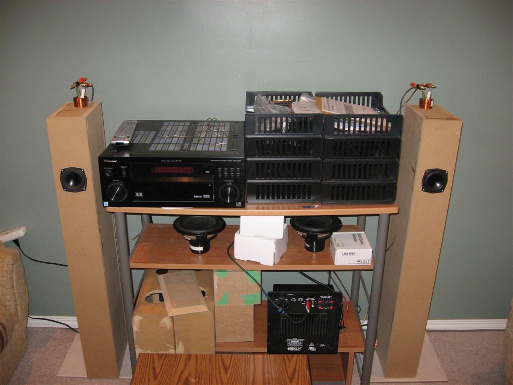

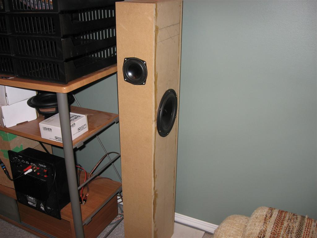

Here's one of my experiments:
Aura NS3 and Exodus EX-6.5. Crossed at 150Hz in the amp (could cross at 200 but the sub amp only goes to 150Hz), all sealed (5ltr & 15ltr, I think) , with ~3db of BSC. Sounds good where they in the picture but need lots of power to get decent volume. Just need to find another cheap amp to play with different crossover configurations.
From questions people ask when they audtion them, i think that people feel that inside is their 1st instinct, but on Tysen, with the 30 degree toe-in that works so well, the woofers need to be on the outside so that they fire "forward". If they were on the inside they would be firing at the wall behind the speakers.
The cabinet size, toe-in, and XO all work together to get flatter FR thru the baffle step loss region.
dave
