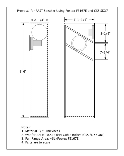

I've been reading this thread with some interest. I've drawn up a proposal for a FAST speaker using Fostex FE167E and CSS SDX7.
I calculated the midbass based on Q=3/8 cubic ft (Bessel Butterworth) But now I need some help with working out "aperiodically damped 10:1 taper TL".
I would like to reduce the width of the cabinet, but need to figure out the full range side first.
I currently have MLTL's with FE167E, which I do like. However, my music collection dictates what I need more of, Midbass and BASS.
Thank You.
Bessel = 1/2 cubic ft
Butterworth = 1/4 cubic ft
I like to use 14-17 litre
With its much lower Fs you'll need a longer line for the FE167.
I suggest you fold it which would give about twice the length you have.
With the FE167 you can XO lower, with the FE127eN Fonken XO at 100 Hz which lets me mount the SDX7(s) at the floor for more room support.

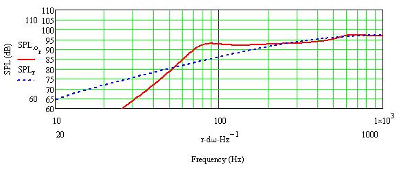

I borrowed DCX2496, set upo the old G3 Lombard PowerBook with measuring mic/Fuzzmeasure and played with all sorts of XO arrangements.
With the DCX the only one happy with the sound was the measuring mic, but i learned a lot about XOing the combo -- for instance, as pictured the woofer is upside down -- i got quite severe combing until i fliipped it do the woofer was close to the mid-tweeter.
Attached is one of the FR curves. The limits at the bottom may not be the speaker but the Lombard's analog input and the roll-off at the top is from too long a mic cable. Althou a bit saddle shaped it is +/- 2dB from <30 Hz out to beyond 15k. There is a small amount of lift set at 25 Hz.
In the end i choose a 1st order XO on the woofer & 2nd order Bessel on the midtweeter at about 350 Hz. The low order XO on the woofer helps fill in the baffle-step loss. In this case the natural rolloff of the SDX7 above 1k doesn't hurt either.

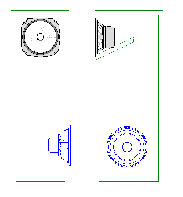

I did a couple of versions:
A - Longer TL line with the SDX7 closer to the bottom, but further from the FE167E. No extra space.
B - Shorter TL line with the SDX7 farther from the bottom, but closer to the FE167E. Lots of extra space.
Each proposed has a 15L capacity for the SDX7, and the line was divided in three place it closer to the woofer.
Which would be better? Longer line, lower XO or Shorter Line, probably higher XO, but possibly less combing effects? Hmmm.
Thanks Dave and Martin King(for you worksheets)
Leo
I was thinking something more like this sketch
dave
Is that considered a small ML TQWT? Is the "Closed End and Ported Transmission Line" model applicable here?

Leo,
It is a tapered TL. Aperiodic means it is heavily damped. For midrange use the stuffing gets denser as you approach the terminus, with almost none right behind the driver.
10:1 is the taper ratio. The cross-section area at the driver end is 10x larger than the cross-section at the terminus.
