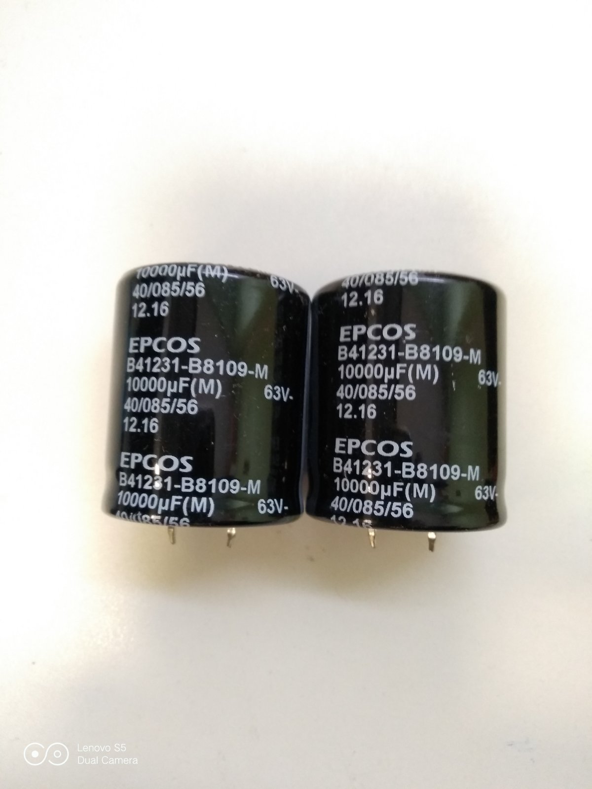

Thank you, do not be offended,I always listen to any opinion. I'm not in a hurry, because the boards are still on the way, and I'm at work. I will take into account all the comments and advice.I have Nover capacitors, 10000mkf 50v, but a 36v transformer, I wanted to buy capacitors with a voltage margin. What are the tips.Attachments
Do you propose to put Nover 10000mkf 50v capacitors on the boards, and add 22000mkf63v outside the boards? The voltage I have is 4X36v, usually capacitors are chosen with multiplication by 1.4, it will turn out 36x1.4 = 50.4v. Correct if I'm wrong. Large capacitors are laid out for a smile.Maybe I'll do something like that.

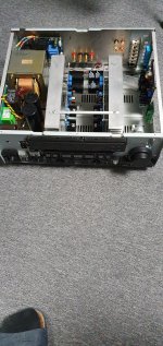

I just had a transformer and capacitors from yamaha dsp-a1000. And I decided to apply them. Therefore, on boards 10,000 should be enough. And yours is beautiful. I was stopped here by the fact that separate transformers, or separate windings, are needed to power the 12-18v protection. Remodel

But you need some design margin. In your situation 63V is the right choice.Do you propose to put Nover 10000mkf 50v capacitors on the boards, and add 22000mkf63v outside the boards? The voltage I have is 4X36v, usually capacitors are chosen with multiplication by 1.4, it will turn out 36x1.4 = 50.4v. Correct if I'm wrong. Large capacitors are laid out for a smile.Maybe I'll do something like that.
Next, max capacitor diameter is 35 mm. Previously I gave you wrong data and I appology for that. Distance among leads is 10mm. Use capacitors with snap-in soldering pins. It is impossible to use capacitors with screw terminals.
Also, having capacitors on-board is a huge advantage. They are placed very close to rails, almost on the leads of the output devices and may wuickly provide extra current when needed. Any additional wirings would add to unnecessary impedance.

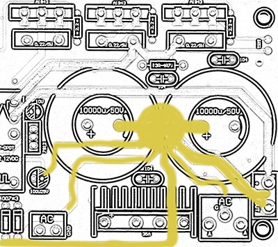

PS but important: Observe the board between the power supply capacitors. There is fine star grounding which is important for achieving low noise floor. Therefore, keeping capacitors exactly where they are supposed to be is of paramount importance for achieving very low noise.

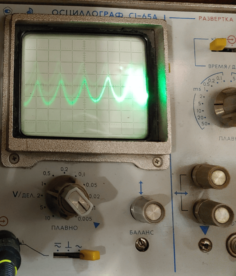

An oscilloscope is a useful tool, it was not for nothing that it took for nothing. I looked at the form of power supply of the preliminary cascade, and there ripples, you can see it below in the photo.
Measured on diodes (katode):
In kit 5mV.

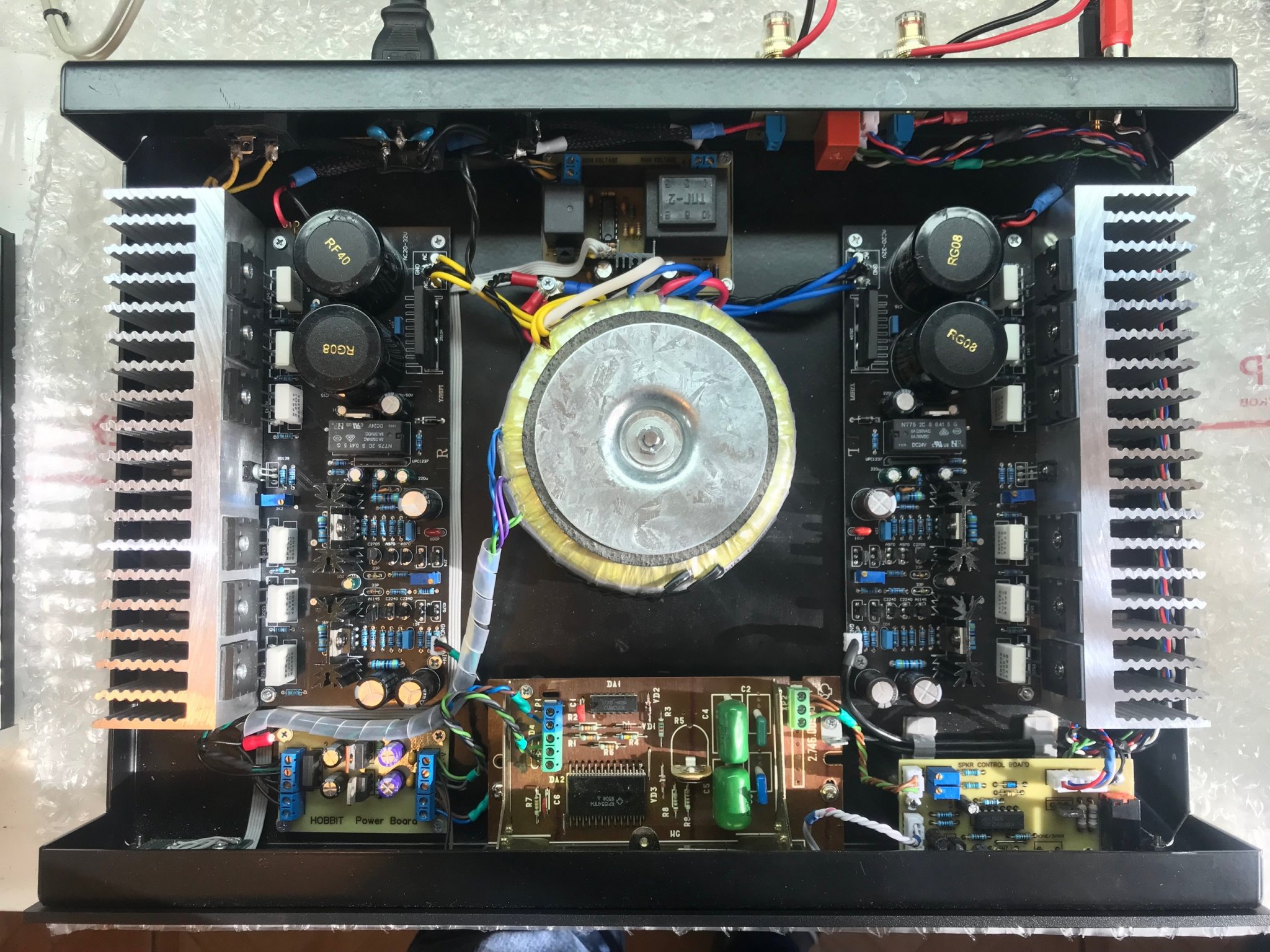

I decided to go extensively and increase the total capacitance of the test board. Now the total capacity is 80 000μF. I also laid a conductor with a cross-section of 4mm2 on the board from the OUT connector to the IN GND input, Now only my children can hear the fading quiet buzz. In principle, I am satisfied. It remains to test the power amplifier board and match it in volume with the preamplifier. I already wrote that the sound in acoustics sounds excessively loud at the beginning of volume control. Can someone suggest how to make it quieter by changing only the power amplifier circuit?

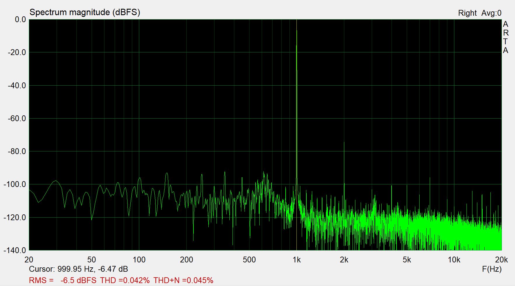

Let me tell you more. Below you can see my recent THD+N measurements of smaller A60 with just 2X22.000uF per rail. Observe how low is noise floor. With capacitance multiplier it is much lower.

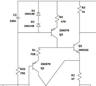

This measurement was with KSA992/KSC1845 transistors which aren't adequate according to my measurements. With CDIL 2SA970/2SC2240 the THD-N value is half lower-
Also observe THD measurements. The 2nd harmonic dominates whilst the 3rd is far below audible. Such a mixture of harmonic distortions makes this amplifier sound indeed pleasantly.

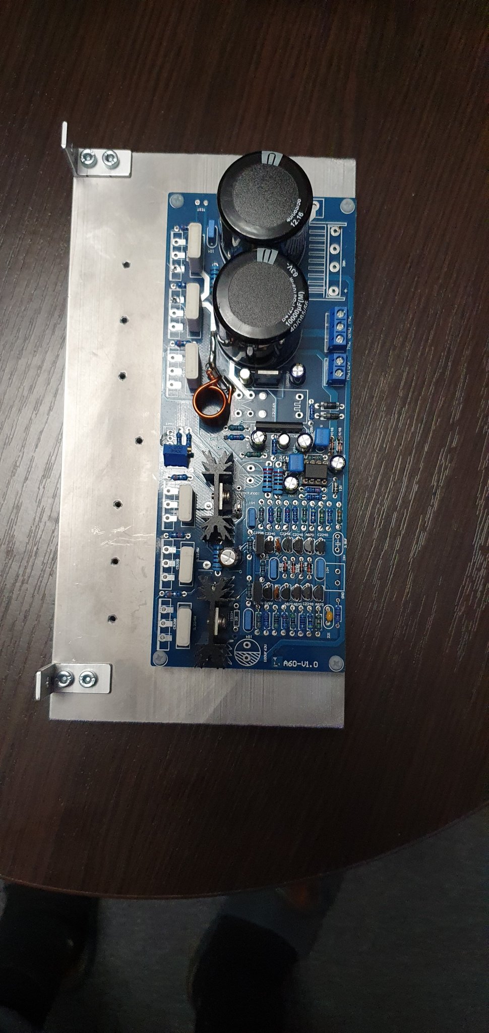

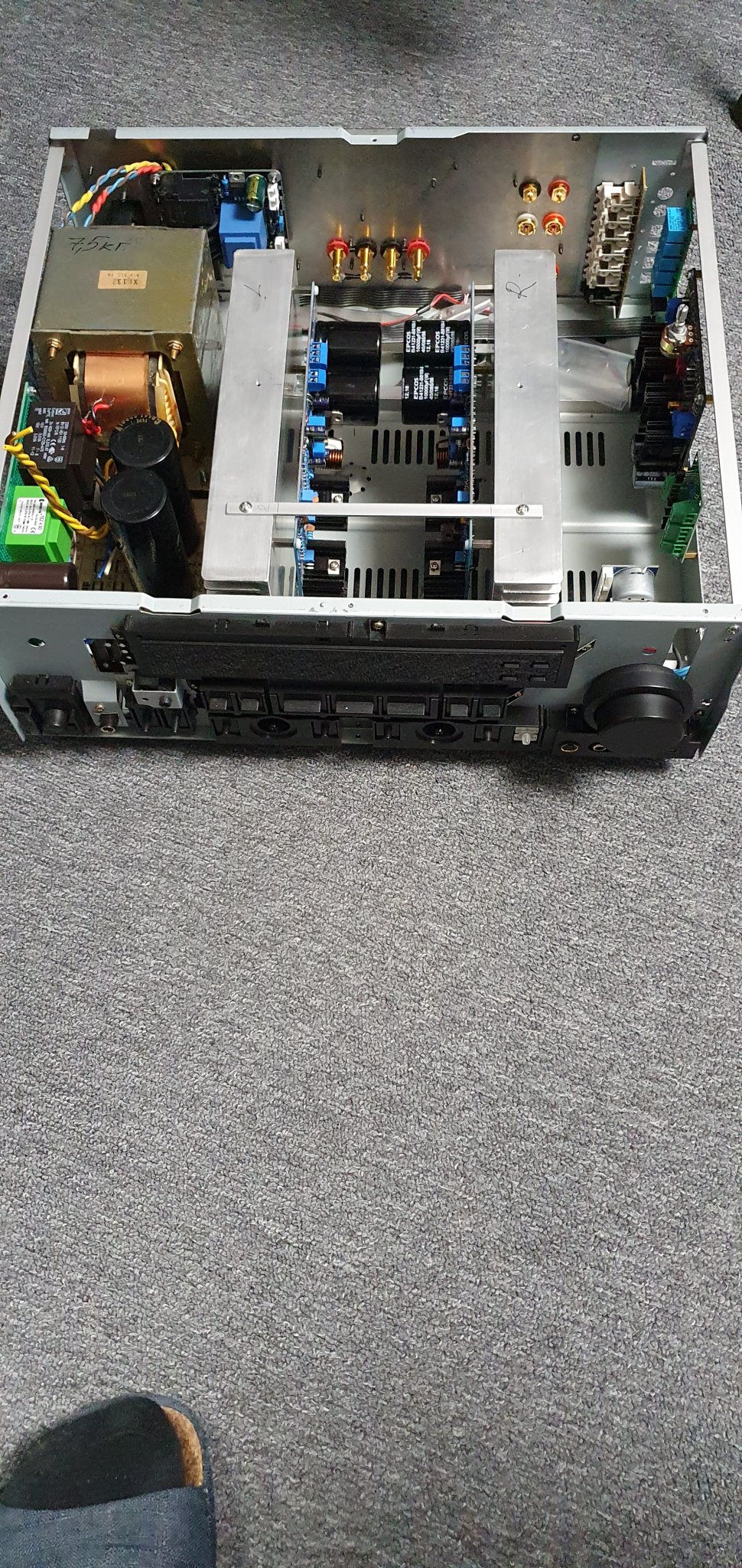

PCB size: 273*88mm.What is the minimum size of a radiator that can be used? There is a finned 200x70x30mm. Enough for each channel?
Add to that enough room for output transistors. Also, when biased into A class there is a great deal of heat.
I am using Fischer Electronics SK 56 L=300mm, H=200mm, W=40mm K=0,31W/K
