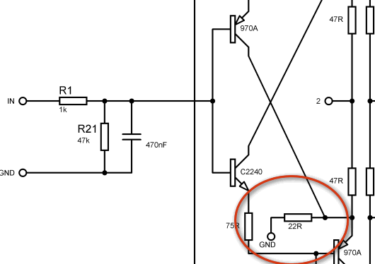

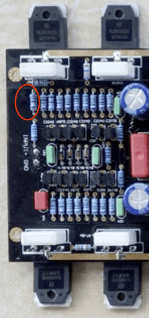

Remember, you had R21 resistor with 22R value instead of 100K. This must be some systemic error because it appears on the both channels. My moto is: if you want to know how many teeth a donkey has, go to the stable, open donkeys' mouth and count. Some people might open The Holly Scripture to find the truth, but the truth is in a donkeys' mouth.
You can easily verify values of every resistor on your boards. Other components too.
PS: An alternative is to put some known voltage at the input, 1VAC 50Hz, for example, and measure the output as VRMS with your multimeter. Then you can calculate amplification factor. You may do that with different voltages at the input.

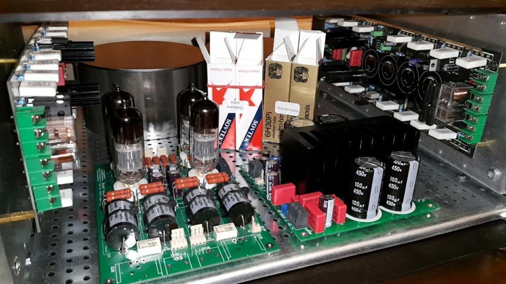

While browsing the internet, I noticed that you are moving the thread of the Chinese clone Accuphase A60 ++ amplifier. I have the V 1.1 versions of the tiles. similar to colleague "vmk2002".
In my case, the topic has been dragging on for several years (due to the lack of time) and it will be something similar, but based on an additional version of the preamplifier, i.e. a 2 in 1 hybrid (amplifier + preamplifier "PANA-MERA" - HYBRID POWER AMPLIFIER / PREAMP TUBE NOS , CLASS A / AB).
In the near future, it will be equipped with additional components and functional functions. You will see for yourself as soon as I motivate myself to act (these are my plans for this year 2022).
The potentiometer will definitely be different than that of my colleague "vmk2002". It will get really tight inside the housing.
As for the capacitors used, I gave up Chinese products in favor of Rubycon 8pcs x 10000uF / 63v, diameter 30mm (made in japan) due to the quality and limitations in the DISSIPANTE 4U - 1NPD04400N metal housing.
I could use Mundorf M-Lytic AG MLGO 10000 uF 63V capacitors, 30mm diameter, made by the German producer FTCAP Fischer und Tausche Capacitors - FTCAP GmbH, but I decided to spend the savings on capacitors on parts for my new DAC.
Below is a photo of partial assembly works.
greetings
Thomas_XLR

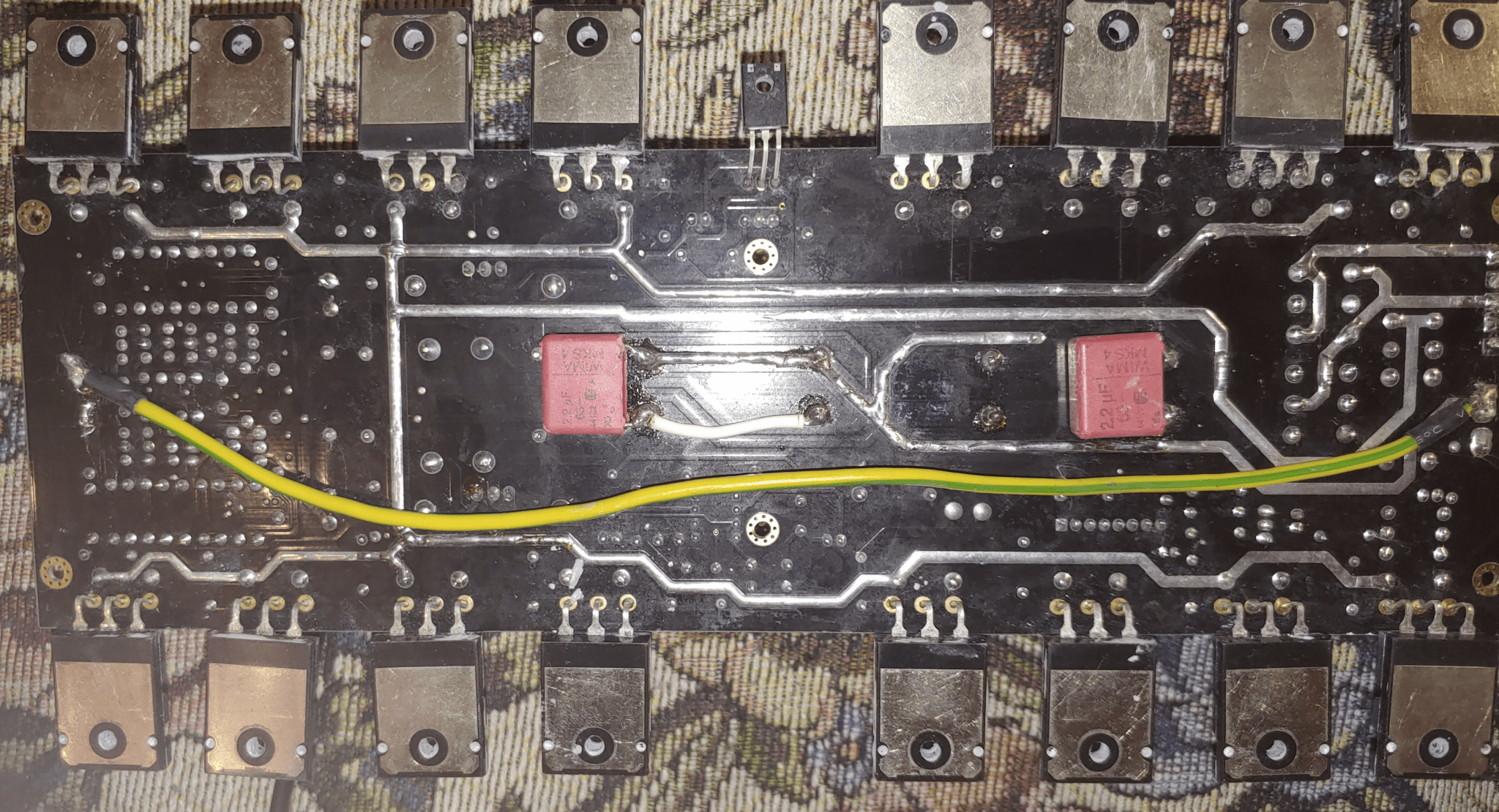

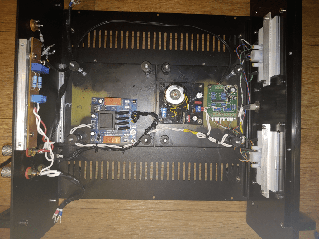

Hello everyone! I took advantage of the long weekend and completed my power amplifier. At the same time, he took advantage of new knowledge:
1. It is necessary to phase the power supply of the transformers. In simple terms, all transformers are first connected to the network with unconnected wires of the secondary windings. The voltage indicator (indicator screwdriver) should not light up when phase L is correctly applied to the primary winding. Thanks to Prophetmaster.
2. Perhaps I have problem boards, but most likely this is a curve layout of the boards from the Chinese. It was expressed by noise in the high-frequency speaker and low-frequency speaker (obviously noise due to unstabilized power supply - 50 Hz). The soldered wire from IN GND to OUT GND helped. Moreover, it is important that it must have only 2 soldering points - at the ends! I tried 3 points (one of the tries on the GND capacitor of the power supply), the desired effect was gone.

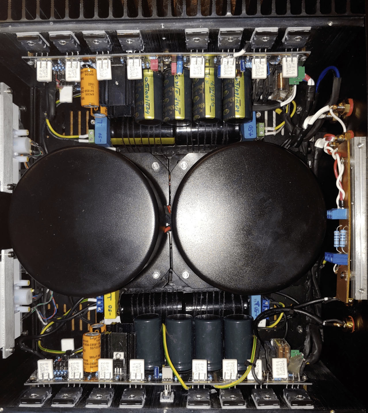

The photo shows a two-story structure: soft start boards, indicator control boards, a power supply for the indicator board are on the first floor, under the transformers. Additional condensers have been added to the first floor.
In total, the view inside took on the following:

Hello to all! I compared my circuit and the circuit according to the link from the respected thomas XLR and noticed a significant difference in my opinion. This is the resistor outlined in red (picture below):
The value of this resistor is in fact 22 Ohm, and 33 Ohm is signed on the board. I unsoldered it, and noticed that the gain of the power amplifier dropped (it became equal to 1). I wondered if it was possible to select it in such a way as to obtain a gain that would result in a minimum of distortion and less noise in the absence of a signal (note that it is practically impossible to hear noise in the absence of this resistor, even if we put our ear close to the speaker membrane). Why don't the Chinese depict this resistor in the diagrams?
