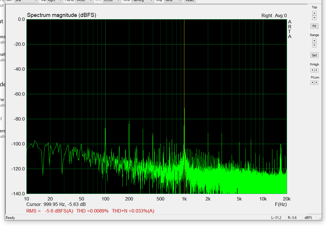

Sorry for the delay. I didn't want to repeat myself or provide what's already known.Your measurement seems done at 5V/div so slew rate must be around 30/1.25=24 V/uS right? Have you managed to sim or measure THD at 1kHz and 20kHz respectively? Can put some more measurement data please? Did you manage to sim phase margin, open loop stability etc?
First, one clarification: I do not simulate, I measure. Not because I couldn't but because I think I really understand the purpose of simulation.

I have used signal generator of my oscilloscope and connected it directly to the input of A60+ amplifier 1Khz, 600 mV p-p. As a load I have used three 22Ohm 100W resistors in parallel. In parallel to the load I have connected a simple voltage divider constructed on a piece of prefboard. Wiring was really done sloppy, in haste.
After some input calibration I have got the result below.
Take into account that this was my first THD-N measurement, on a crappy hardware and in haste. Yet, according to FTC, the result can be conditionally considered as HiFi. (...less than 0.02% total harmonic distortion...).

@Berlusconi, thank you for your efforts in order to show some real world performances. I mentioned sims regarding phase and gain margin plots only since this department is not going to be easy for plot. Additionally, simulation helps to optimize compensation scheme in order to improve slew rate performance.
Next time, can you give more precise info on measurement conditions please? I think that input level has not a significant importance on THD measurement. Output swing level and load (which is 22/3) has much more importance.

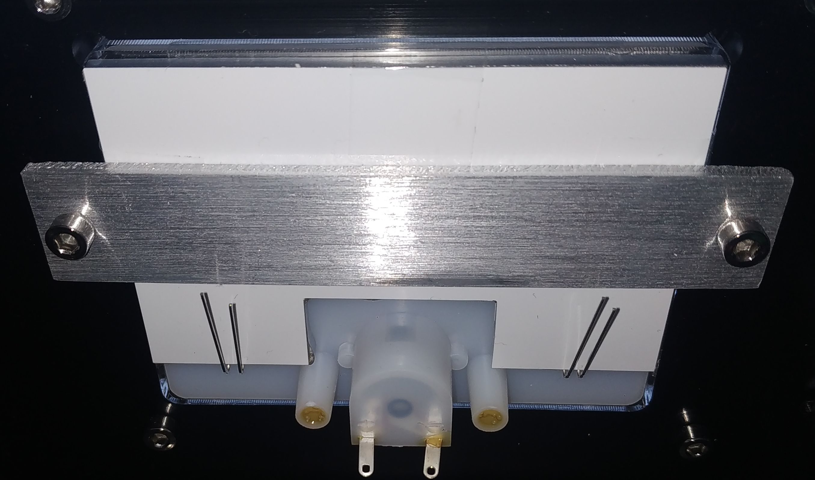

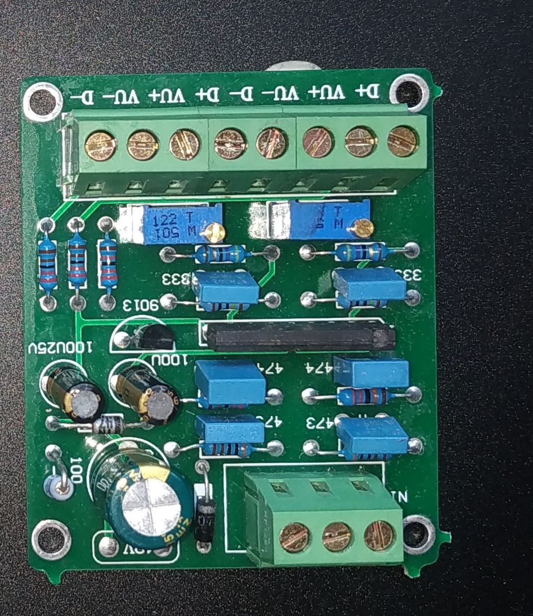

🙂 Hello. I ask for help. I figured out the soft start board. But I can’t figure it out with the dial gauge control board. Tell me how to connect this board to indicators? There are no markings on the indicators except as I understood +/- backlight supply. It is also not clear where to send a signal to the input of the IN. I attach a photo:
I figured it out a little more. The thin pins on the indicators to the left and right of the marked "+" and "-" are the backlight LEDs. I checked by measuring the resistance between these leads and they lit up. It remains to understand where and what voltage to supply power to the indicator control board.
Bought from weiliang audio Official Store. The Chinese did not answer my connection question. They do not have a connection diagram on the site.

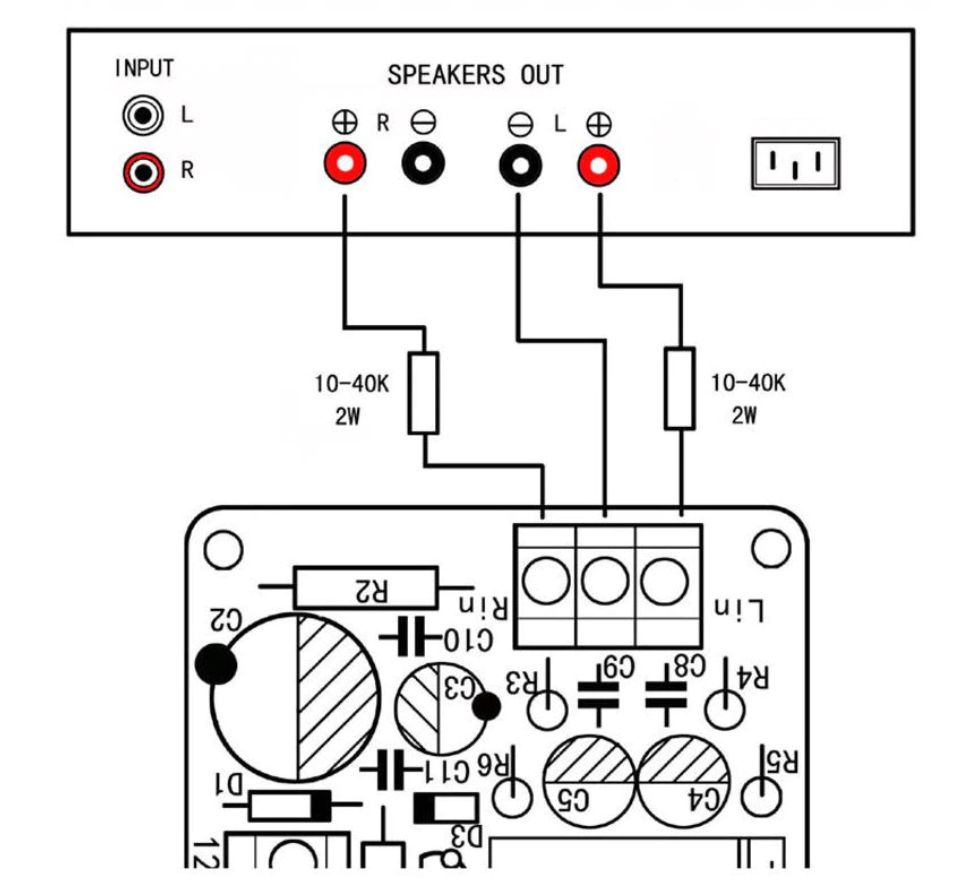

Now my only question is how to connect this board to the output of the power amplifier. Each channel is powered through a separate transformer with two windings with a midpoint. Therefore, I cannot figure out how to connect "-" from the outputs of the power amplifier to this board, since this board has only one "-" input and two "+" inputs for the left and right channels. There is of course an option to connect to the input RCA connectors, but I think that there will be distortions of the input signal of the power amplifier.
Everything is there, do not worry, carefully study the photos below on the site, if you give prompts, you will not understand anything, you have to try to delve into it yourself, otherwise there will always be a lot of questions.😉🙂

The boards sold on aliexpress have 2 types of signal connection to the indicator control board. Option 1 - directly from a sound source (CD, DVD). Everything is clear with him. Left / right channel and GND. Option 2 - through a 10kOhm ... 40kOhm resistor from the output terminals of the power amplifier ("+") to the input of the indicator control board (L_IN / R_IN). And where to start at the GND input? After all, the left channel is not galvanically connected to the right channel, so the power amplifier channels are powered from different transformers (2 separate transformers, one per channel, each transformer has 2 windings with a midpoint). This is the only misunderstanding so far, since I want to use option 2.
Do not connect it to the input otherwise it will compromise sound quality. From the attached photo it apears that the board has overvoltage protection. Correct me if I am wrong but there is UPC1237 in the middle of the VU board. Also the amplifier has speaker protection. You have to connect it properly and adjust sensitivity on potentiometers which are located at the board.🙂 Hello. I ask for help. I figured out the soft start board. But I can’t figure it out with the dial gauge control board. Tell me how to connect this board to indicators? There are no markings on the indicators except as I understood +/- backlight supply. It is also not clear where to send a signal to the input of the IN. I attach a photo:
However, try to test it on something cheaper, some old PC speaker or test it with batery and voltage divider to prevent overvoltage.
PS: I think that's really simple. Could you please provide photos of the board from different angle and read what is written on that long black bar in the middle of the board. I suspect it is UPC1237.
