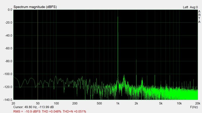

Below you may see a single measurement of a smaller sister of A-60 amplifier, with "just" three pairs of output transistors. The snapshot represents this amplifier in the most adequate way. First note that THD is larger than 0,02% but the distortion is predominantly 2nd order whilst the rest of harmonics are below the audible region. At lower power the 2nd order distortion also vanishes below the audible region. This characteristics, the absence of harmonics above the 2nd, makes the sound pleasant. Also, response to square wave produces almost ideal rectangular shapes even at as low as 10 Hz. This explains why this amplifier has really good, clear, solid bass, exactly in the same octave as it should be. (To me some other amplifiers sound hollow because their bass sounds like it was transposed into a higher octave). This one keeps the bass exactly where it belongs - down. (Please note that I avoid the term "deep bass" because bass is as deep as it is, just some amplifiers tend to reproduce it an octave higher.)
There is however a shortcoming: beautiful sound is limited to about 11 Vrms into 8 Ohms. From this point on, the amplifier departs the class A region and the distortion starts to increase. It is possible to extend this region of pleasant sound but it isn't worth it because the increase of the quiescent current above 200 mA requires substantial heat sinking.
People may find this phrase highly discouraging since the amplifier in review is a Class-B amp thus it must be exhibit its actual performance in Class-B region. If not, it means that this amplifier suffers badly from crossover distortion.
Thanks Terra for this important remark. Could be worse above, say 20 watts , but from the very beginning I've planned to scale this down because I don't need lots of power, my intention is rather to extract the best sound from it. I have tried it with just a single pair and it works well. It sounds and measures too like JLH amplifier just has much better bass performance. I don't skimp, just want to make rational design decision that suits my needs. I don't intend to provide amplification for Wembley stadium, just for my room and a single pair of devices could be suited for the purpose.People may find this phrase highly discouraging since the amplifier in review is a Class-B amp thus it must be exhibit its actual performance in Class-B region. If not, it means that this amplifier suffers badly from crossover distortion.

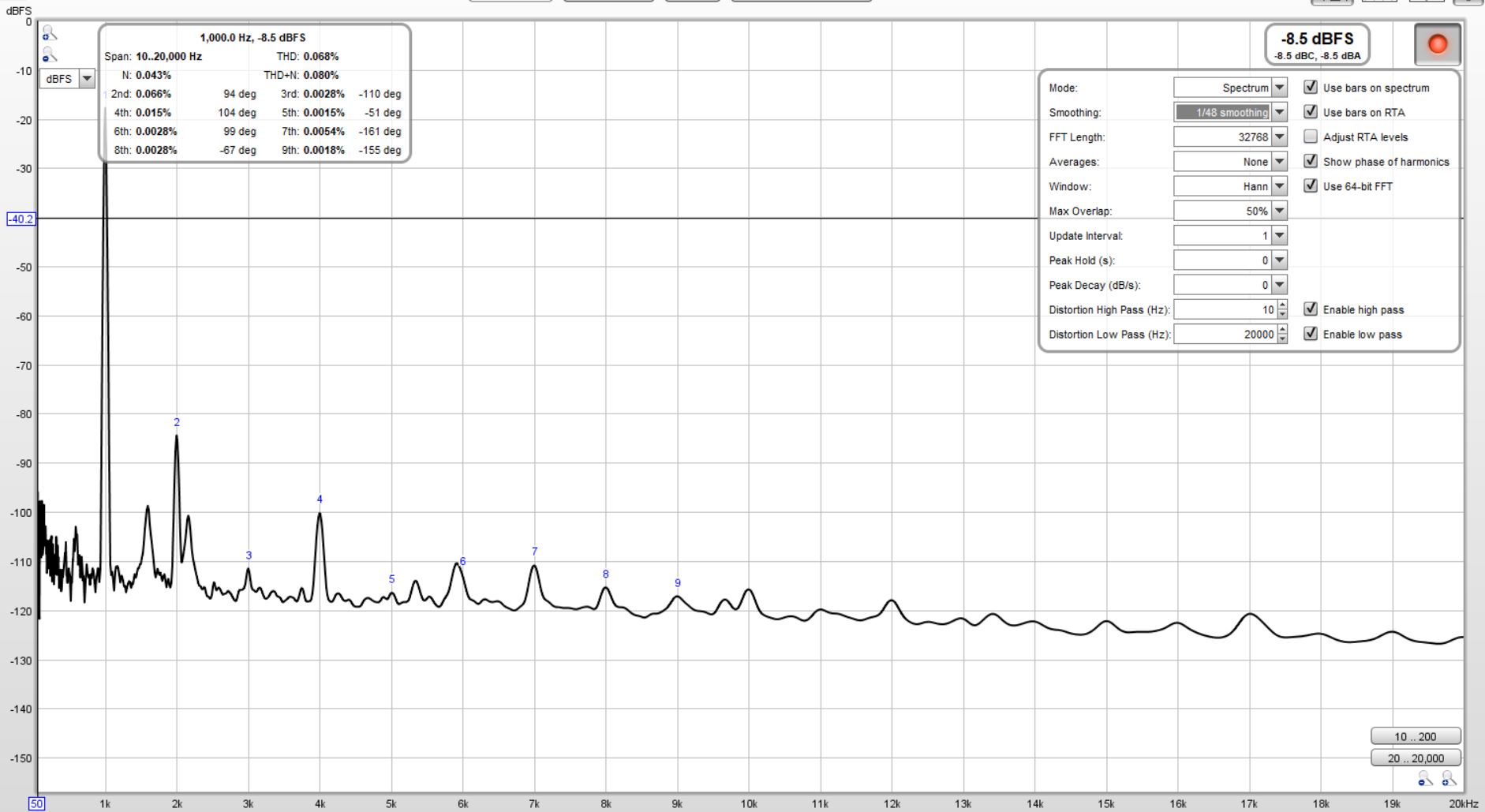

Now, thank you again. Without your initiative I wouldn't have even tried to extract more than just 20 watts of fine sound from A60. After your remark I have tried again, this time with +/-37V rails and look at the pleasant surprise below. 50 Watts of pleasant sound into 7,5 ohms (perhaps even more but I didn't want to go further this late in the evening). Just look at the distribution of harmonics: the 2nd dominates, the 3rd is almost non-existent and the 4th is just at the border of audibility. Again, this explains me why I loved the sound of this amplifier from the first moment. It creates just a mixture of even harmonics. Slowly, I will understand what mixture of harmonics sounds pleasant to my ears.

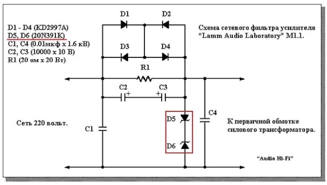

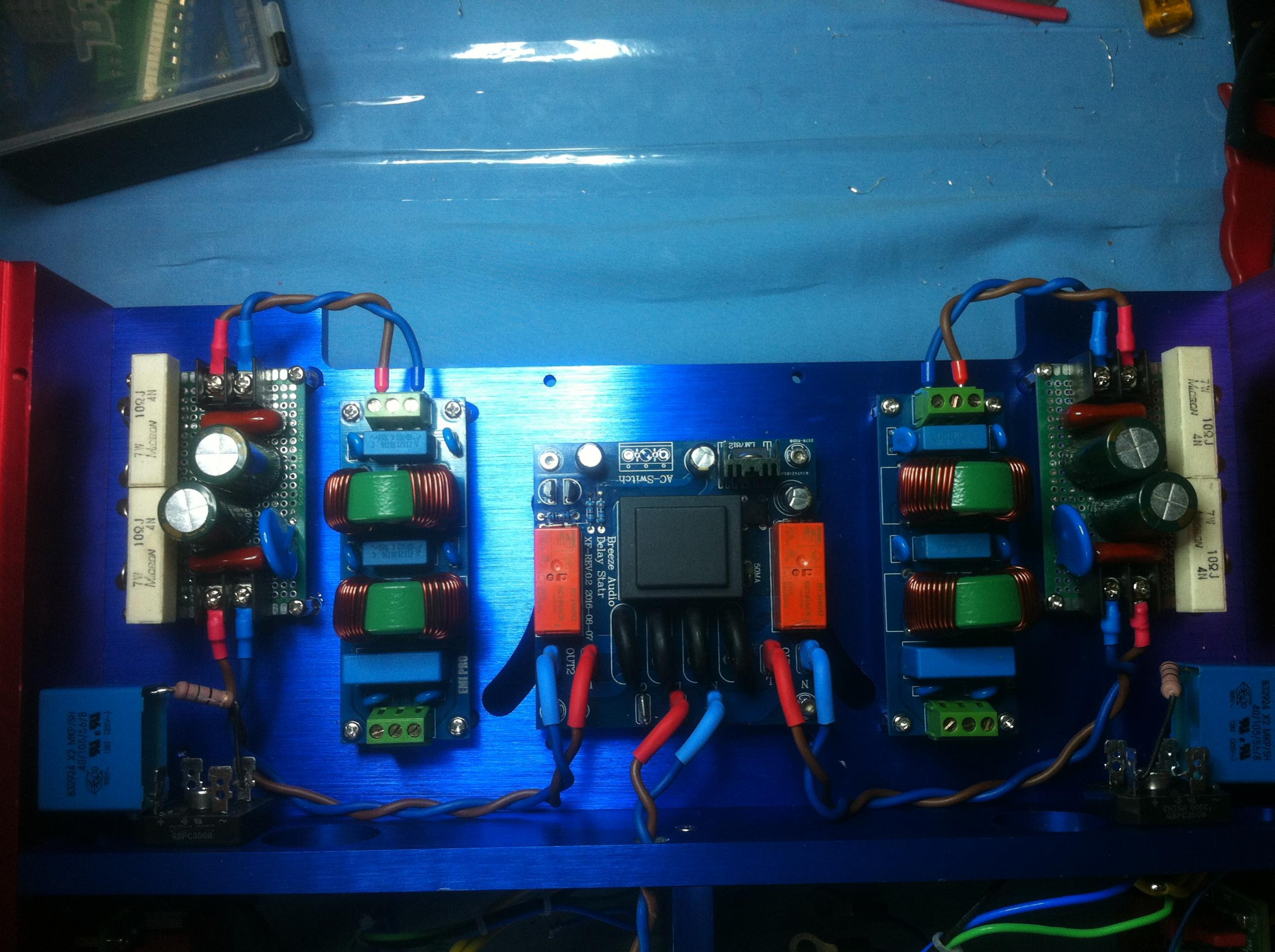

Hi Berlusconi. I respect your opinion. But I asked a little about something else. I have a problem like this. Transformers hum, and you can hear it if you are near the amplifier case (I'm not talking about sound in acoustics). On the forums they write that this is possible due to the presence of a constant voltage in the 230V alternating current network. Google translated my question incorrectly. So, there are special filters, for example:
AIYIMA 2000W 15A EMI Power Filter Module AC110V 265V High Efficiency DC Power Supply Filter DIY Audio Sound Home Amplifiers|Amplifier| - AliExpress
Have you ever used one? Maybe someone from the forum participants will say for and against such filters. I will be grateful.

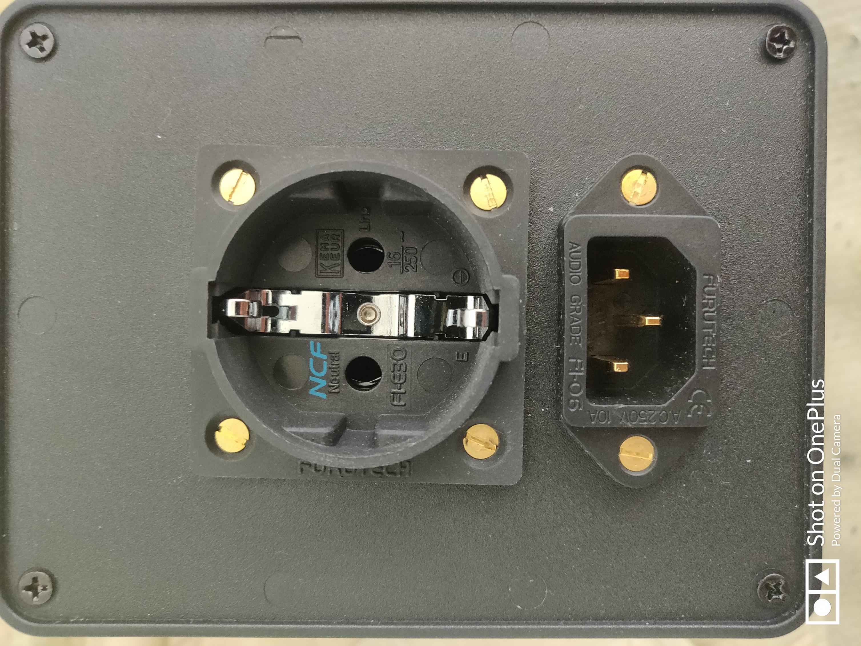

DC blocker
To stop humming transformer because there is DC on the mains you need something like this.
https://www.hifisentralen.no/forumet/attachments/img_20210209_122457-jpg.696186/
