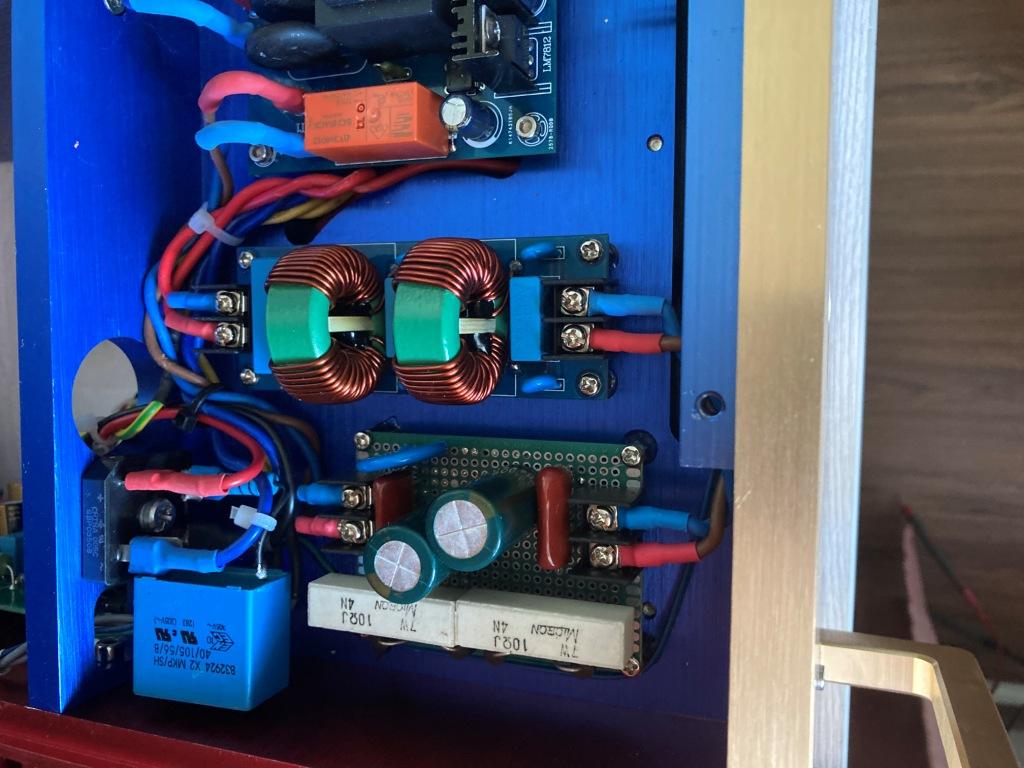

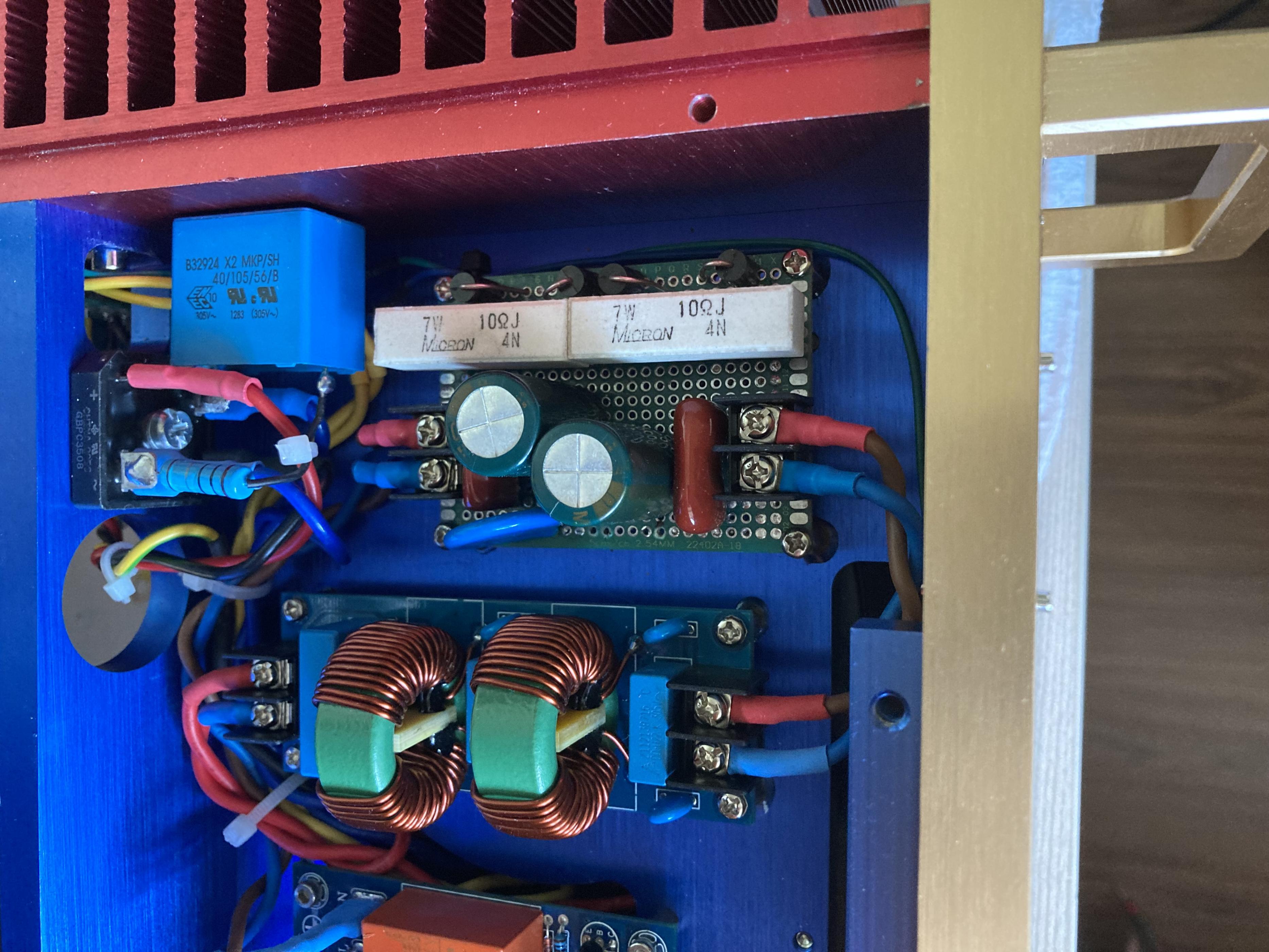

Erlend Sæterdal, hello! I want to ask this question. Before using a line filter with DC cut-off function, did you have problems in the form of rumbling transformers? By the way, the filter with Aliexpress, to which I gave a link, helped me in solving this problem. I just had to replace the 2200uF capacitors with 10000uF. Moreover, this filter works only with one position of the plug in the outlet. Does your filter work in any position of the plug in the outlet? Berlusconi until he took your advice. I want to clarify, according to your advice, as I understand it, will 1kOhm resistors of minimum power be suitable? (I don't hear the noise of the torus now, but I can still hear it in 50Hz acoustics, I will fight). It is also very interesting which preamps you use. So far I bought this one:
https://aliexpress.ru/item/40009314...43.1544783349.1626670217-552916735.1579052756
But I want to replace over time with something more interesting. In search of. Advice from passionate people would be very helpful!
PS: My filter:

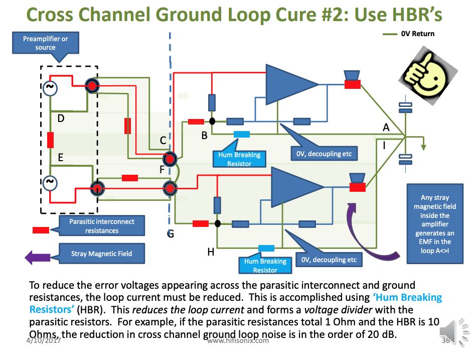

Now, regarding resistors: that 1K resistor may be any low wattage. Currents are very low there. In addition to that you may add an additional resistor with value between 4R7 and 10R to serve as hum breaking resistor (HBR).
Let me explain this with a diagram below which is taken from a presentation at hifisonix.com.
In the middle of the scheme there is a point denoted with letter B. Your 1K resistor is located at the vertical line connecting point B with input of the amplifier. Now follow the line going from point B towards the HBR resistor. Simply connect the HBR resistor between the point B and GND at the terminal for speakers. Ground of the speaker is connected to a star connection on the board. This should reduce hum further to the minimum.

Sometimes my transformers was noisy yes. But my main reason for implementing DC blockers is better sound. More detailed treble and more punchy bass.
