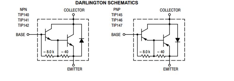

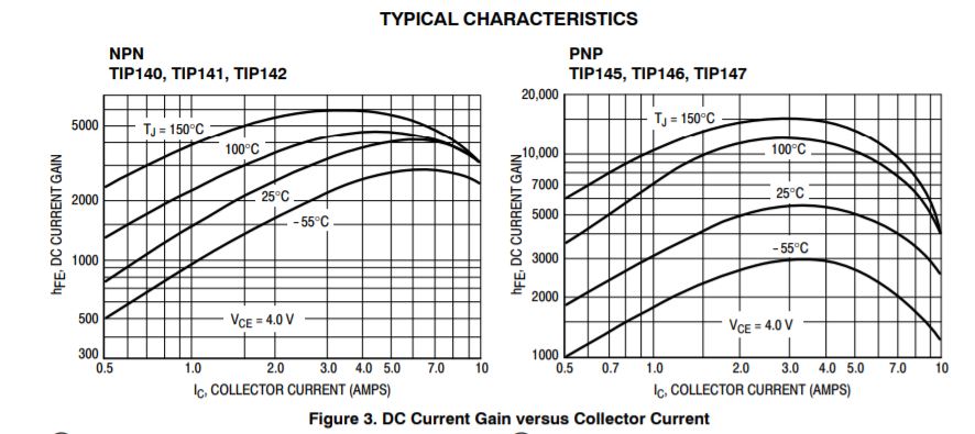

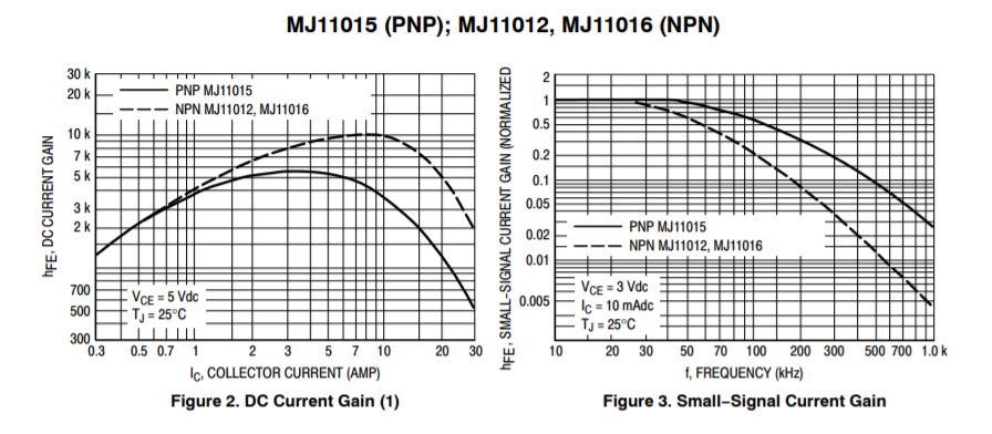

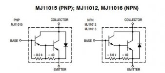

I'd rather choose two pairs (if they are TIP 125W darlington) - for a 4 ohm load.
For the my small AB100 I used 1 pair of MJ11015 / 16 200w transistors - output power approx. 55-60W @ 8 ohms and some 80-90W @ 4 at + - 37V DC ( 26,26 VAC ), so you can expect 60W @ 8 and 100@ 4 with +-39V rails.
i haven't heard what ab100 sounds like with TIP transistors but internaly they are similar MJ has higher gain, but MJ NPN and PNP gain is identical at 1-2A instead of TIP.

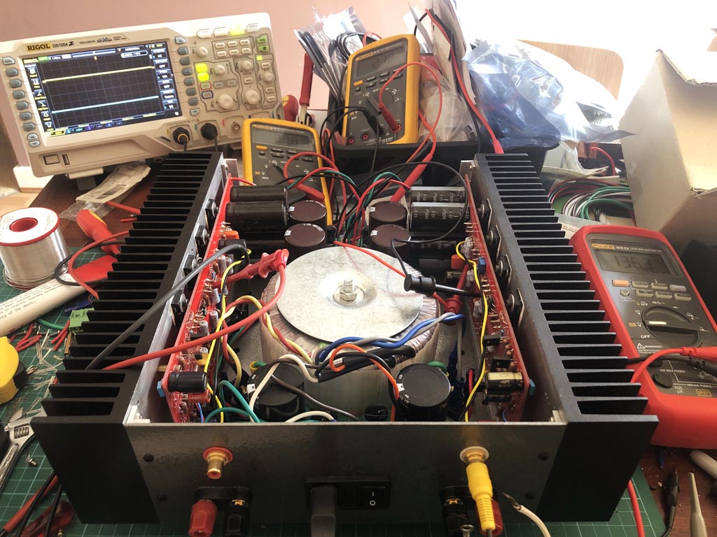

If I've calculated correctly it clips at about 120watts a side with 49V rails. I was expecting the good bass as others have said but I'm pleasantly surprised at the airy highs and imaging. A very listenable amplifier. Many thanks to Nelson for the circuit and to jwjarch for the boards.

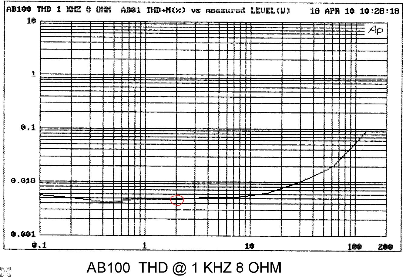

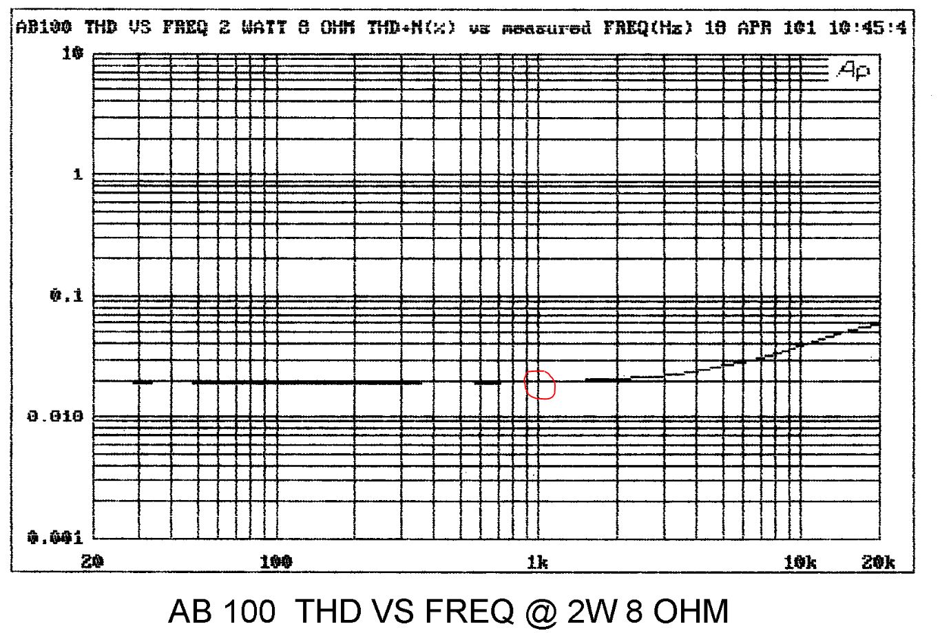

sorry - another question from me: what is the gain of your AB100? 36dB as original or less ?
Mine has 25,2 dB gain (r3=100R). According to LTspice - distortion pattern will be the same - they all will be lower with lower gain.
But if we look at the first NP post - there is some differences in posted graphs ( see attachment - distortion 1Khz @ 2W)
With 36db I can't achieve it in the simulation - it's higher (0.01 or 0.02 @ 2W @ 1KHZ)
But with 25,2dB i can get these 0.006%...
It doesn't matter - it sounds great :D

Hi Osscar, I increased r3 to 1K as you had suggested and I get 25 or 26db gain. I can't remember the exact number.
Hi jwjarch, I placed the extra caps on perf board. Overkill but I had them around. The channels share the first 30,000uF on each rail then I put 2 x 6800uF per rail on the boards.
