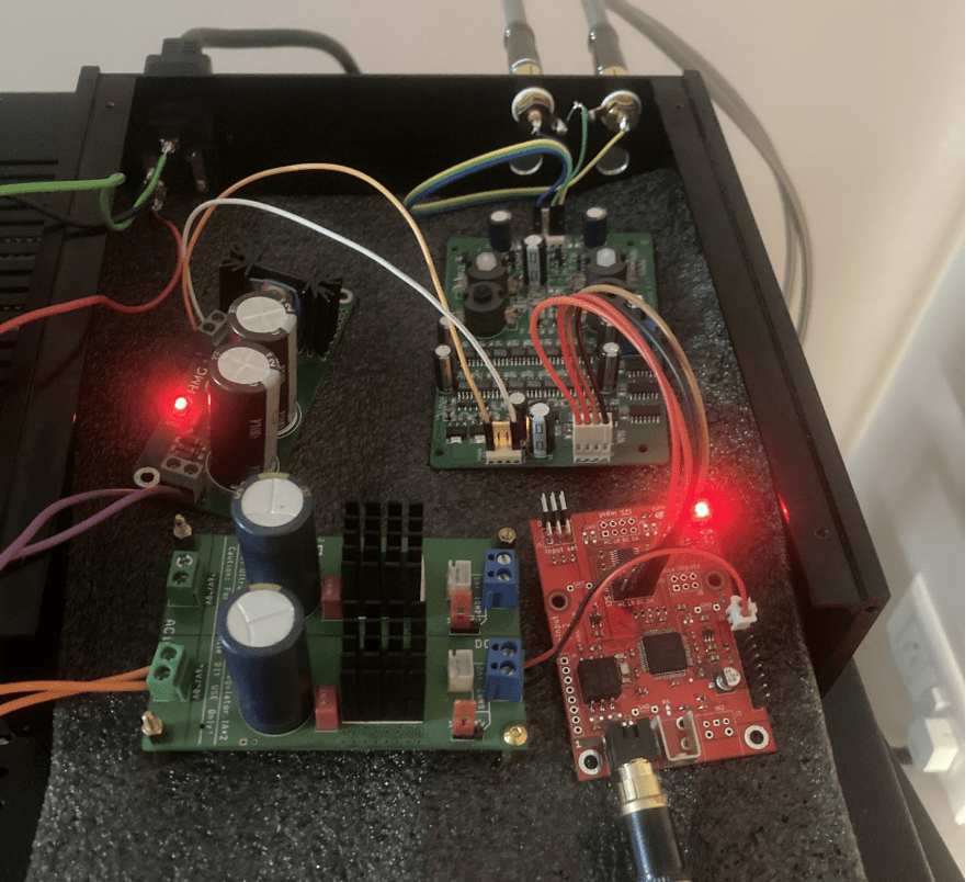

Received the Abbado II DAC last night and powered it up today just to test. Used some cheap jumpers to make connections and a simple PSU powering the DAC.
This DAC has a very dark background and initial impressions are positive. It sounded fantastic with the couple of songs i played. may be a good PSU and Cables will definitely enhance things that its doing good already.
Thank you Richard for the great packaging and a fantastic DAC.

I did some detailed listening on this dac.
The tiny nuances are excellent. As @turion64 rightly mentioned earlier the dac is clean and has a black background which I feel can be further improved with a better psu.
I did power the Deca from Richard earlier using Salas Ultrabib and it made tremendous improvements and I am sure this one too would benefit from a good power supply to a larger extent.
The overall presentation is warm and yet quite detailed. Can hear those tiny details and that makes this a perfect companion for a fatigue free long listening sessions. The bass is good and fast. Noticed better bass depth than my Yiggy A1 but does not have a higher treble extension like the Yiggy (which the A1 is known for) which can get a bit annoying sometimes but this dac does not lack treble at all. It’s a total all rounder IMO and I felt this to be a good addition to the PreCeeBee V5.

Your impression is that Abbado II sounds like Schiit Yggy A2? If so, that would be quite an achievement.

Yeah Richard. This one indeed sounds exactly like the A2. Has the same level of sound I am unable to differentiate between the two. This is good news atleast for me 😁.Your impression is that Abbado II sounds like Schiit Yggy A2? If so, that would be quite an achievement.
Hi @turion64 and @Destroyer OS , I actually had the chance to compare Richard's DAC against my friend's Chord Hugo (not Hugo II). I have owned Richard's Celibidache TDA1387 20x TDA1387 NOS DAC which shares similarities to Abbado II. Celi has 20 chips while Abbado II has 24, also the Celi has a 9th order filter instead of a 5th order on Abbado II. Regardless of their difference, Richard said that they are similar, though Abbado II has better SNR.Would you prefer the term uncolored, or maybe "calm"? I've heard many unexciting DACs that really don't provide a positive listener experience...I would term them dirty. My use of the term "clean" refers to the the blackness of the background maybe. You can hear more of the nuances of the music because of the blackness. The projected sound is intermediate between speaker centric & forward projected out into the listening area. Does it beat a Denefrips or a Chord? Can't state that since I own neither (but I'd like to.. ;>)...)
