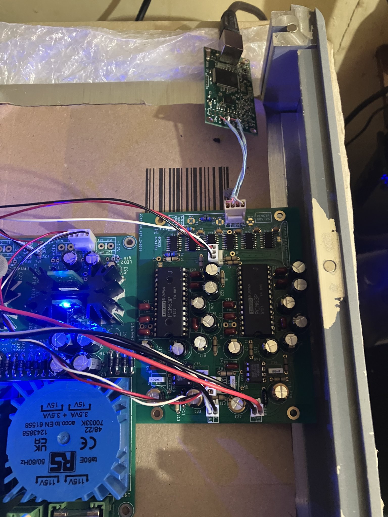

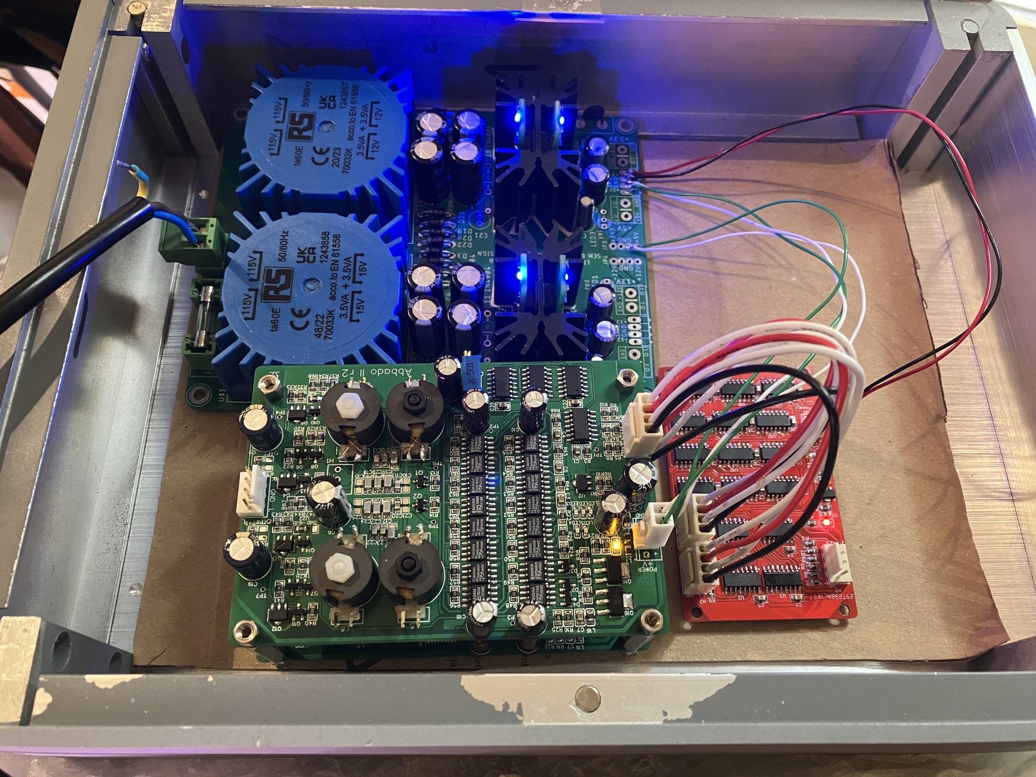

Finally got the PSU together, everything is working fine. The PSU board was designed by Prasi for my needs and uses DEXA discrete regs by NewClassD of Denmark.
I will be using Meldano's Muses volume control with this DAC in balanced mode, so a DAC / preamp eventually.

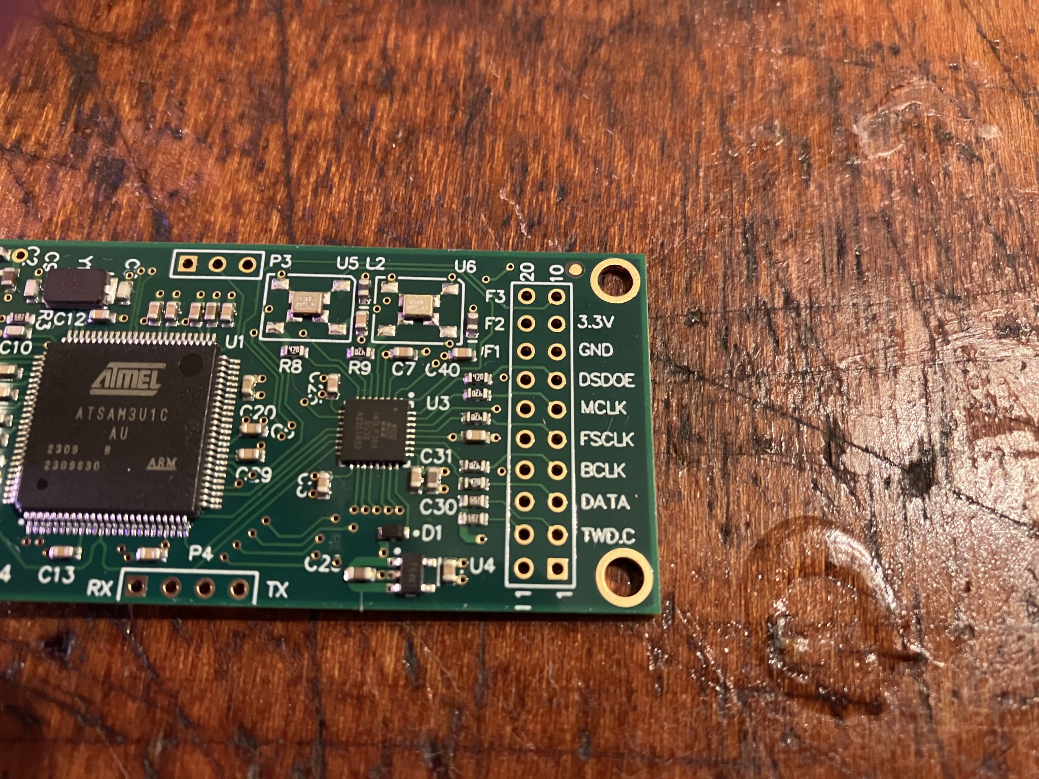

@abraxalito can I check - on the Amanero USB module, does MCLK or FSCLK correspond to LRCK on the DAC?

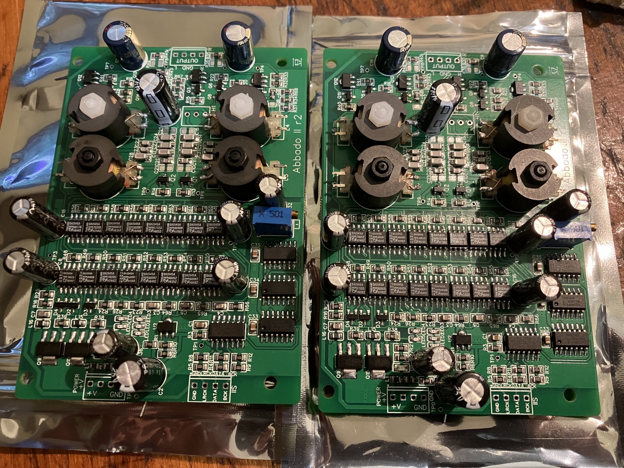

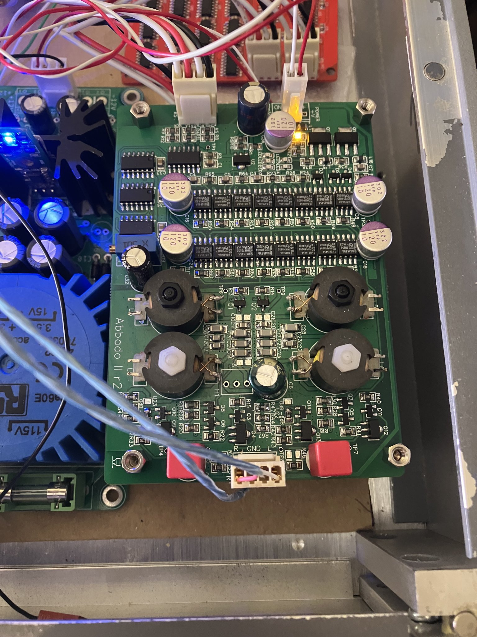

Hello all, had a break but just got round to setting up my balanced Abbado 2 DAC again. ( @abraxalito, is this named after Claudio Abbado? )
Previously I encountered a problem with the phase splitter module causing a channel malfunction. I can reassure Richard that his kit works like a dream. My previous scare was clearly an issue with hot swapping or such, just being careless I guess.
Haven't messed with the output trimmers yet, everything sounds fine but will check. I will need to reduce the gain somewhat.
Richard - I re-read your previous post regarding setting gain, if you can post the formula or give values, certainly half the current output would be fine (Higher value resistors? ) The op-amp stage is impressive, is this your own design?
All is very good, nice full sound from this DAC, balanced into Dynalo head-amp then Focal Elears.

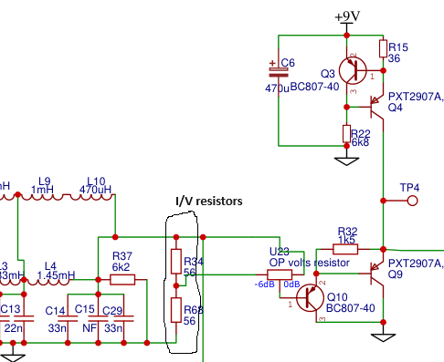

Here's the schematic portion of interest - the I/V and output stage of the DAC. I've highlighted the resistors which do I/V duty, they form a potential divider so its possible to adjust the output signal level downwards to any desired degree. The resistor values
shown there aren't those I fitted, I evened up the dissipation between the resistors somewhat rather than place almost none of the burden on R37 as here.
The total resistance needs to be 110R to match the LC filter. The function of R37 is for tweaking the total - (R34+R68) in parallel with R37 - to get a good match. The gain will be R68/(R34+R68).
An example - if you wanted 10dB attenuation (rather than 6dB provided stock) then R68 becomes 51R and R34, 110R.

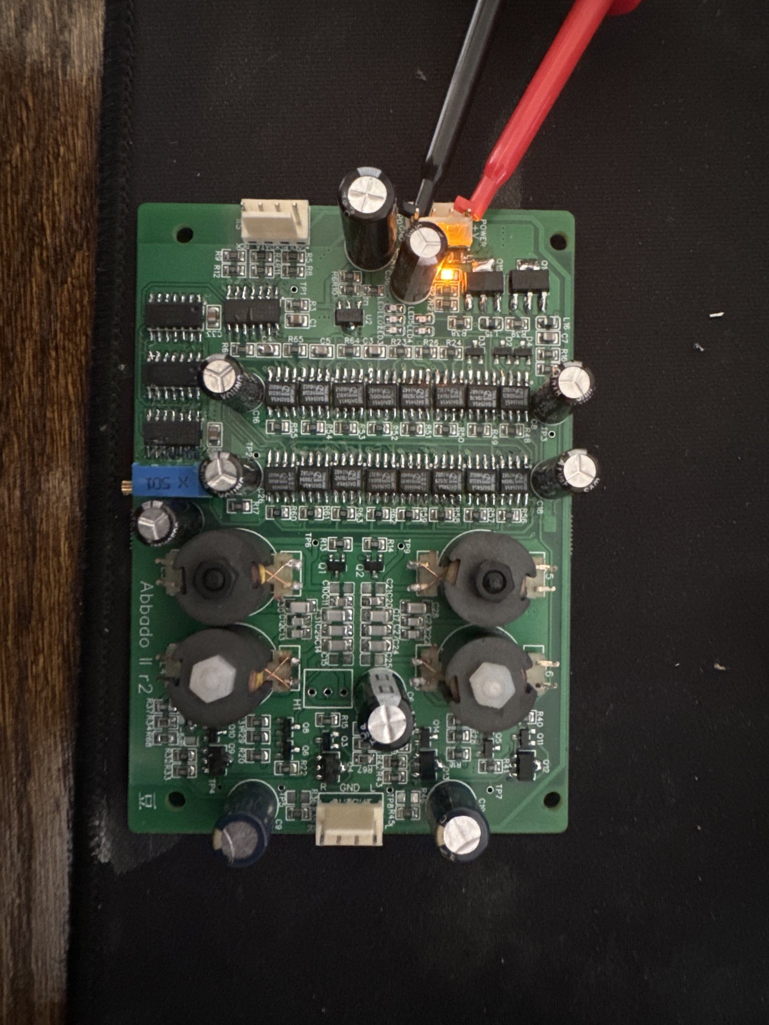

Just spamming the thread I guess, but had the chance to swap out the PCM63 for the Abbado again. Good to have it back.
Took the opportunity to try some different caps - SEP OS-cons on the DAC chip rails and some fancy Pana audio caps for the output analogue rails. All sounds very nice. To be fair Richards component choice is good enough. Changing the output FC's for film worked well, Bi-polar might be good here as they are in series with output.
Without caps one DAC board had around 19mV DC but the other was around 40mV, so the caps are needed.

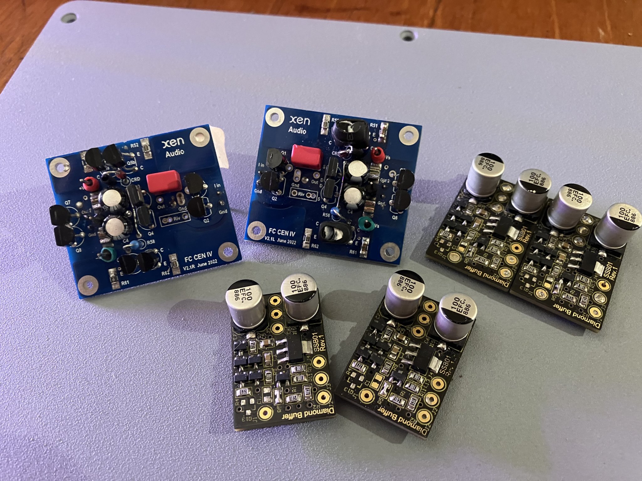

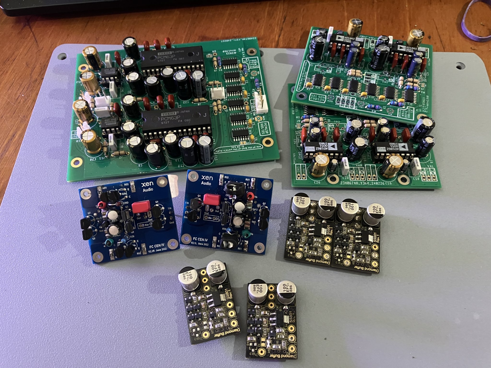

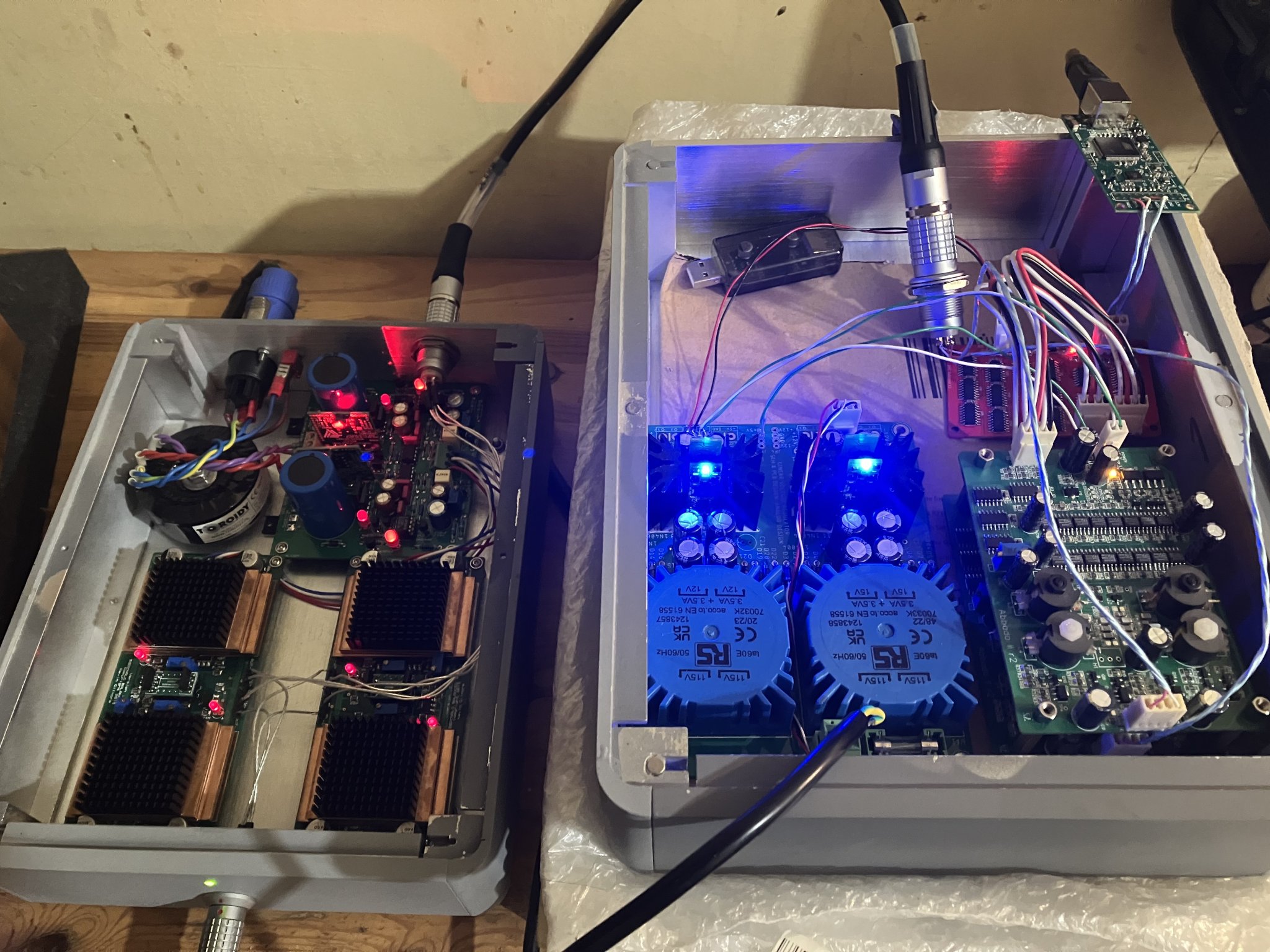

Got a pair of CEN I/V boards to try with Miro's DACs, in the picture below are the excellent Sjostrom Diamond buffer boards which may also work well. Need to reconfigure the PSU to run all this.
Miro's DACs turned out to be expensive to build, I hope I can get the best out of them, but the the Abbado is already hard to beat. For the money it's a hell of a good DAC.
