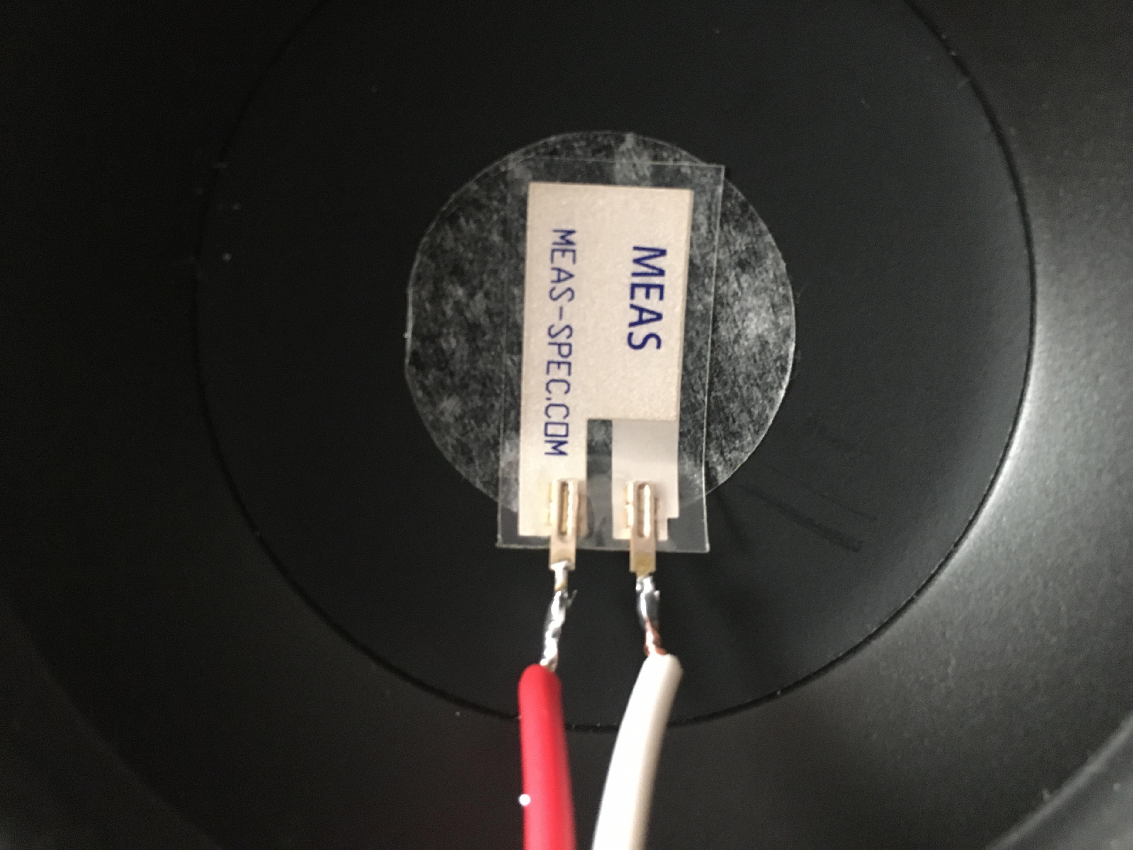

Hello Pano,
What kind of preamp circuit are you using withe the piezo disk? And what is the piezo diameter? Piezo disks come in a wide range of varieties, hence my asking.

The disc is approximately 24mm. I have been using the instrument input of my Behringer UMC204 which has an impedance of 1 meg ohm. I have also used them with a Zoom recorder but it has lower input impedance, so less bass. The DI that Remlab found looks like a great idea to buffer mics like this.

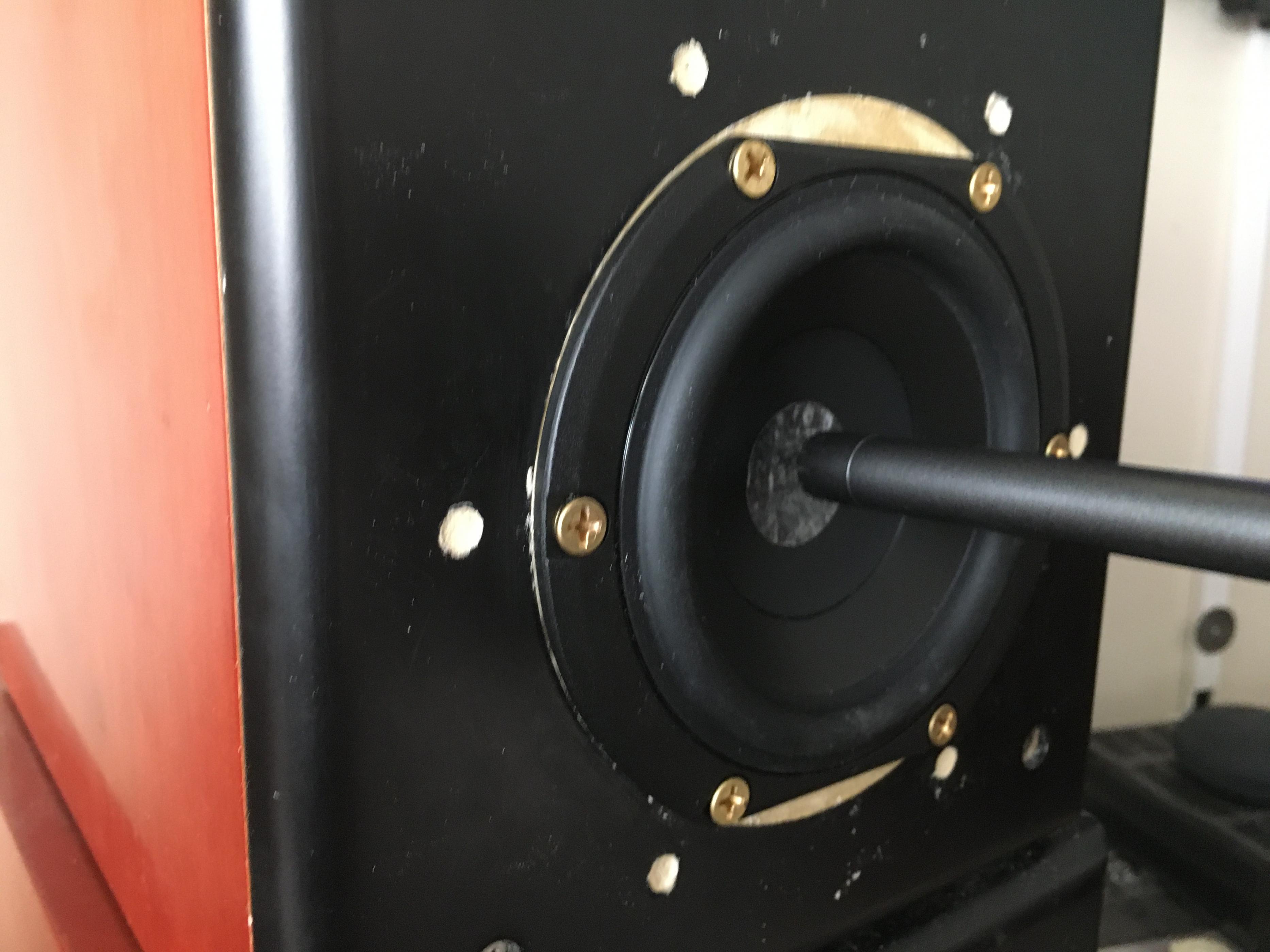

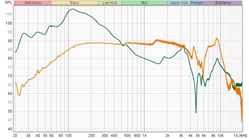

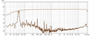

Okay, I have graph with pictures. First the graph. Remember that the linearity of my accelerometer, buffer system is extremely flat from 50hz and up which was shown in previous graphs.
Orange- Mic at 1"
Green- Accelerometer on cone with extremely thin double sided tape. I also made sure that only the accelerometer is touching the driver. The wires are being delicately held away.
I will obviously take any advice if I'm doing something wrong🙂

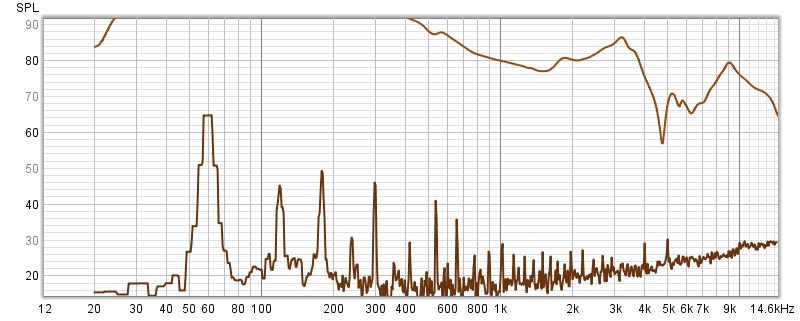

The last graph is signal vs noise on the cone accelerometer measurement, to show that noise is not effecting the measurement. I had to do the wires unshielded so diaphragm movement would be unimpeded.

Thanks for the measurements. That looks very different from what I got. I did mine on the cone proper, but I don't think it would matter and long as it is well stuck. Looks like there is something hinky at 4.8K - may be best to ignore that, or smooth it away.
I'm not sure about theses piezos, but regular mic don't act like that, there aren't any super sharp peaks or nulls, so they can be ignored in calibration.

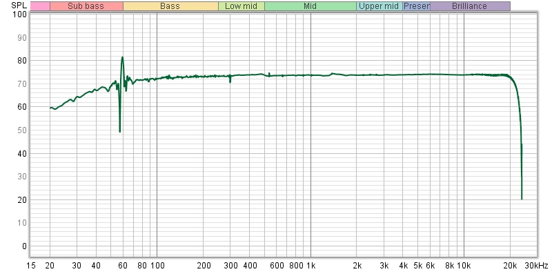

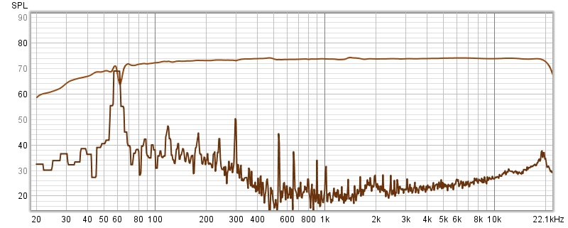

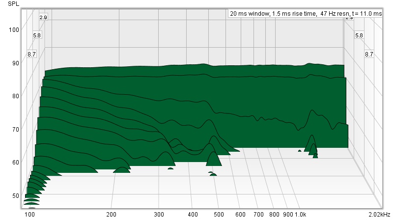

Linearity of my accelerometer taped to the cld speaker side panel. This is with the unshielded cable, so noise makes a small appearance at 60hz. I would have never dreamed that an accelerometer/buffer would be this linear. The second graph is a csd of the same measurement
