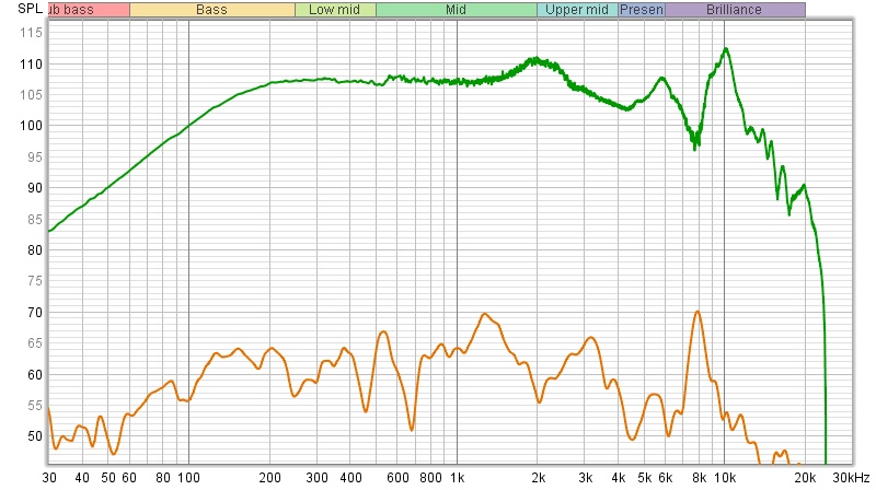

I'm pretty sure an accelerometer is a sensor attached to a known mass. But the PVDF is just a contact mic that senses vibration and turns that into voltage. Just like the ceramic disc I use. With accelerometers the math has to be done to turn its signal into a normal amplitude like a mic. At least that what the project linked earlier in the thread implied.
If your pickup were seeing no acceleration, wouldn't it have a zero output? But you measure far above zero on your waterfall graph. I could be wrong about this, the piezo does have to flex to generate a signal. Can it flex enough when taped to a box?
If it is sold as an accelerometer, then it probably does measure acceleration. It just does it indirectly by measureing strain (deflection). But yes, you are right in that it is not a traditional accelerometer.
It's a piezo pickup like the piezo discs, from everything I can read. It would need to be attached to an known mass to sense acceleration. Piezo generators are one of three types of sensors used in accelerometers, I think. An accelerometer can sense unchanging acceleration, like the 1g of gravity, or 6g in a centrifuge. A vibration sensor does not do that.
But what's more important than the name is "what signal does it output with no movement?" It looks to me like zero vibration means zero volts out (or maybe DC). When it flexes from vibration it generates a signal just like any other mic. The soundcard sees it just like any other mic, as does the software. Therefore if there is a level recorded above zero, there must be vibration.

Remlab - I went back to post 413...when you were talking about a vibration floor, I thought you were talking about a noise floor, but now I see what you are getting at. Pano has a good point here.
The piezo transducer generates an AC voltage signal in response to deflection, and it is possible that it is wired internally to perform the differentiation to go from deflection to velocity, and then again from velocity to acceleration. v = dx/dt, a=dv/dt... But that does not change the nature of the AC voltage signal.
Since you are using some kind of sound card or audio interface to capture the piezo signal, it is capturing the magnitude, frequency, and phase of the signal. zero deflection means zero acceleration, which means zero signal.
In post 404 and 413 you have interpretted the graph above 2 kHz to be the demarcation where zero acceleration equates to some nominal signal level, but I don't think that makes sense. If your sound card is capturing some amount of magnitude in the AC signal, does this not indicate there is some amount of deflection, velocity, and acceleration? I think it does.
In post 403 you show the Dunlavy response, there seems to be a "floor" (as you defined it) at about 70 dB. You are getting well defined structural resonance at 500 -600 Hz, from 85 dB all the way down to 50 dB. But this is well below the 70 dB "floor". If the floor was was truly a floor, you would be recording garbage below 70 dB, but that is not what you are getting... it is a a quality measurement down to 50 dB.
I am not sure why the response on YOUR speaker seems to flatline above 2 kHz. Perhaps there is so little structure-born energy above 2k that the piezo is only picking up acoustic output? or perhaps the double-sided tape is no longer coupled above 2k?

So this means what? A perfectly flat response from 1khz and up, from my panel? I'm obviously not getting something.🙂
Well yes, the almost ruler flat line above 2K is odd. But you don't get that with the other speakers. Jim and John confirm that what you see there is magnitude of the vibration.
I also wonder why it's so flat, and it's strange.
Under any circumstances, a 3/4" mdf panel will not measure better than any tweeter ever made(including decay). It's a physical impossibility, so something else has to be happening. This is why I took the "Vibration floor" argument, because I could see no other option. I'm sure the actual answer to this apparent conundrum is simple, but I don't see it🙂
I don't see it either. But hey, we love a mystery right? If we figure it out, we will have learned something. Maybe something important.

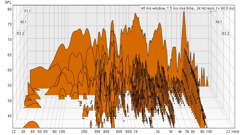

You might also redo the CSD ploy using a smaller time increment to see how the higher frequencies decay.

The next comparison is the graph above compared to mic measurement of the side panel(Null technique) in the exact spot of the accelerometer, Two mm from the surface. The trace above it is the actual driver measurement at the same distance. So the bottom trace can be compared directly to the CSD graph. The last is the acoustically measured side panel csd(null technique) which is even better for comparison. This is what mdf is supposed to look like🙂
Did the documentation with your piezo transducer give any kind of frequency range?
It is possible (likely) that the transducer is not valid above some cutoff frequency. I don't know about other industries, but in aircraft structures, we rarely measured vibration response above 2 kHz. And we always bonded our strain gages and accelerometers with epoxy (flight and ground test) or cyanoacrylate glue (ground test only). I am suspicious that double sided tape can work at high frequencies. It will almost certainly have some damping properties, and it may partially or fully decouple the instrument above some frequency.
We are mostly concerned with cabinet structural resonance below 1k anyway, so I would be comfortable in just ignoring anything above 1k...
