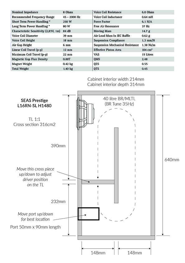

I've changed my design quite a bit - I'm attaching a picture. I've found the 5" SEAS driver, which I like and it seems to model really well in the size I want. This translates to the TL having a cross section of about 3xSd. The volume and port length are pretty good, according to the online calculator I used. Sensitivity is not a problem because I am going to do active.
The total height from end to end twice is about 47", but I am not sure what account I am supposed to make of the "going around the bends bits", so 45" might be more like it? Hopefully my drawing is clear.

The little SEAS I found stacks-up quite nicely I think. The Sd is 104 cm2 and the Qts is 0.45, VAS 19 litres. With the packaging that I want, which is basically a 250mm wide 650mm high 350mm deep box to go under a full range top section (comes out at about 40 litres, roughly) it gets a good BR tune with enough volume to play with to create a variety of TL shapes. The design I sketched eventually is quite neat and has a constant x-section of around 3xSd with quite a long line length.
I followed advice and joined the Quarter Wave Group, and Martin took a look and said "…it looks like a pretty good design. Bass down to about 30 Hz and a flat SPL response with 0.25 lb/ft^3 of stuffing."
I like the look of the metal driver and the size is cute and I think it will go well with an Alpair metal top section. I'm going to do active, so the low-ish sensivity isn't too much of a problem (Class-D watts are good value). Against a wall and with a A7.3 top section you could maybe do passive?
I'm only a beginner but I'm happy that I've got my head around the basic requirements, plus I've come up with a nice simple cabinet with bracing built-in. The driver can go near the top, because the line termination can be set by where you put the cross-piece, meaning that you design for optimum driver offset even though the driver is at the top of the cabinet. This puts lots of room directly behind the driver too.
No doubt it would be possible to go louder and lower with the same cabinet dimensions and a standard BR with a larger driver (8" would fit), but this design gets me as loud as I'm going to need with a modestly priced driver that I think looks right.

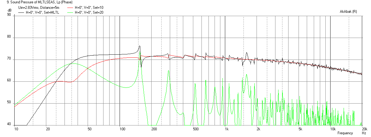

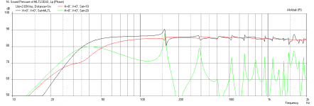

I put in the TS params that you provided for the SEAS driver and not sure if something is off but I get a rather low sensitivity of only 72dB at 2.93v. In any event, using the dimensions you provide below, I get a decent looking response with an F3 of 37Hz. So the design should sound decent assuming everything else about the TS parameters is good except the sensitivity. Here is the predicted response. Of course it won't go above the real stated breakup limit as the sim assumes a perfect piston diaphragm.

Here are TS params I used:
Def_Driver 'SeasL16RN' | 84dB 6mm xmax, Qts 0.45 80w
SD=104cm2 |Piston
fs=37Hz
Vas=19L
Qms=2.48
Qes=0.55
Mms=14.7g
Re=6.0ohm
Le=0.64mH
SPL at 2.83v and 1m (port assumed to be 4in from end, driver assume to be 17in from sealed end):
attachment.php

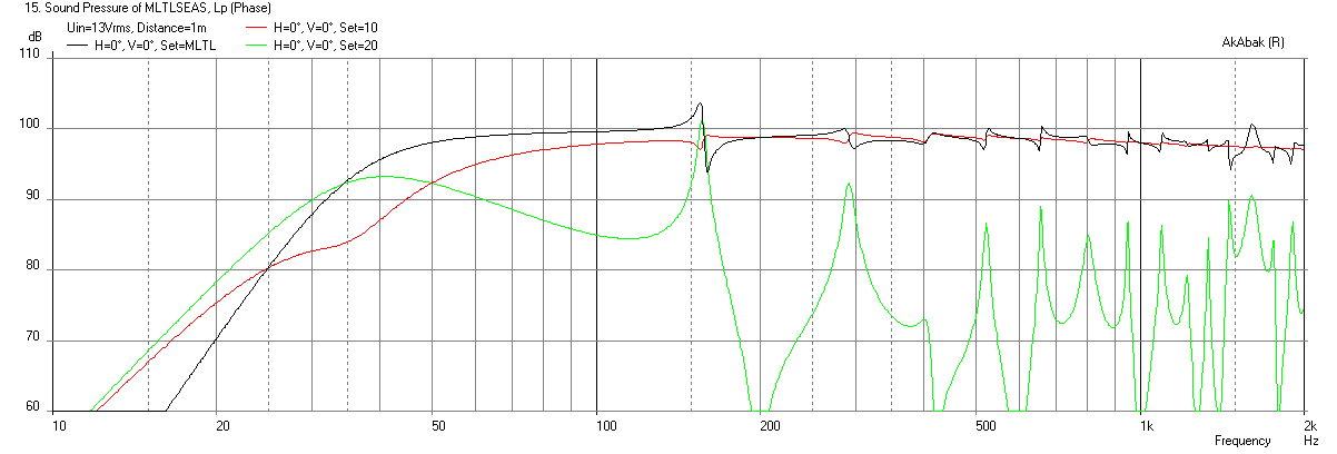

That's strange, because the regular BR calculator gave me 84.29 DB/W/M and an F3 of 34Hz just in a regular 40 litre box.
Something isn't correct then. I notice that if I put in the VAS as 1.9, rather than 19 then the sensitivity goes down to 74.29 DB/W/M.
Thanks very much for taking the time and showing interest by the way.
Glen
Ah - so obvious after one's seen it! I thought perhaps it was some sort of decimal place error.

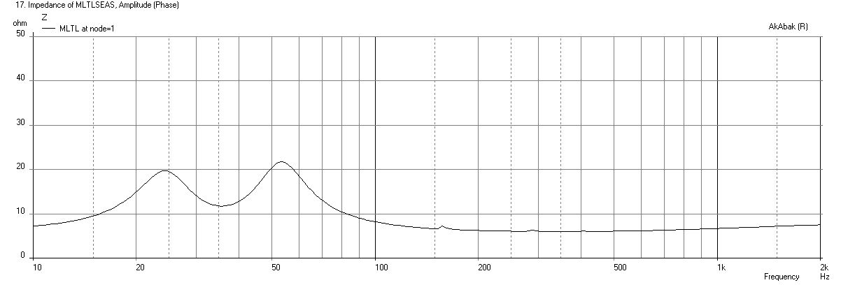

As a more general question; this simulation (thanks, once again) doesn't have any greater extension than the conventional BR calculator gives - the F3 of the normal calculation is 34Hz. Does this indicate that this particular cabinet design isn't really doing anything (at any rate, not the thing that I was hoping for)? Or is it the case that a mltl design might produce different sound characteristics, even if deeper extension isn't one of them?
You can get deeper extension at the expense of reduced SPL. A MLTL has an altogether better sound for the bass - not boomy - very articulate and clean. Also, the impedance will be flattened out somewhat rather than two sharp peaks as you would get with a BR. The smoothing is mostly due to damping and can be adjusted. The smoother impedance curve will sound better as the amp can deliver more current throughiyt the bass region without having two high impedance peaks to cross through. This gives punchier, more accurate bass.
attachment.php

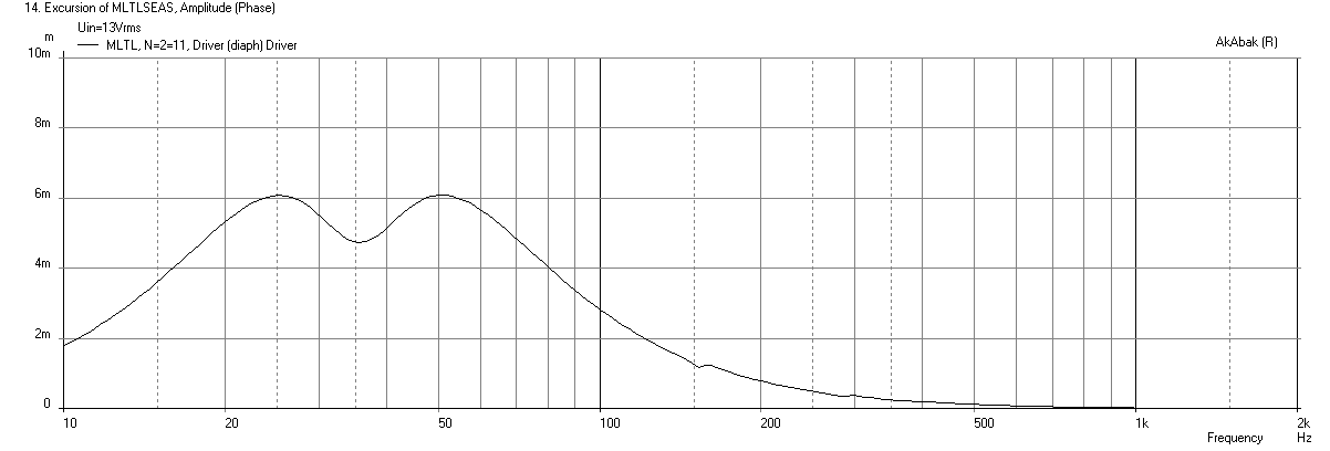

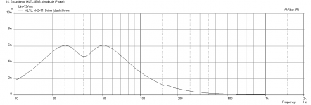

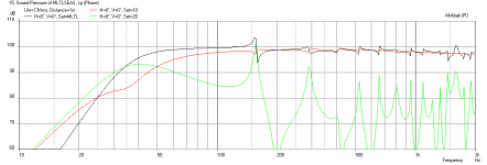

Here is cone excursion at xmax of 6mm (13vrms drive) with -12dB/oct HPF at 35Hz to prevent infrasonic over-excursion. If you don't have content down there it is not a concern:
attachment.php

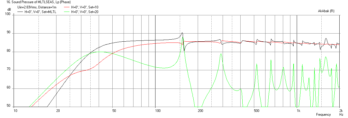

Here is corresponding max SPL - it's only 100dB and that is kind of low and probably due to fact that design has such a large volume, excursion is not as well controlled as a smaller volume box (of same volume as Vas). Such a box made with an XKi for example, will have same extension but higher SPL due to better cone control.
attachment.php
For completeness, here is response at 2.83v/1m:
attachment.php

It remains a puzzle for me how to have the large volume necessary for an adequate cross section, combined with a small enough volume for the cone control you mention. I guess there may well be better drivers for these enclosure dimensions. Or maybe I ought to make it a bit less tall with a smaller volume and shorter TL.
The target keeps moving (something which appeals to my restless mind!) as I get more things figured out I move on to other refinements/options. When I have got some competence with simulation software I will experiment with a larger driver and a tapering TL, and also with this driver but with reduced volume.
Having said all of the above, max SPL of 100DB is more than Alpair 7.3 will do anyway, and only a little shy of what an A10.3 can manage safely - and way below the likely level in my lounge! Also, I don't for a second doubt the sophistication of XKi, but simplicity of build is a very high priority for me and a rectangular box with perpendicular two braces and no angled cuts is quite an elegant solution in my mind.
