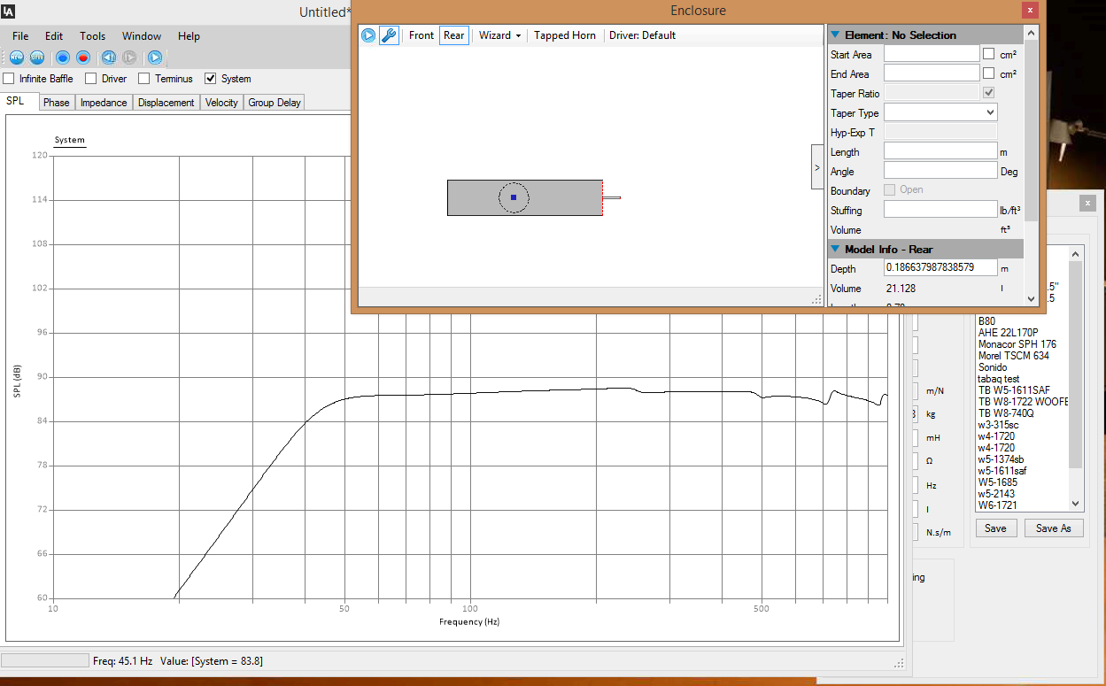

I am looking at designing an MLtL for Monacor sph 176 MiD WOOFERS I came up with a an 85cm line with a cross section of 270cm with a 5cm wide by 11cm long port giving 23 litres tuned to 42 hz , am on the right track here? Thanks in advance for any advise.

Greets!
Assuming you mean a 5 cm diameter port and an unspoken 0.349 driver offset, then looks fine in Hornresp with minimal stuffing except that at a peak usable 40 W the vent mach will be over twice the considered acceptable limit [~12.6% Vs ~5%]. To get to ~5% requires a 3"/7.62 cm diameter x 11"/28 cm.
