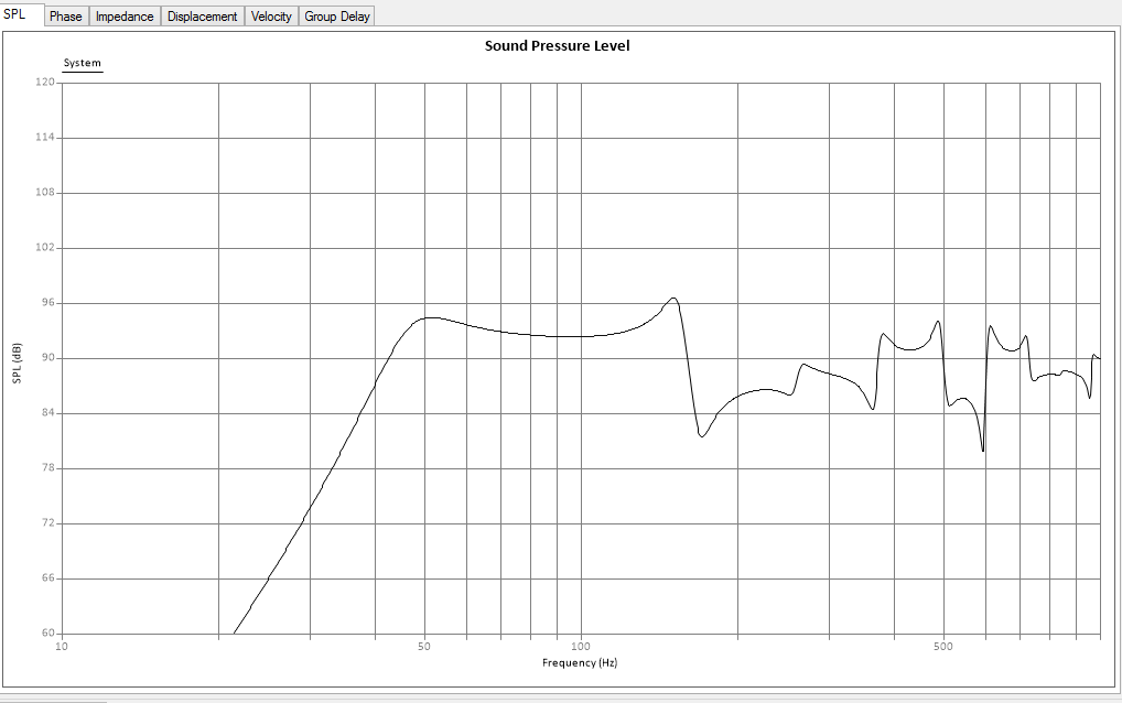

My sim had the driver at 42cm (centre point of the driver) from the top.
If you place the driver at 20cm from the top, you get this -2dB ripple between 200 and 350Hz. If you are ok with that, then go ahead and place the driver higher up.

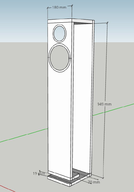

This is it, rendered as discussed. Driver center is placed 20cm from the top. And tweeter face is rendered here. Actual cutout should be smaller. Do I need to make the enclosure taller?
Also, I don't know if this tweeter is sealed or not.

Thanks GM. I agree, I always pay attention to tweeter height. Depending on the chair, when I sit my ears are at 110-120cm height. As drawn, the tweeter center is at 90.5cm and driver-tweeter border 86cm.
Now my room is very very small and if I am 'critically' listening, I am only 150cm away from the speaker baffle. Therefore, I am interested to make the tweeter sit at ear level. Any suggestions?

Looks nothing like that in real life, much less once damped and why I don't use that program. Does look like one of my big vent reflex BLHs before damping though, but construction wise nothing like a MLTL.

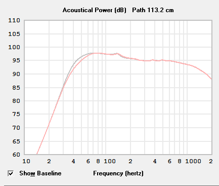

Of the ones I've used, MJK's MathCad worksheets does them best overall, but don't have it loaded, so use HR as an acceptable substitute since DB made so many upgrades, refinements.

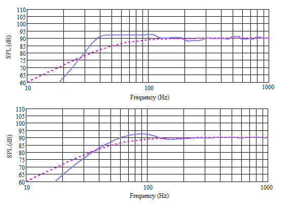

Blue line = 496.61 cm^2 CSA/116.9 cm^2 vent
Red line = 342 cm^2/70 cm^2 vent
