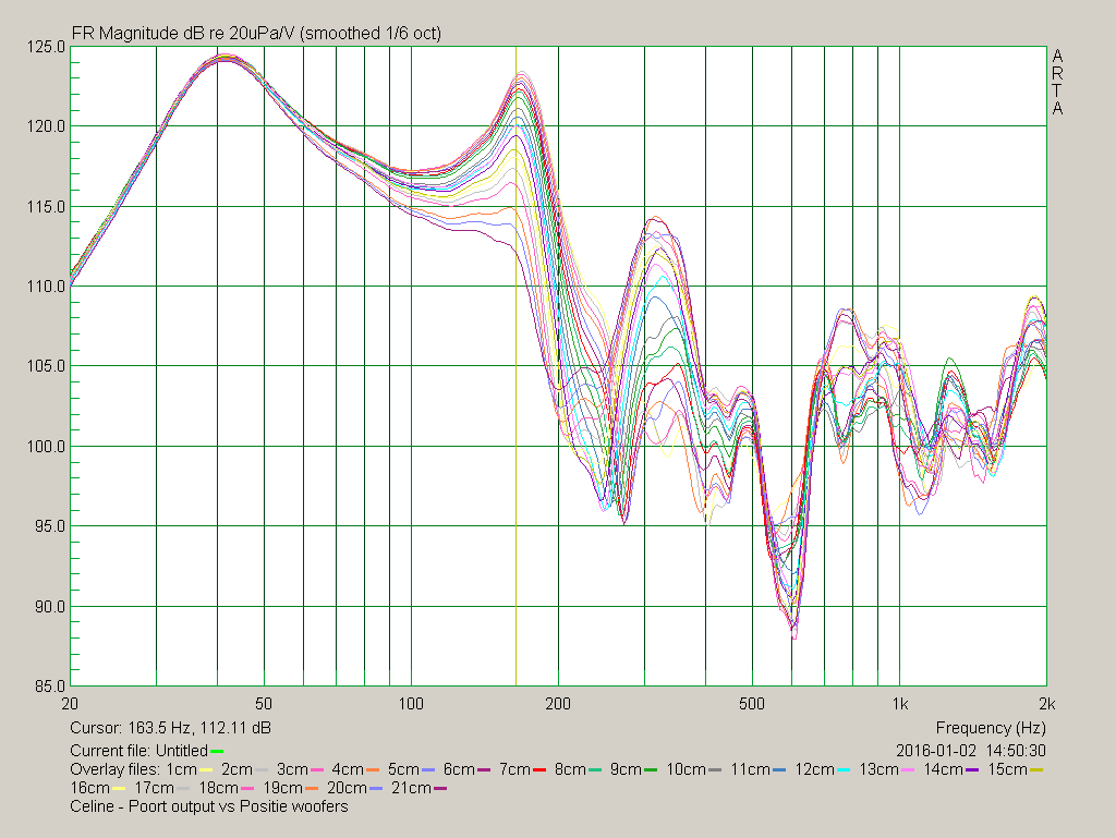

so 4 per box?I have 8x Seas W12CY001 (excel) that I would like to try in a slim tower, would they work in MLTL since Qts = 0.36 and also not a full range?
if you place them so that the lower is at slightly below halfway top-bottom and the other 3 above then the worst unwanted resonances will be suppressed.
attached gif showing the effect of driver position (sim is for 1 driver only)
the graph shows actual measurements of port output of a MLTL with 2 drivers (d'A config) where I moved the baffle down 1cm at a time to find the optimum position.
so 4 per box?

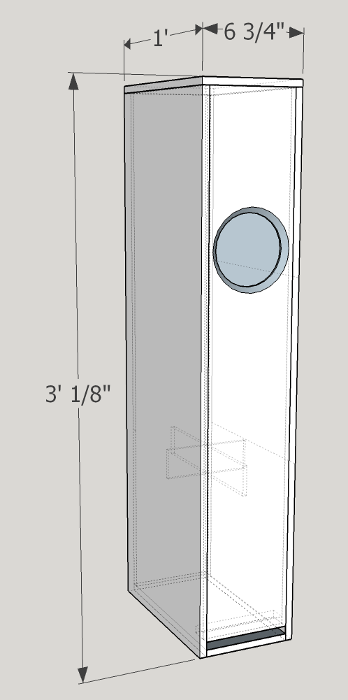

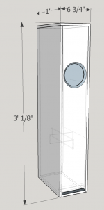

Sorry to reply to an old thread. I only just found the AMLTL technique while reading up on the TABAQ.
Another recent discovery for me is the Visaton FR13-4 5" full-range with whizzer cone. It's an inexpensive driver with high Qts (1.25), so I thought I'd plug it in to WinISD and then try the AMLTL technique with it. I settled on 1.3-ft3 volume; the port is 3.14-in2 cross-section area and 1.6-in long. The tuning frequency is 46Hz and -3dB occurs at 40Hz in a vented box.
Attached is my resulting AMLTL design. It's a practical size for my listening/living room.
I have a couple of questions. First, I notice that MLTLs often have a relatively square cross section, whereas mine is distinctly rectangular. Is that a problem? Secondly, for a 5" driver, am I better off using a proven design like the TABAQ large (which is taller than I would like)?
Thanks for any and all feedback.
Rectangular cross section is fine and probably better than square. Keeping the port shorter vs longer is a good idea to avoid harmonics of 1/2-wave resonator as Scott points out.
A higher Qts driver might work - it will have a bass peak overshoot probably but that can sometimes be tamed with more stuffing. But best to spend a little more money on a driver with bigger magnet than waste a lot of money on wood making the wrong cabinet.
