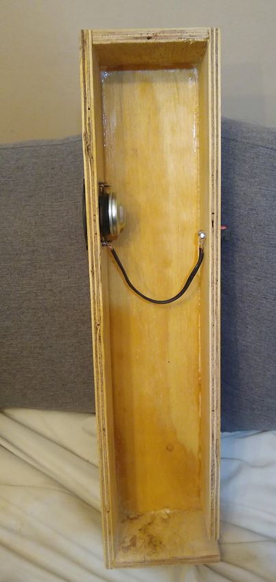

I set the port at "the bottom" meaning the port is the last part of the line. A slotted port.
I was wondering if there was symmetry between port and driver placement. That is, if you were stuck with the driver being at one end of the line, could you put the port appx 1/3 of the way from the opposite end - to similar effect?
Unsure if the stuffing would "mirror image" as well.

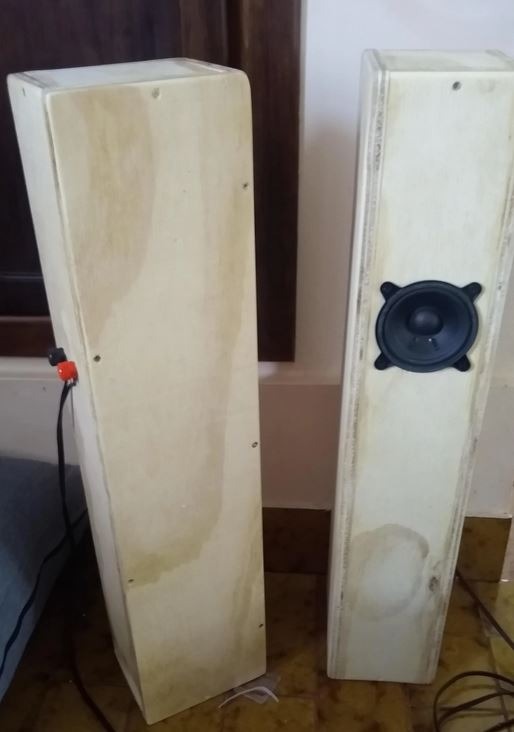

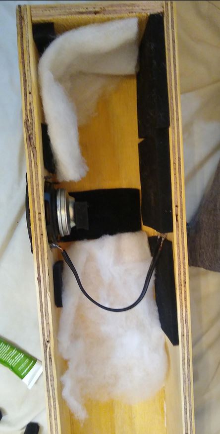

I had a pair of FaitalPro 3FE22 and did't want to make a Bass Reflex cabinet and was afraid that a TL or any kind of pipe was no going to work. Searching for mass loading a TL I found this thread a read all the 26 pages.

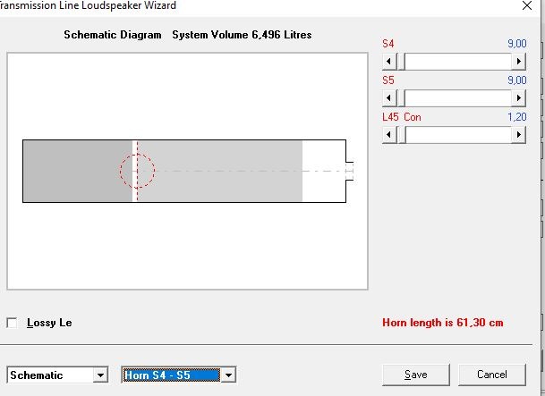

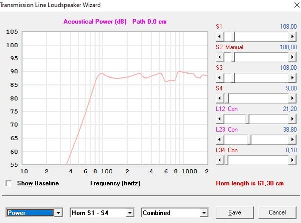

I designed an bigger box in winisd so that extensión would be lower, but there was a drop in the 100-150Hz that I was afraid would sound thin, so make the TL tunning to this zone. The results were quite good, I also found in this thread a way to add the bass reflex to hornresp. These are the results.
They would need step compesation if placed over a table but not if they are on the floor. They are really bassy, almost boomy if placed against walls, so no step copensation will be added. The gratest strenght is soundstaging, they are also non fatigating. I added a bit more polyfill and then glued them for good.
After these I will be building some 3 ways speakers.
Thanks. Regards.

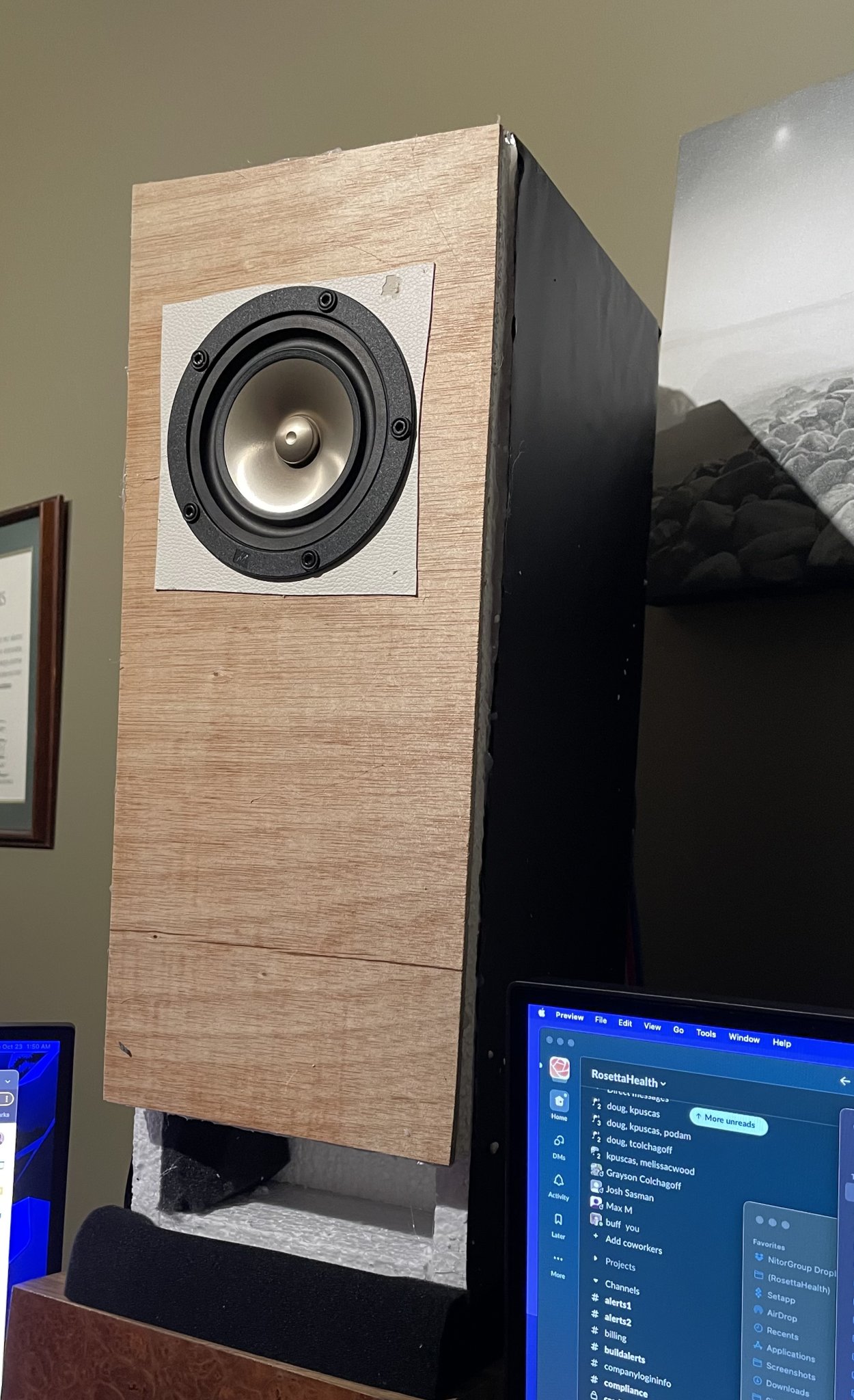

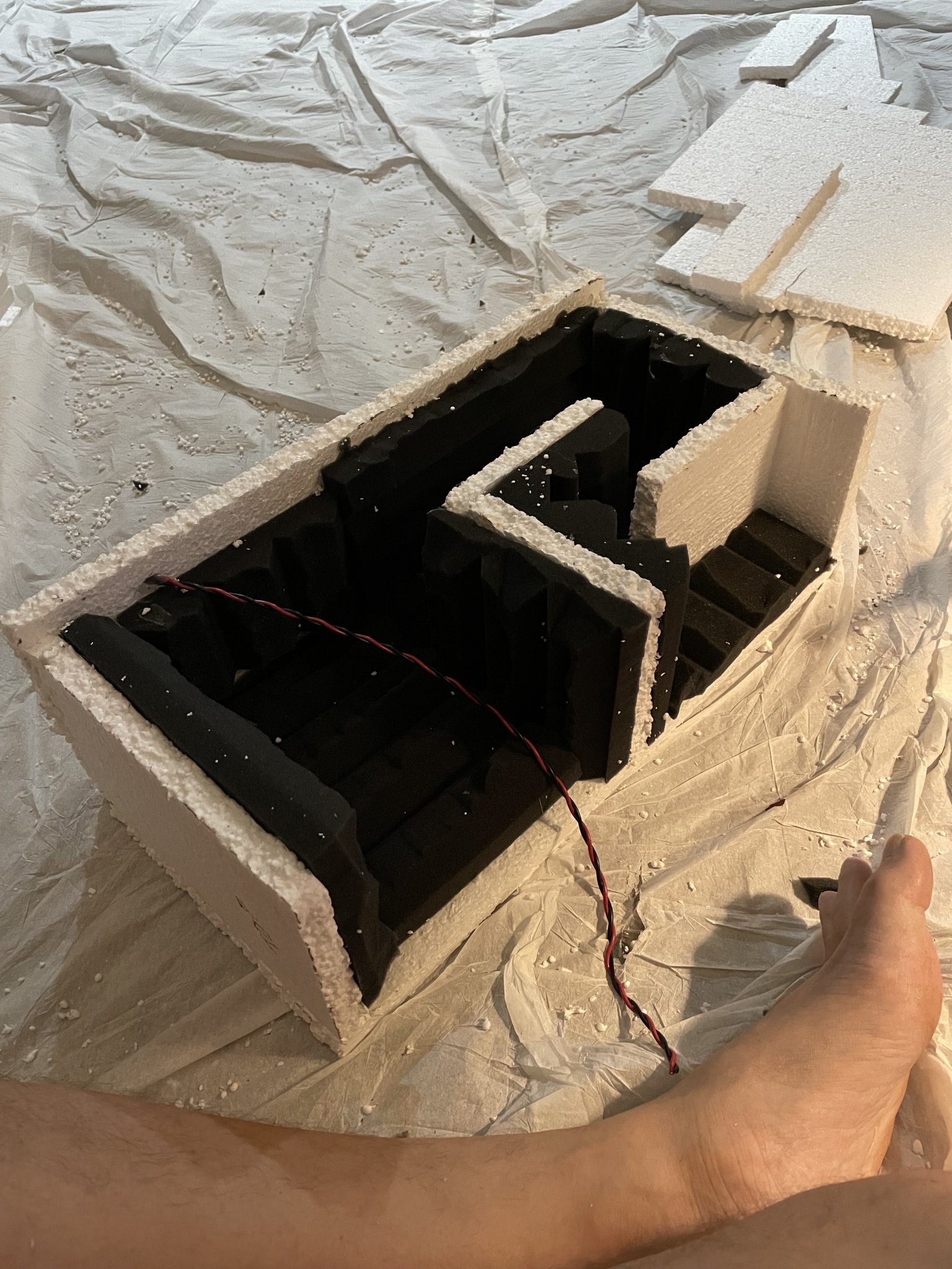

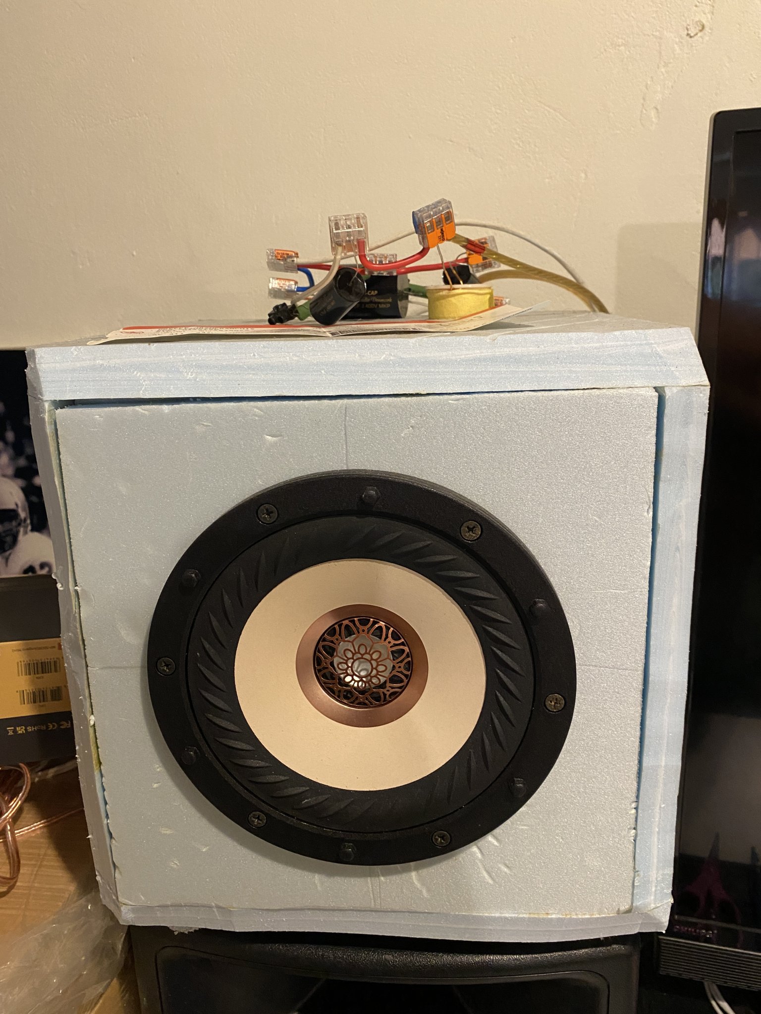

I'm starting simple. I did my first TL prototype of a bookshelf based on MarkAudio's Pluvia Seven 4" full range, some 3/4 inch foam and 1/4 plywood on baffle to do a quick and dirty photo (still need to trim the temp gasket). But I was pretty surprised at the sound this quick and dirty speaker could produce.
I was excited to start and used large cell styrofoam boards that were available... mistake. messy, and had to work to seal it but it worked. I covered it in vinyl just to cover the foam a bit. I will be changing foam boards going forward.

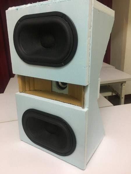

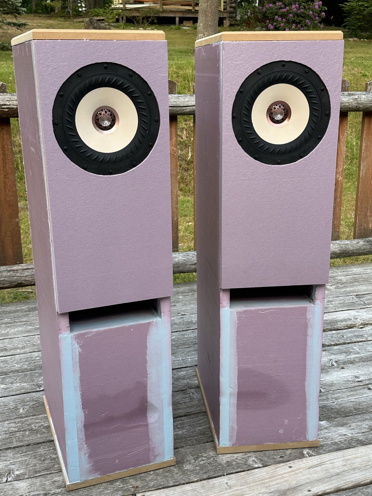

It would be some feat of marketing to convince your customers that speakers professionally constructed of such materials sound every bit as good as those made from the heavier stuff. Someone would save on shipping.Foamular pink XPS foam insulation boards from Owens Corning works well. You can glue thin plywood on it. Or use paper faced foam core board. Very thin but with bracing works quite well. Elmers brand is extra strong.

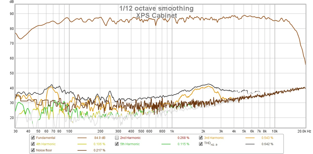

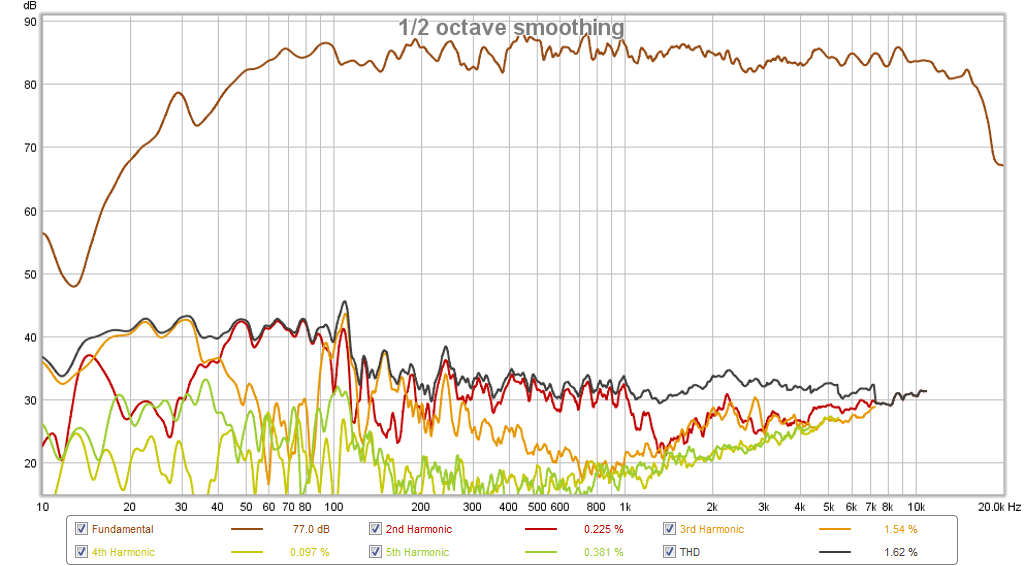

My measurements show that the XPS foam cabinet measures as good, if not better than 3/4in BB plywood. It really is lighter and has more self damping. Requires extra bracing but that’s not hard.
https://www.diyaudio.com/community/threads/10f-8424-rs225-8-fast-waw-ref-monitor.273524/post-6034251
XPS foam cabinet:
BB plywood cabinet:
The both sound great. I think if I worked harder on bracing the XPS box, the HD below 100Hz could be improved.
