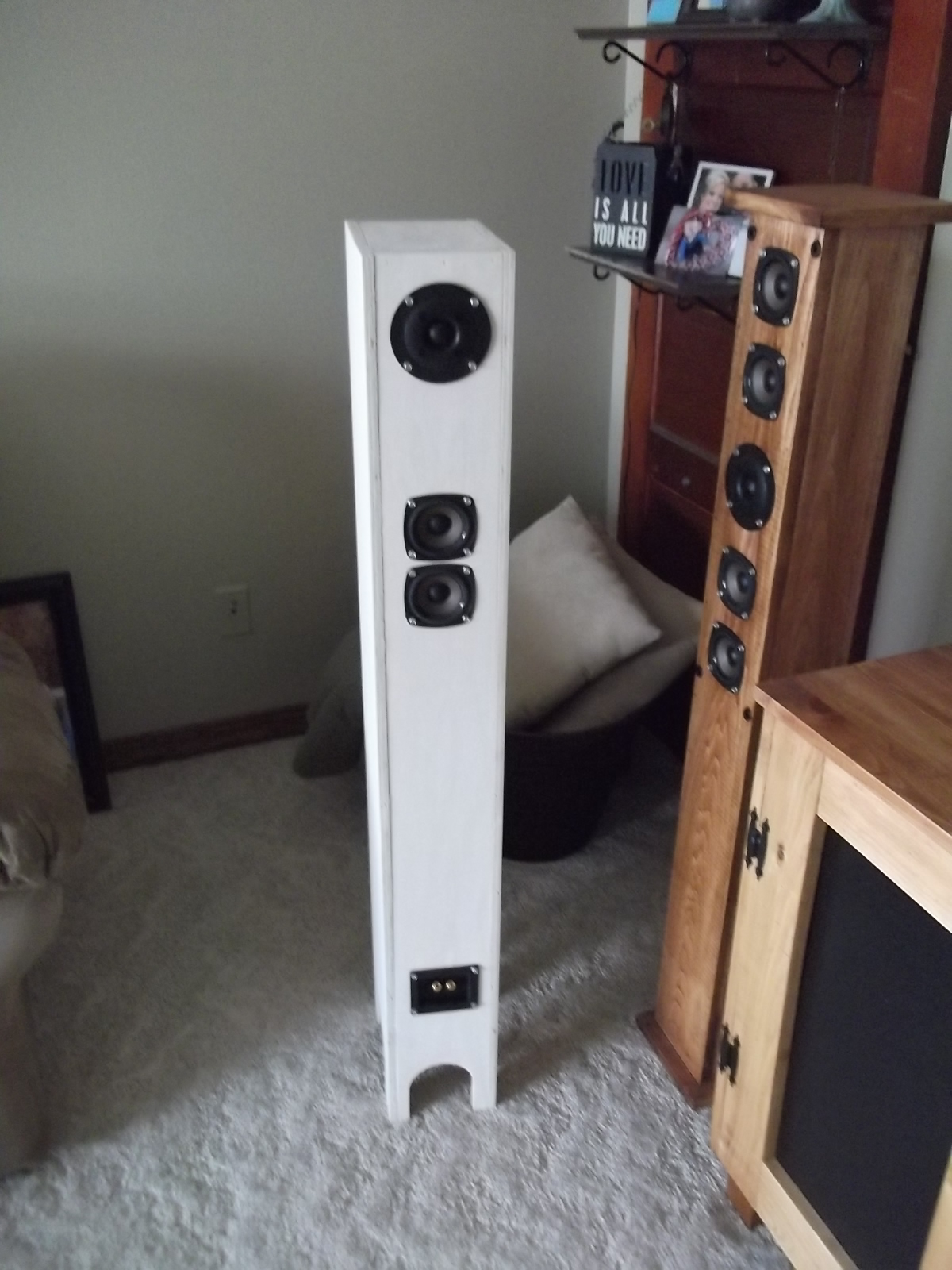

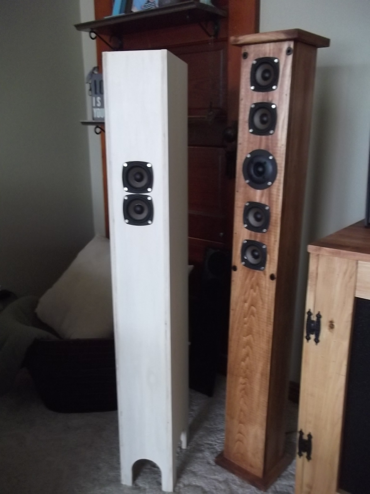

Well here it is! A quick build on a snowy day.
I've had it playing for literally 5 min and WOW! Out in the garage I had it hooked up while stuffing it. No lid no bass response. Slowly slide the lid on and poof! amazing sound.
Bad thing is now I'm going to have to build another to match. haha
Here's a before and after shot. I'll be writing up a build thread later today with more pics.
X thanks for all your help! It's greatly appreciated. Thanks again!
