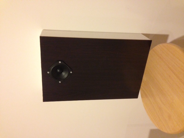

Compact Vifa MLTL build completed
I Just finished the new speakers. Have not had too much time to listen to them but there is a good deep bass punch to them. I may have to play with stuffing adjustment. They sound real nice so far. Very compact almost desktop size. Sorry about the rotated photo - it was vertical when I uploaded it. This was a super simple build.
I updated the first post to show links to now 5 known examples of successful builds using the Accidental MLTL or AMLTL technique. I have since figured out how to model MLTL's in AkAbak, so this technique is only used as a starting point to estimate an initial CSA and vent dimensions from which to start tuning in the real simulation.

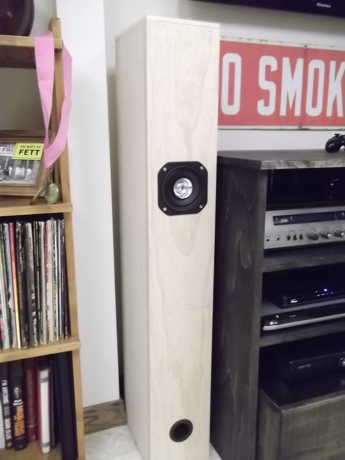

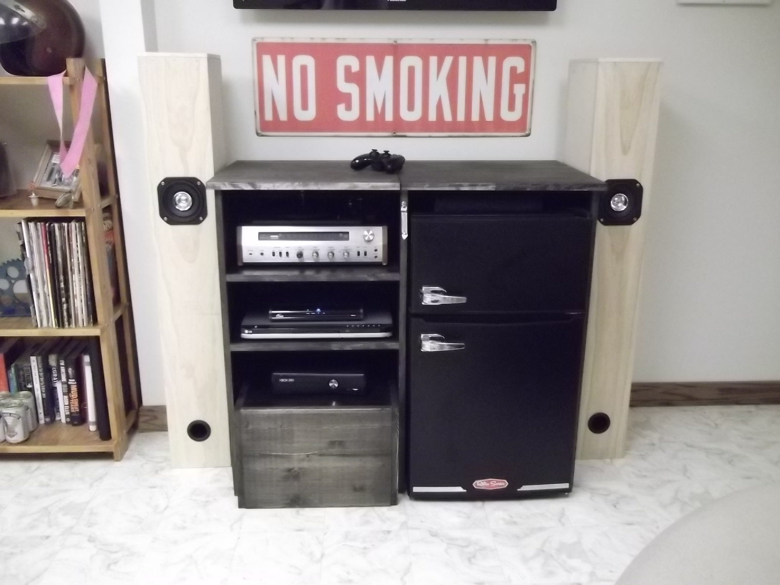

monacor sp50x mltl
Well here they are. The enclosures replaced a set that were strictly bass reflex cabinets. These sound so much better. Lower extension and has a fuller low-mid.
Can definitely listen without sub help.
I haven't decided how to finish them. The old ones were stained black to match the mini entertainment center. I'm leaning that way but I do like the natural look also.
Thanks again X for all your help.
