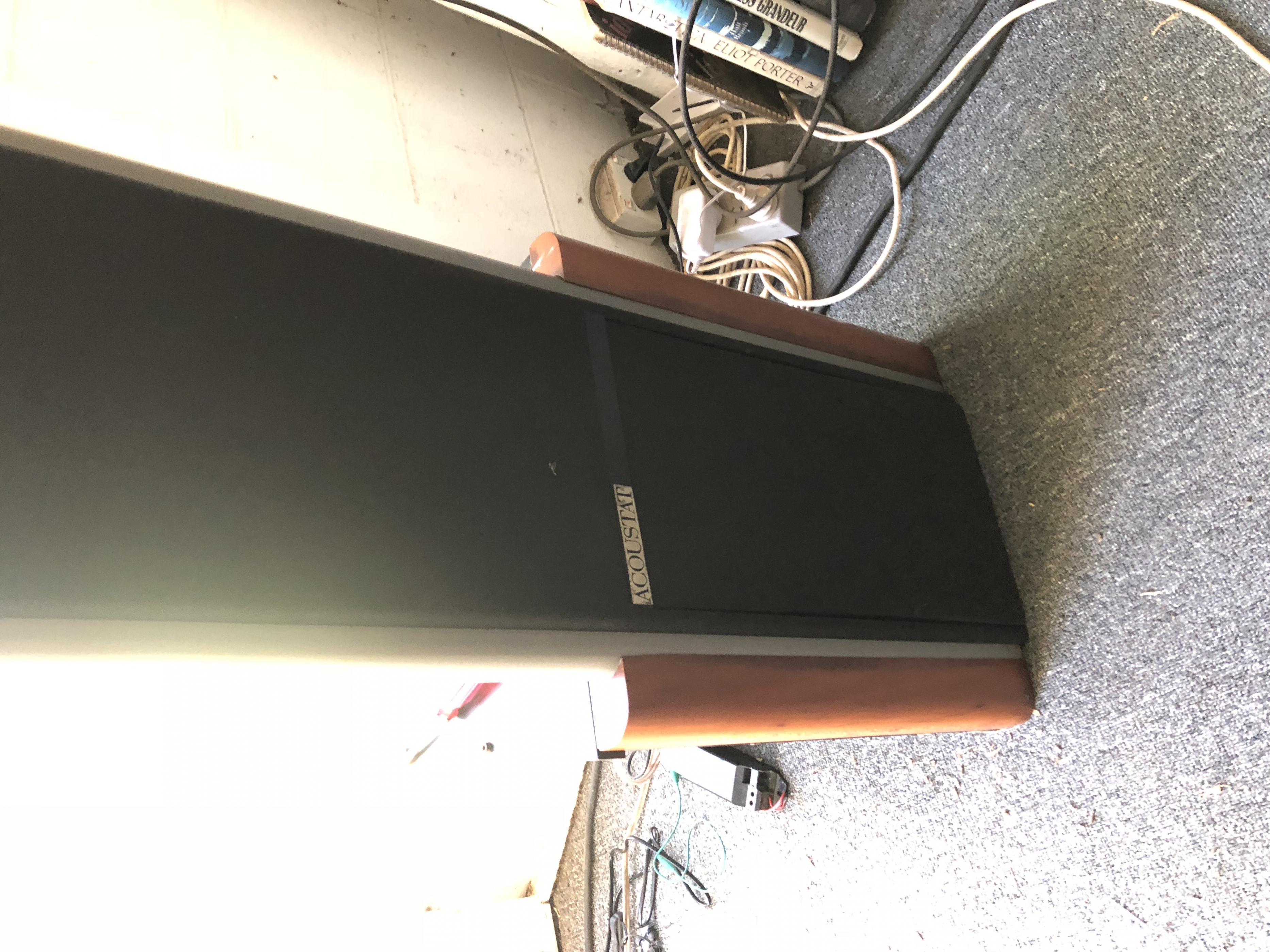

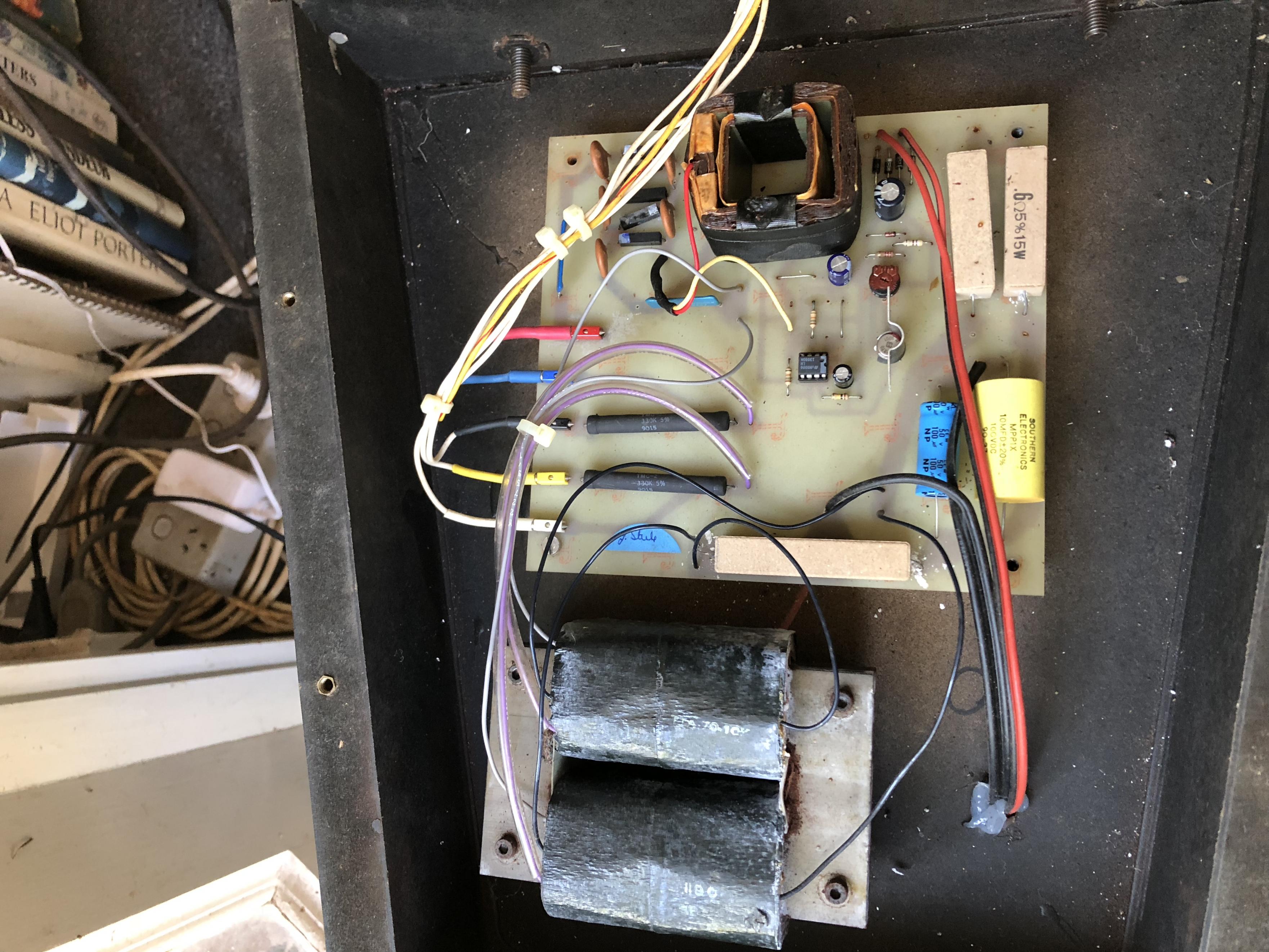

Hi there I’m new to all this so please be patient
I have recently become the owner of a pair of Acoustat hybrid sold have connected them up
With great anticipation and I get bass and midrange with very distant top end as is evident something is wrong power supply plugs in rear between binding posts and is 12volts ac
I unscrewed the top of the sub enclosure to reveal the circuit board all seems ok will probably need to replace the two transformers caps and resistors etc also I can not identify a model and I’ve been looking please find attached photos

This is interesting. What I see inside is the components for a Spectra 1100, but I am unfamiliar with the external appearance. This was not made by Acoustat in the USA - I am wondering if this is one of the models briefly produced in Italy? Or perhaps a home-brew modification?
Attached is a schematic and board layout for the Spectra 1100. I don't see the connections to the Hi-Frequency contour switch, and if it is absent, you will get the least amount of highs, although the difference between high, low, and medium positions of the switch is not huge. I would start your investigations there. If there is no switch, you can replace the switch with a piece of wire, which will give you maximum HF output.
Let me know what you find out.
many thanks
so im not going mad
thanks for your help will let you know how i go
again
thank you
You should also be aware that the Spectra 1100 (and presumably your variation, too) are left and right, mirror-image pairs. They should be oriented left and right so that the highs are coming from the outer edge of each panel. Having them backwards will do weird things to the imaging and may also affect the perceived HF balance.
