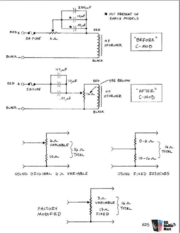

I saw those when he first posted them. Andy, what was the difference between the RED and BLUE placards on the back? I remember that we dealers could do one of them, (think it was putting in a 'slider" type resistor for the high frequency? Which one was which?

A BLUE medallion label indicates the original Medallion transformers. This was an expensive modification. A RED label indicates Medallion transformers plus the C-Mod. The C-Mod was relatively inexpensive and is easy to do after-the-fact using commonly available parts. The C-Mod can also be done to non-Medallion interfaces with the same positive results. This eBay offering is of interest because it could be a way to get the Medallion transformers at a reasonable cost, which are otherwise unavailable at any price, to the best of my knowledge.
BTW, the type of variable resistor will depend on the vintage of the interface.

There is also a pr of the none C-mod for sale.........Any of these interfaces can be setup with C-mod.
