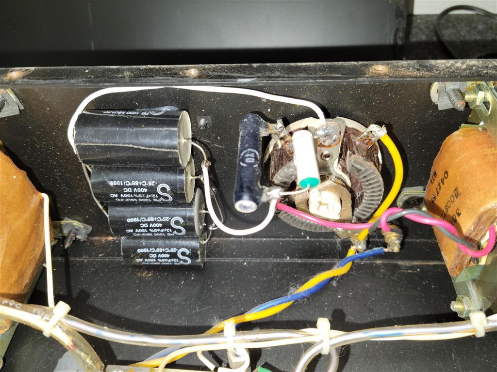

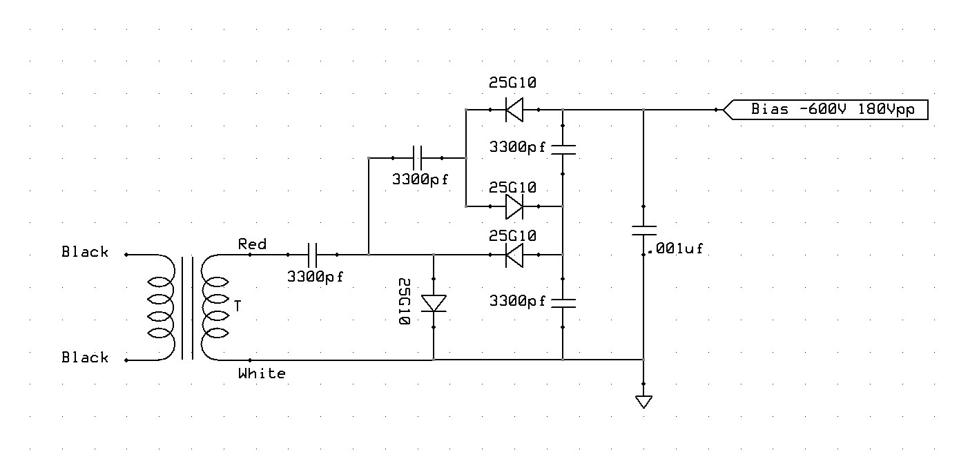

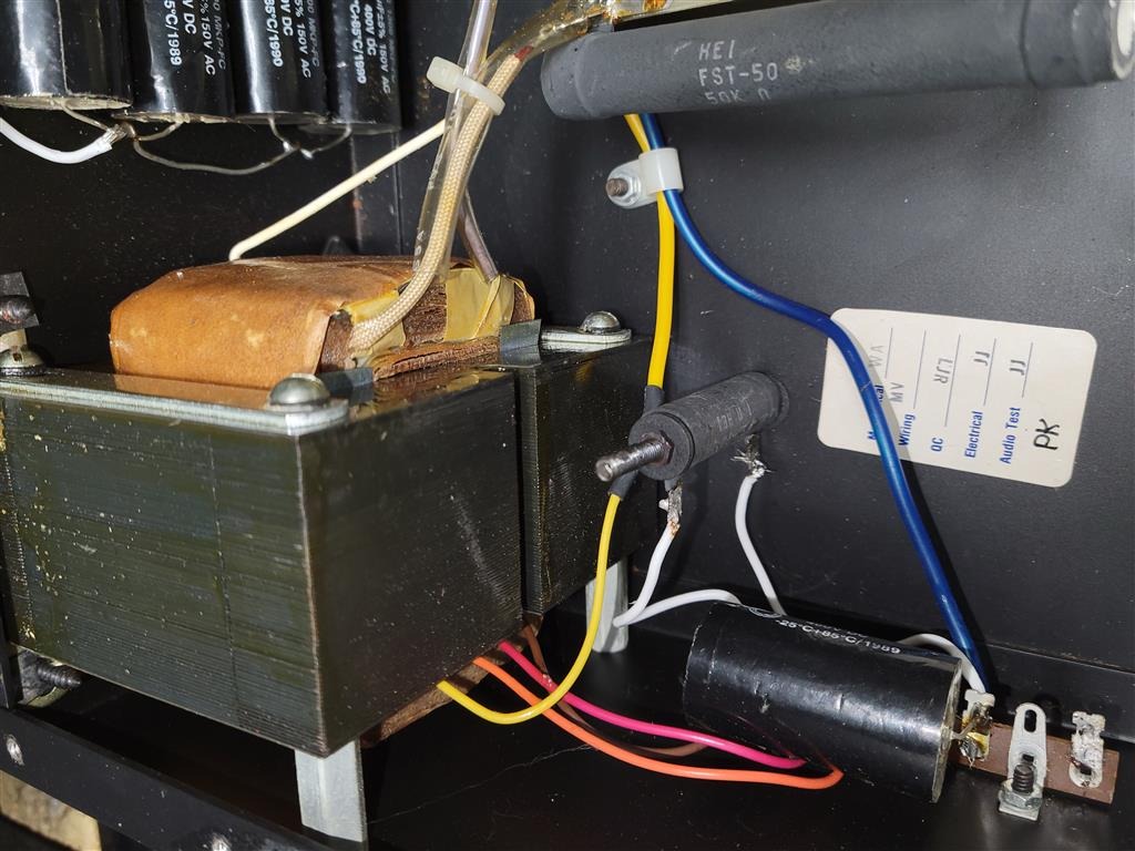

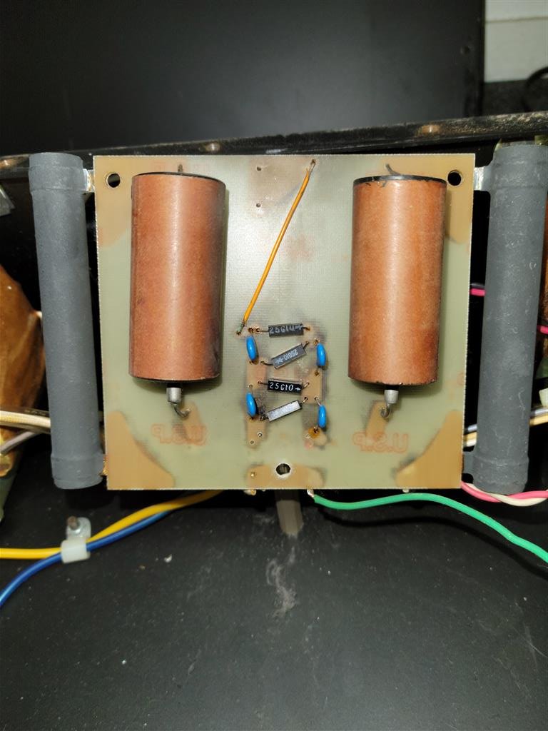

I have very little Accoustat experience other than the Model X. That was the only thing sold in this area so that’s all I ever saw back in my shop days. That being said, I have a set of Acoustat 2+2 with the MK-121-2A. These appear to have been modified and I must admit I don’t understand the modified bias circuit. Everything I have found online says this thing should produce about 5KVDC bias voltage. The schematics online are not even close to what this is using. There are only 4 diodes are in a bizarre arrangement and the 500 Mohm resistor has been replaced with a jumper. Additionally there is a 0.001uf capacitor filtering the final output. This is producing a negative 600VDC with 180 or so Vpp.
Could the Accoustat Answer Man or someone more knowledgeable than me take a look at the schematic I drew and help me figure out what’s going on. These do work but they don't sound very good.

Music Geek - I'm afraid your speakers are the victims of a well-intentioned, but hare-brained modification to the bias supply. I've seen this before. Simply put, you should return the bias circuit to its original configuration. Removal of the 500M-ohm resistor changes the fundamental operation of the speaker from constant charge to constant voltage. The latter mode is well known to create higher distortion levels, since the charge on the diaphragm will be constantly changing. You will find that virtually every ESL ever produced (and certainly all of the successful ones) has a high-value resistance between the bias supply and the diaphragm. Would you want a conventional woofer where the strength of the magnet was constantly changing? HECK NO!
The capacitor on the output is unnecessary and can lead to a much greater chance of a dangerous shock to personnel. Any why anyone would decrease the number of stages in the voltage multiplier is unfathomable to me.
Due to the age of the speakers, and the fact that you are missing a multiplier stage, I recommend replacing all of the diodes and capacitors in the multiplier. See attached document for modern equivalents. The fact that you are reading a negative bias voltage suggests that the modifier also reversed the polarity of the diodes. Be sure to orient the diodes properly to yield a positive bias voltage.
You'll also need to find new 500M-ohm resistors. I suggest the surplus market for those. Resistance value is not super critical, probably anything in the 300M-600M-ohm range is fine. Make sure the part is rated for at least 5kV and will fit on the board. Wattage rating is not really an issue in this application, as a sufficient voltage rating will pretty much guarantee that the wattage is also sufficient.
BTW, once you return the bias supplies to original, a conventional HV probe will not measure 5000 volts DC - it will measure only about 3000-3500 volts due to loading of the supply by the probe. This is normal.
I would also suggest checking over the schematic of the rest of the interface and comparing it to the original. It appears the C-Modification has been done but based on the damage done to the bias supply, you should check it for any other modifications. A schematic with the C-Mod is attached.
I'm curious - I see that the original pin receptacle for the red wire, and the thumb screws for the white and blue wires, have been removed. How are the panel wires connected to the PC board?

Acoustat Answer Man. Thank you for your help. The - Bias voltage confused me and, like I said, I'm not overly familiar with these so it's good to hear from the expert. I'm looking at these for the resistors: https://www.mouser.com/ProductDetail/Ohmite/SM108035006FE?qs=SR60igVWod0LkwVbstG/Ow==. If may be a little overkill but it appears to be a limited selection in that value range.
I took the thumb screws out in order to get to the board. One unit has the original pin connector for the red Bias wire the other doesn't and is just soldered next to the pin receptacle.

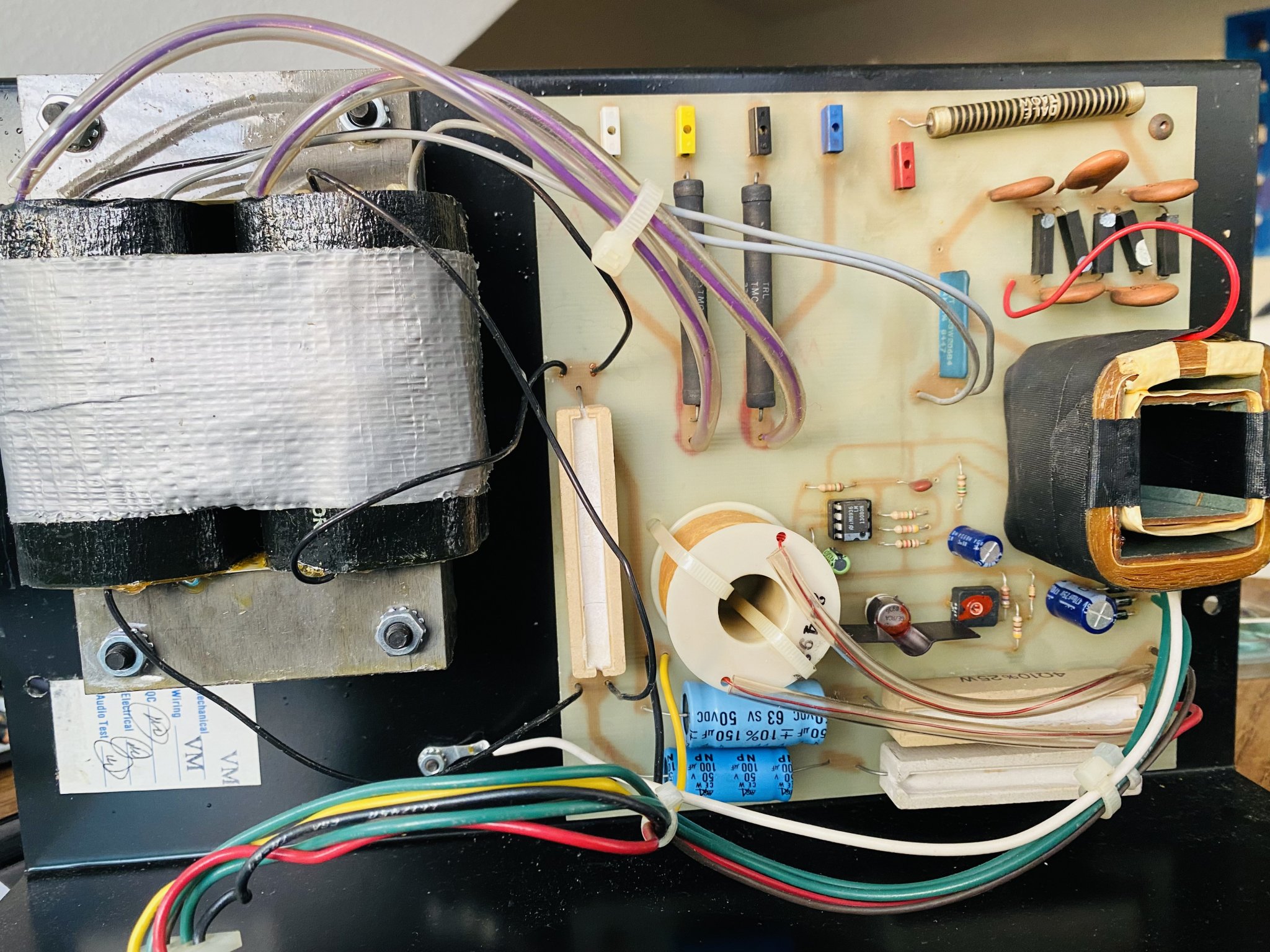

i have taken photos of crossovers of the Spectra 11 , the BIAS seems to be sealed , i cant really see to which "V" they are sat to , i am assumimg that it should 15 V , as that is what it says in the adaptors , hence the voltage in Denmark it 210 /20 Volts
