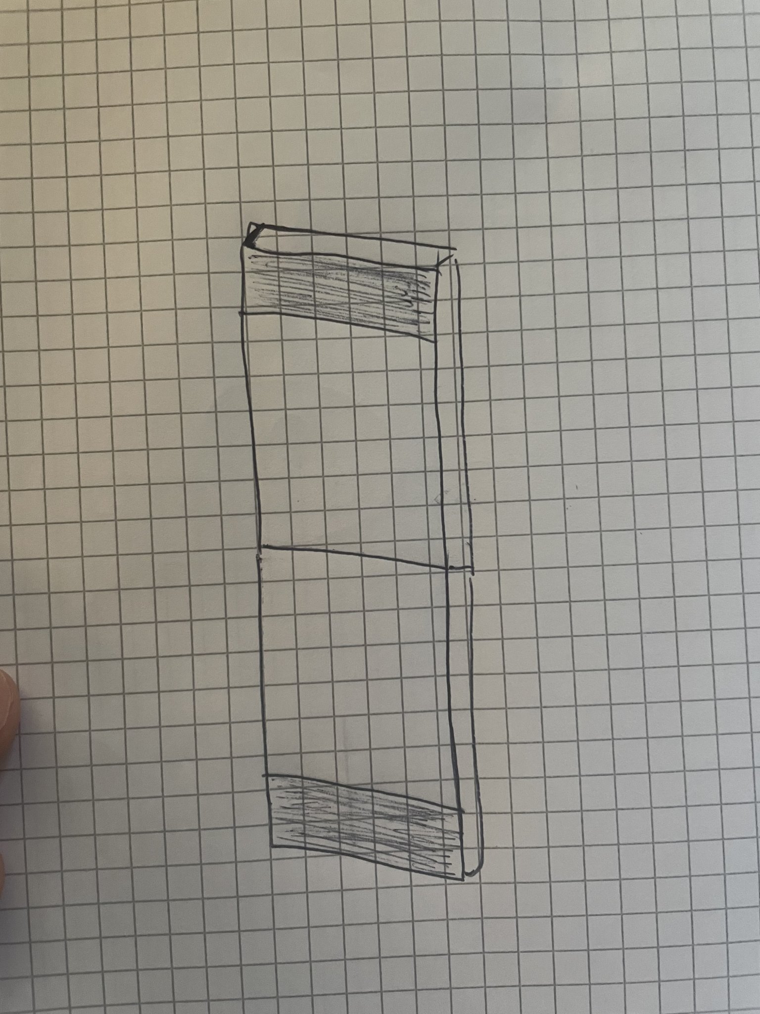

Ok, if I'll have the opportunity to find the second pair of model 4 that I'm searching from a while I'll have to put the second pair on top pf the other but reversed, correct? So I'll have the wooden frames one at the bottom and the other at the absolute top?

Here we go.
Stacking them that way will depend on total height achieved - is your ceiling high enough? I suppose you could do that for experimental purposes, and if you like the result, then build proper 8-panel frames. With 8 panels, I think you'd get the best results with the bottom panels essentially at floor level, as was done with all "stacked" Acoustat models. These models were 7-feet,10-inches tall, barely able to fit a standard 8-foot ceiling.

I made frame drawings for the Spectra models when I was employed at Acoustat. Not sure if I ever made drawings for the older models. In any case, I no longer have access to those drawings. I would suggest developing a drawing based on the panel arrangement in your Model 4, and build UP from there.
