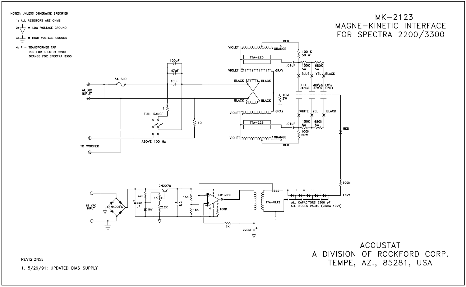

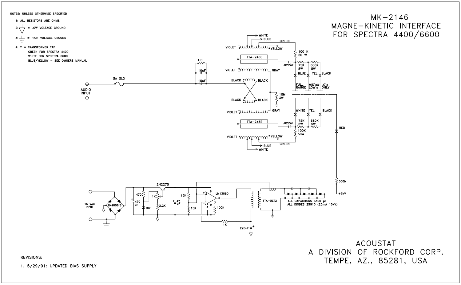

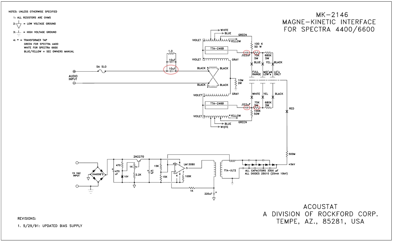

Attached are the schematics for the Spectra 2200/3300 and 4400/6600.I hope 2 TTA-246B transformers mounted on wood rails is all I need? I may have a lead for a Spectra 22/33 interface box. If I do get it what parts would be required to replace?
Based on comparison, besides the transformers only a handful of parts would need to be changed.
The mixer capacitors, the first Spectra sectoring resistors, and one of the input capacitors.

Bolserst - thanks for posting the schematics. For some reason I haven't been able to attach items here for a while. I've done it in the past, so not sure what's wrong.
Again - let me know how I can help with this fun project. Only a very few of the Spectra 66/6600 were manufactured (definitely < 50 pairs), so to find an almost complete pair for such a low investment is something to feel very good about!

Again, I luck out! I was able to purchase one of the 3 transformers that was on eBay. Someone just snapped up the last 2 today. Because they are hard to find in hindsight I should of purchased all 3. I am looking forward to the challenge.

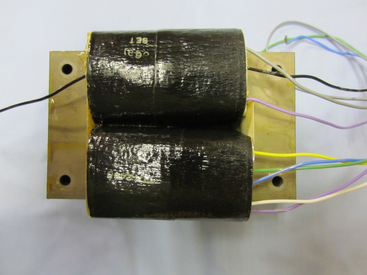

A slight step-back on my quest. Another member who has a 6600 pointed out there was something missing from the transformers on eBay. I read the info again and noticed this "factory work in progress". It has not shipped, so hopefully the seller will provide a refund. In the mean time I was successful in finding a replacement.
Hmmmmm...what is missing? they(the transformers) look complete in the pics posted for the ebay listing....Another member who has a 6600 pointed out there was something missing from the transformers on eBay
Obviously the rest of the interface is missing, HV supply, mixer and spectra sectioning resistors, etc.
But I thought it was the transformers you were in need of, getting the rest of the interface parts from a donor Spectra 22/33.

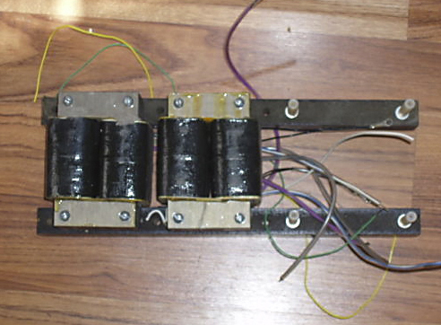

What I was informed was, the wires shown on the eBay listing are not all complete as the one he has. There is one black wire from one end of the transformer and on the other end- 3 wires on one side (purple , black, grey, the other side has 5 wires purple, white, blue, green, yellow.
![66.jpg 66.jpg](https://www.diyaudio.com/community/data/attachments/524/524013-e85c0fe862e14f9589f8af97122907b9.jpg)
Correct. The wires exiting on the back side of each transformer should look like the attached pic.
I believe when they are assembled on the wooden rails, some of the wires are combined.
For example, the two sets of purples and the two sets of blacks may only have a single lead out wire for each set.
AAMan should be able to confirm this.
You might send the seller the attached pic just to confirm all the wires are there in the two-transformer rail assembly being sold.

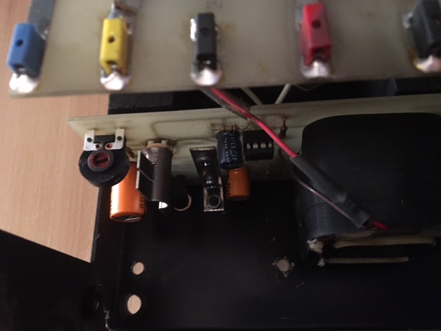

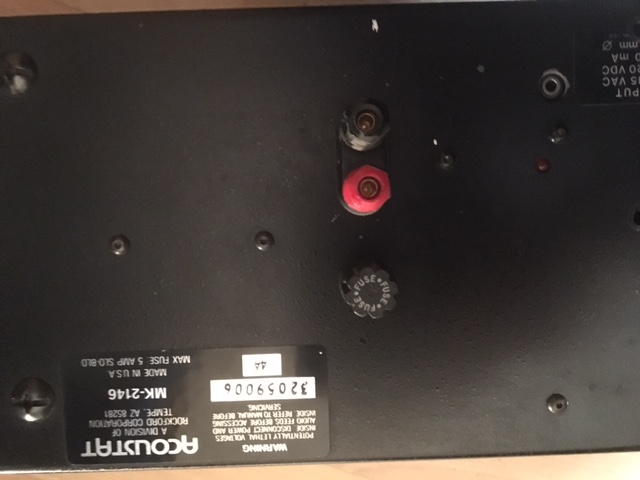

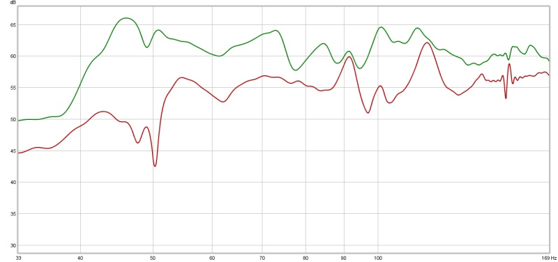

Hi I have Acoustat Spectra 44s. The interface is MK2146. The right channel bass output is lower than the left (can send Room EQ results measured from 1 meter in the center.) The bass tap (bottom of transformer) is green to the PC board. There are dip switches do these change anything? Can someone help with possible cause?
I have never heard of dip switches in Acoustat Interfaces, can you post a pic?...The bass tap (bottom of transformer) is green to the PC board. There are dip switches do these change anything?
The green wire bass tap is the OEM setting for a 4 panel Spectra model.
You can adjust bass level by changing tap, but there is only a +1dB of bass increase available relative to the green wire.
See attached notes from AAMan on adjusting bass EQ for the Spectra models.
