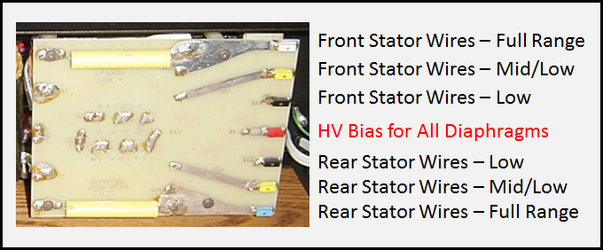

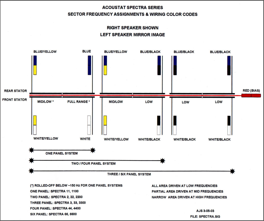

Aaah, ok. Those aren't dip switches, those are the connectors for the wires going to different portions of the ESL panels.
The two attached pics should give you the info you need to make sure both of your speakers are wired up correctly.
The wires coming from the panels should have tip plugs that fit the connectors on the PC board.

If you look more closely there is a bank of dip switches below the connectors. As a matter of interest how do you identify the front set of stator wires from the back set?
There are NO dip switches in the speaker, at least not as originally configured. If someone has added some, I suggest they be removed, as no dip switches are capable of handling the voltages involved.
The rear stator wires are in the BLUE group, and the front stator wires are in the WHITE group. See the diagram posted above to see the complete Spectra color coding scheme: all should be clear if you follow the diagram.

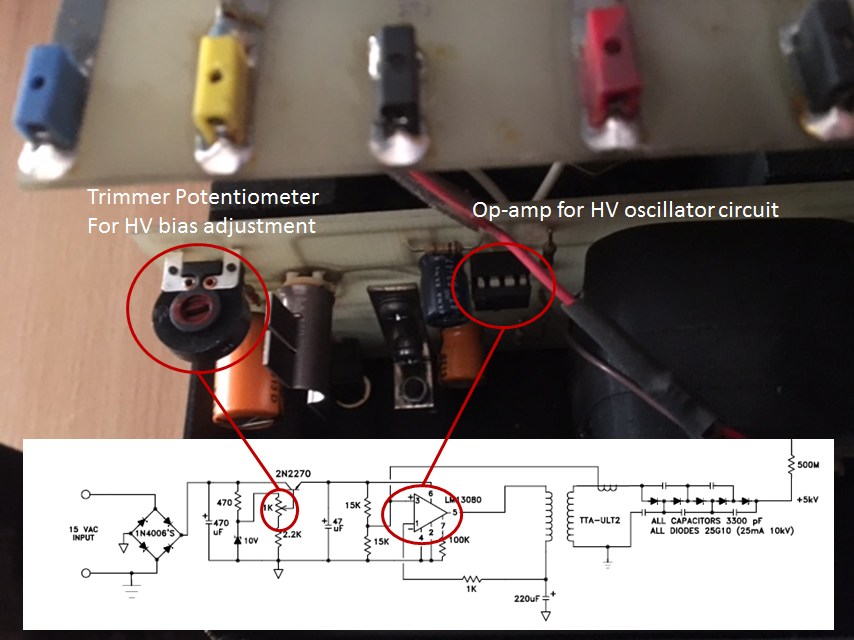

The only thing I can see that might be confused with a bank of dip switches is the 8 pin op-amp identified in the attached pic.
I also circled the trimmer potentiometer used for adjusting the HV bias level using the guidance provided by AAMan in Post#1622.
As mentioned in post#1622, if the difference in level exists at higher frequencies as well as in the bass, it is likely a bias problem.

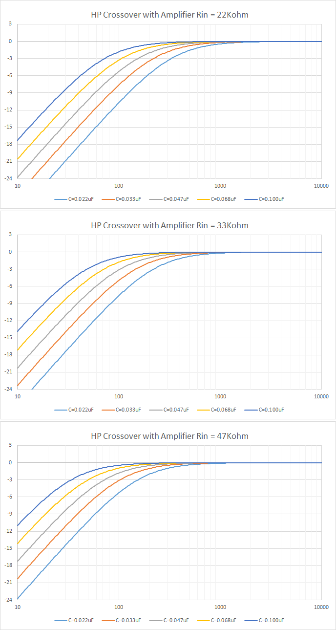

...Based on a 33K input impedance, and a -3dB point of 70 Hz as mentioned in your previous post, you would need a .068-uF capacitor.
I'm not sure if the 33K input impedance is based on a measurement, or just from the spec sheet.
Sometimes the actual input impedance is significantly different from spec due to late design changes, etc.
Attached are some trend plots that might be useful, using standard capacitor values for 3 different input impedances.
