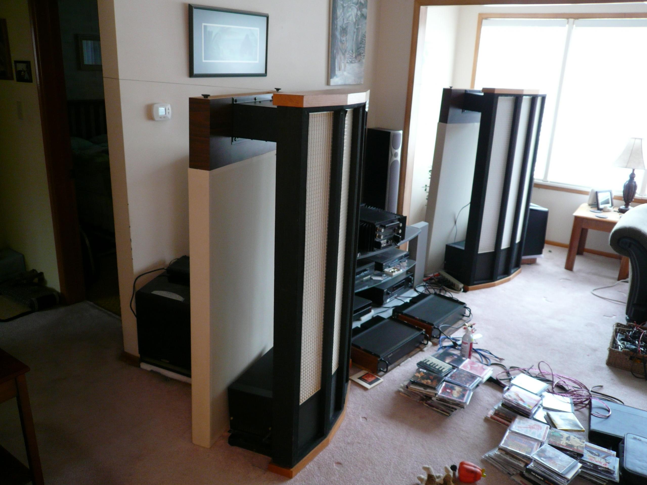

OK, you twisted my arm. Here is a Berning ZH230 amp driving the CLSs. This is a tube amp that uses a switching, solid state "output transformer" to drive normal, dynamic speaker loads. In this application, I bypassed the output stage and connected the tube output to the electrostats via capacitors. The bias is provided by a tiny EMCO unit, E Series - EMCO High Voltage, currently housed in the cigar box sitting above the amp. Despite the amp's relatively low 2 X 75W output, there is no problem filling my 3000SF living room, assisted by a SONOS sub.

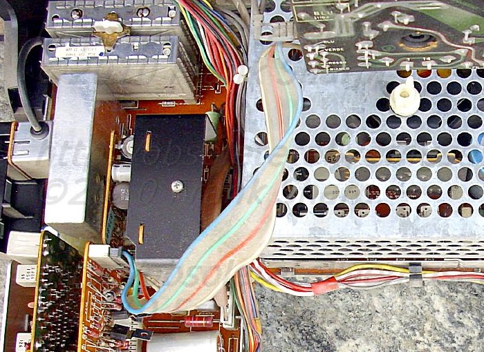

I have a question: see the wiring on the attached photo. That is a high voltage cable from a 70s Italian TV. I wonder if I can find any lengths of that? It would make connecting the Berning amp to the CLSs much easier. Currently I have loose, individual teflon fireproof wires. It is messy. This wire would keep all leads neatly separated.
I have. In fact the set up is such that I can switch from direct drive to the CLSs' original transformer units in less than one minute. Probably because of equalization differences, it is hard for me to comment how they differ. May be if one day I get a bunch of audiophiles together, there may be better consensus. But driven directly from this amp (which, in stereo, is a quarter of just ONE Acoustat amp in size) the sound is so superb, there is little reason to go back to the original, transformered setup (incidentally, I do have original Acoustat amps, which I had beefed up with large capacitors. I do not believe those are anywhere nearly as good).

I have never seen high voltage wire like that, a very interesting concept. There must be some type of plastic clips available to clamp your teflon wires in a similar manner every few inches to achieve the same thing.

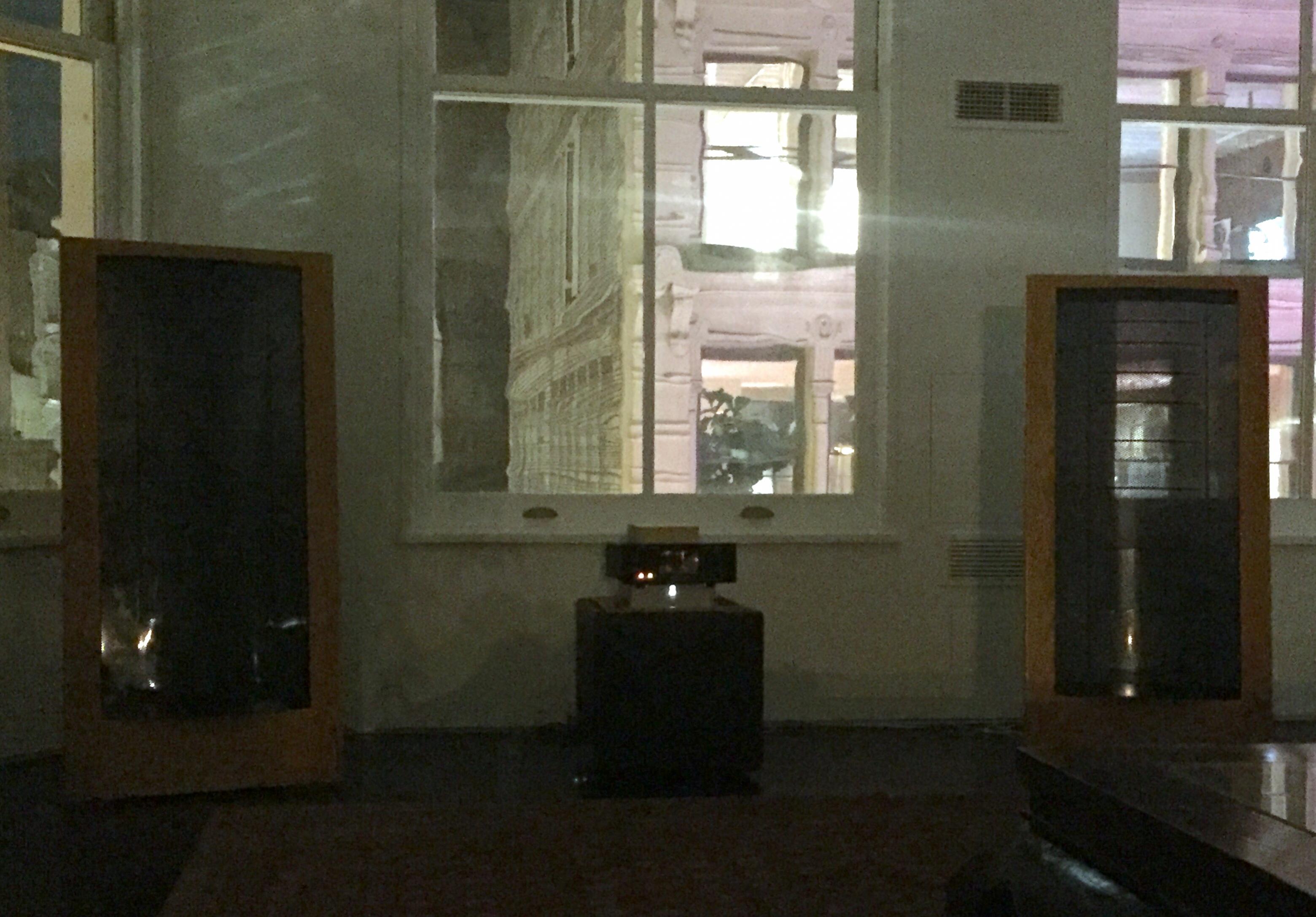

Well the verdict is in. I'm driving the Monitor 3 direct to my OppoBDP95, the Model 3 with a pair of LSR&D Superamp monos from my Meridian 501 pre to the Oppo. So equalization is a matter of attenuation. This is more than a novelty. Dynamics are incredible. Depth perspective is out of sight. It isn't just a little bit better. If it wasn't for the felt backing, this probably wouldn't work.
