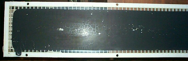

Andy can state again...but I think the coating was put on after the mylar was heated ...
In the pic you can see the cracking that can happen when any ESL mylar is re-headed... if the coating pulls to far in the right spot.. you can Kill bias feed to the panel....good luck

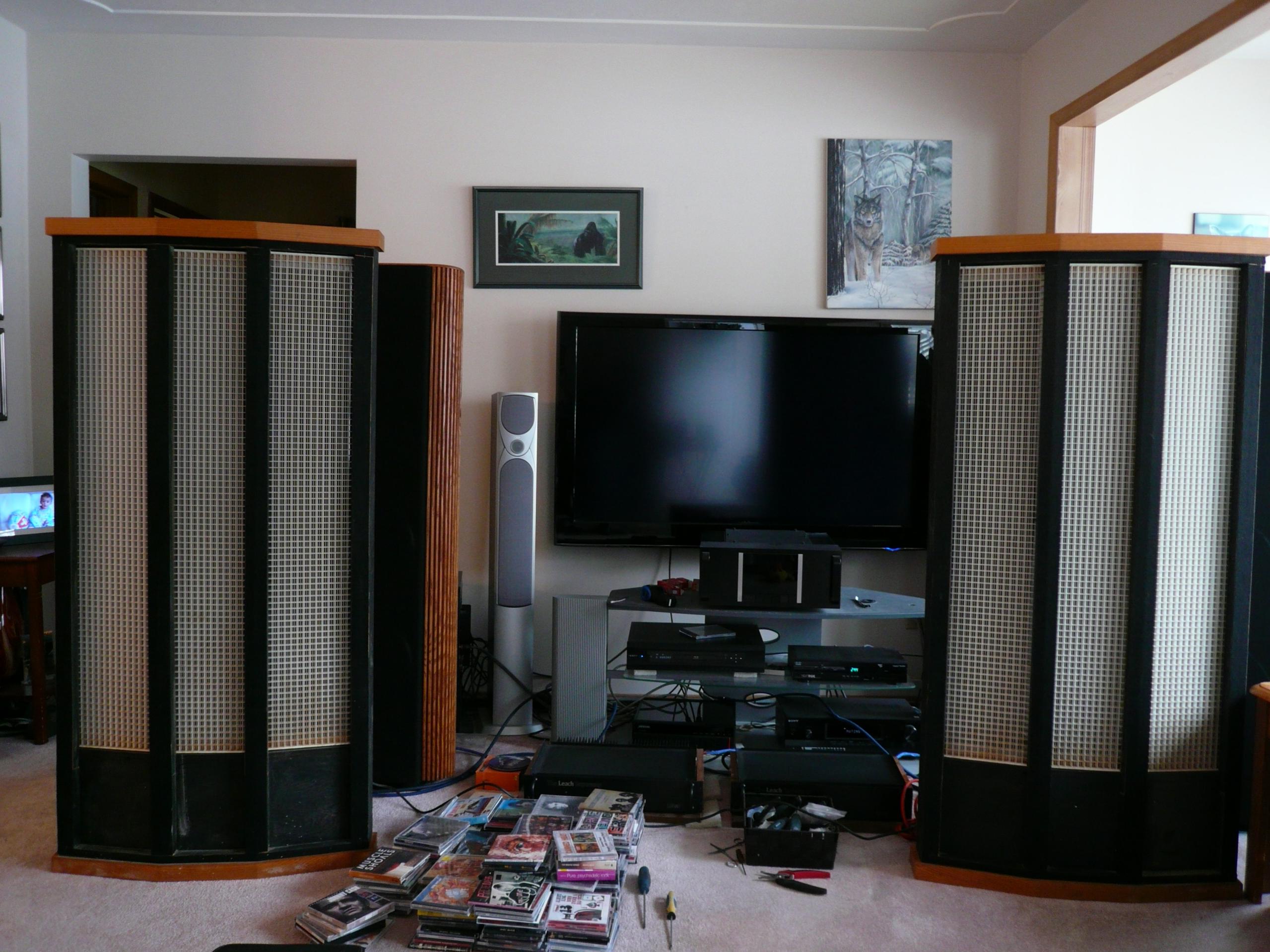

I have never taken my 2+2's apart so forgive me if this is a ridiculous question. It appears that there is perhaps a 2 "square" (plastic grid) buffer around the perimeter of each panel where it screws to the frame. Would there be any advantage to fabricating a metal "frame" 1 or 2 "squares" wide for each side of the panel so that:
A) The screw force could be distributed more evenly around the perimeter of the panel?
B) Additional screws could be added to stiffen the panel if desired?
It seems the correct way to re-tension would be to focus only on the perimeter without any coating. That is where wrinkles would appear, not where the coating is. How can the mylar loosen under the coating if the coating is still intact, not flaking off?

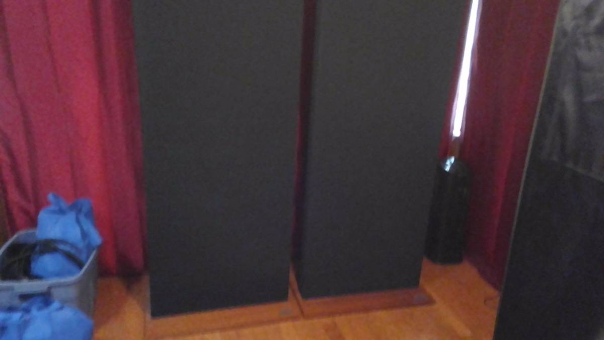

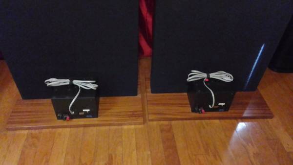

You mean like these? They are 'Monitor 3' since I run them with the Acoustat direct drive OTLs. I also have Model 3 with MK-121-2 Medallion interfaces. Virtually Identical but these with the OTLs are in a different league. No comparison imo. The King is alive and well.
Mylar dose not work like that when heated....well not on 7-8" wide any way.....but go for it...I have 30extra Acoustat panels ...if you or anyone needs any..good luck..
No like these....Acoustat 3s thay were last made...Andy can say for sure

I think you are misunderstanding my post. The panels do not have coating for the first 1/2". The coating itself is not elastic. Attempting to tension the coated area makes no sense. It could only cause the coating to de-laminate similar to painting a balloon and then further inflating it when the paint dries, but in reverse. In any case I have no interest in doing this as mine are functioning as they should.
