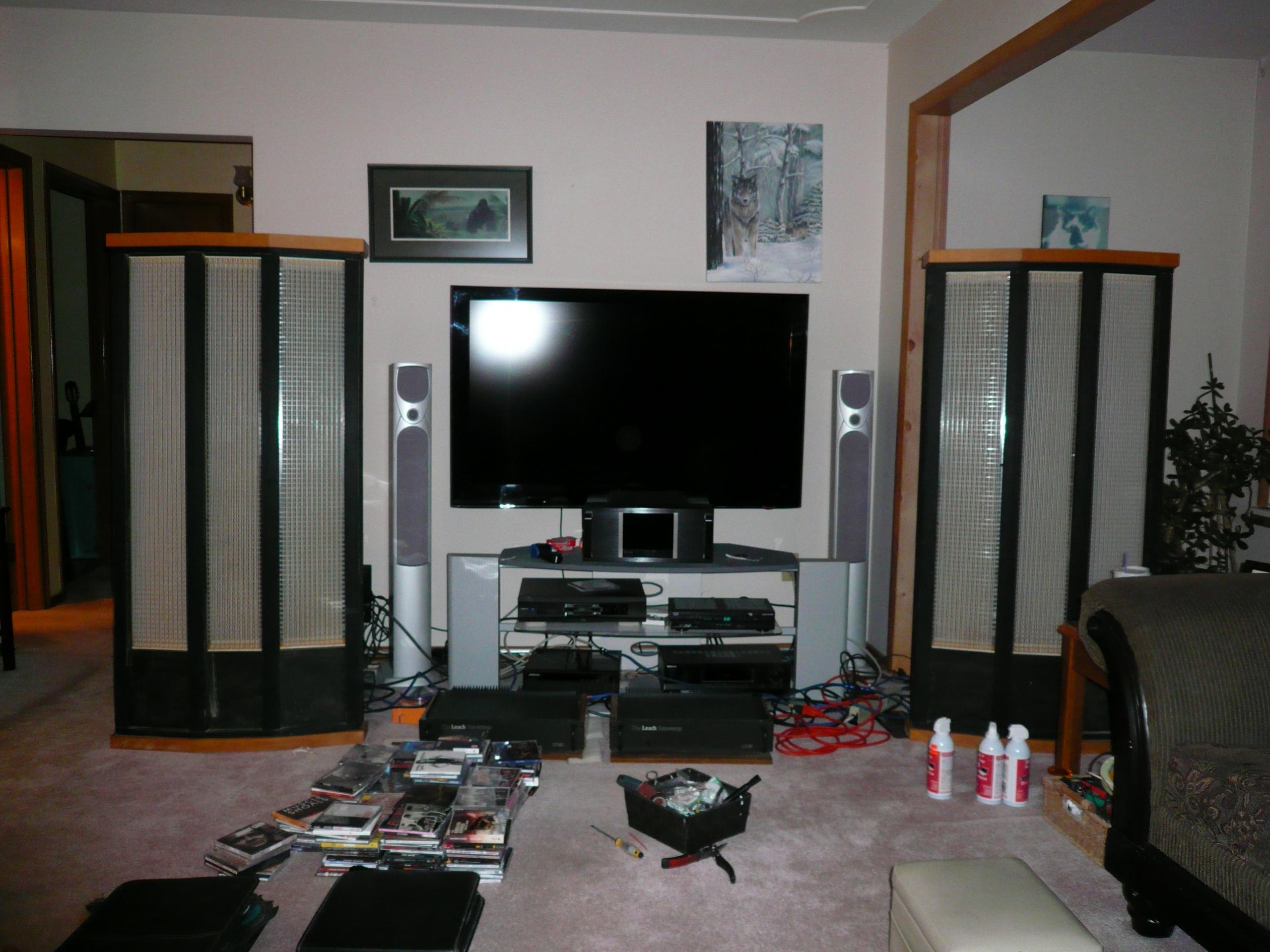

Acoustat Answer Man is here
I just bought a pair of Acoustat 1's and they do not do this in the same space. I believe it is related to the size and shape of the room (22' wide x 60' long x 30' tall). Even with the servo amps I'm getting this effect.
What kind of Spandex did you use for your grille cloths? I've been wanting to try this. Someone once mentioned a thinner grade of Spandex works better.

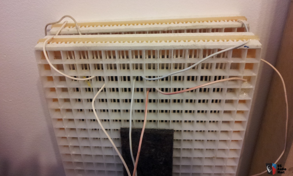

I love the naked look

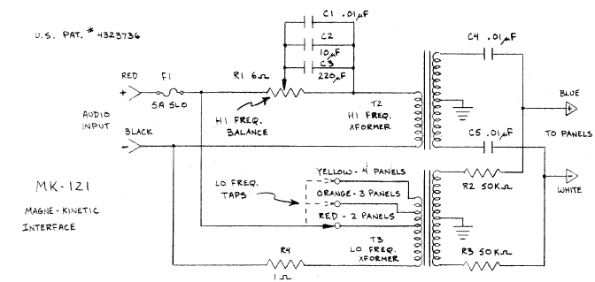

I just have to asked...
If Blue is the positive as seen in the 121 Schematic ....
why is it called the positive if its the back panels wire....?
It like my Acoustat play louder out the back....
As always thanks for any an all info on Acoustats are any ESLs...

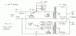

The blue wire goes to the rear stator grid, correct. It is at positive phase (or in-phase with respect to the incoming audio signal), so that when the audio signal is positive-going, the positive electric field on the rear stator grid will oppose the positive electric field on the diaphragm, causing the diaphragm to move away from the rear stator, or towards the front of the speaker.
At the same time, the front stator is negative phase (or out-of-phase with respect to the incoming audio signal), and therefore the negative electric field on the front stator grid will attract the positive electric field on the diaphragm, causing the diaphragm to move towards the front stator, or towards the front of the speaker. Hence, the speaker preserves absolute polarity, where a positive-going input signal causes the diaphragm to move forward.
The opposite scenario happens when the audio signal is negative-going, causing the diaphragm to move towards the rear of the speaker. A simple push-pull system, whereby the diaphragm is always under equal driving force regardless of its position within the gap.
As to why your speakers "play louder out the back" I cannot fathom why that would be, unless caused by a defective interface or room acoustics.
I posted this question ....Because I know most, like over 98% of people never have seen were the blue wire goes on there Acoustat panels.....
For years have found the blue wire moved to the front, an white moved to the rear, on any ESL panel ,sound more like my vintage Apogee an Magnepan ,an even my old JBLs, it a richer fuller sound......well to me.
I have a like new pr of Martin Logan CLS panels that I have been running with a pair of Acoustat MK121 stock interfaces...the blue in front on them, is a nigh an day difference...
Know one I have found like the sound better with the blue in back on the CLSs
Andys dissection makes me feel that my choice is base only on the sound of my setup,an what I like....
No Damage can be done by doing the Switch...
All just one Acoustat owners findings....

So you're saying you like to listen to your speakers out-of-absolute phase. That's okay if it's what you prefer. But a much easier way to "try" this change is to reverse the input wires on each speaker, which does not require disassembly of the speaker and potential exposure to high voltages. It accomplishes exactly the same thing.
Thanks for your info..Andy
On paper all these question you , have been glad too help us all understand, has always seamed right..all here are luck to have some like you....this has been said more than once...an I for one am glad to say ..an I have never meant any disrespect ...
Yes its Right...but to my ears it dose not sound the same..as changing the panels wires....
Go fig...
I do think the Brain-Ear-Room-Audio Equipment, is a tough thing get right for anyone..an it could be said I spend to much of my time doing Audio related things..an I get...there must be rules...at lest to start with...
