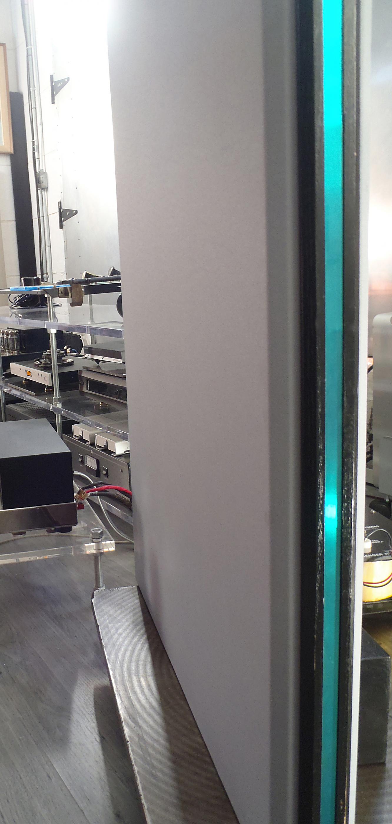

The metal trim on my 6600 is a turquoise colour. Is this original from Acoustat?
Yes, this is factory-original. The turquoise color you see is actually a very thin peel-off protective plastic film applied to the brass-plated steel inlay. It's purpose is to protect the lacquered surface of the inlay, and it's intended that the final user remove it to reveal the brass underneath. This is the same sort of protective film that one sees on electronic devices over displays and other easily scratched surfaces.
Since that film has been on there for so many years, it may not be as easy to remove as it was originally. So you can leave it alone if you like it, or you can try to grasp an edge at the top or bottom and peel it off. Originally, it would have peeled off easily as one long strip, but now it may come off in pieces and/or leave an adhesive residue. I can't say for sure because I've never tried removing one some 25 years after manufacture.
Thanks!
I like the colour as is. When I replaced the sock I had a really hard time lining up the nails on the trim to the holes. If I ever had to remove and replace I will just attach with double sided tape.
