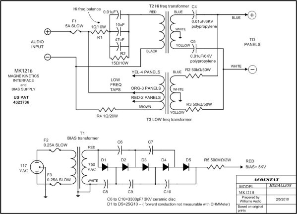

Sounds like low bias....low bias can kill parts in the mixer an the low fr transfourmer as Andy I never seen.... a dead high fr transfourmer
If you can do the work your self....put new diodes an caps in the 30 years 24/7 on all the time......... old bias....
I buy a lot of used Acoustat...1+1 2+2 ,M3,M4,with MK121interfaces......first thing I do is this $50 in parts for the pr... If you cant do the work get a tec...may be $100ea....thats were I would start.
9 times out of ten....if the trans are not dead....new bias parts get the bias back up to 5k....work like new...
This is the first thing Roy E will do with any interfaces.....even the 500 meg panel feeder res..I have some his work here...but I find the stock 500meg is fine a sound great..
With new bias ...I can run 2+2 M3-M4s with a 60 watt tubs amp...loud...your amp fine.

Yes open up the box.....then plug in the Ac wire..... ck for 5k at the output end of the 500k bias feeder res.....leave the wires in place
For the last 30 years...I have owned a lot of Acoustats ....an I always come back to the 1+1s.....why...thay give 97-8% of the sound of any of the biger ones ...but...there the hardest to drive full rang...an hardest on the interfaces....but with each added panel you get 3db more output so drive wise...the M3 is the best....
In the end.. any ESL with out the right bias ...thay well be hardest too drive..hardest on the interfaces parts......an sound off....
all just one mans finding.....good luck

My ultimate plan is to get a 2 ohm non-inductive resistor and use that for the top part, and use the current 16 ohm variable resistor as a fixed resistor for the bottom part. This will only have a small effect on the HP crossover for the LF transformer (16 vs 14 ohms) but in the direction I think is good for me (since I highpass the entire input at 100 Hz).
How can there be a short???
I'll be testing the LF transformers in a couple weeks. Meanwhile, I remember one reason why I didn't think the problem could be in the LF transformers, was simply this:
The LF transformers are connected to the input terminals of the speaker through a 1 ohm resistor. This means that even if the transformer had zero ohms impedance, the speaker load would still be 1 ohm.
NOW, I suppose it could be a little less than one ohm because the HF circuit is in parallel. However, that circuit has two paths: through at least 10 ohms of a 16 ohm resistor (and my measurement showed that part to be 14 ohms), and through the remaining resistance, 2 ohms in my case, in series with the HF transformer. Since we're considering worst cases here, at very high frequencies the capacitors have 0 ohms, so there 10 ohms in parallel with 2 ohms plus the transformer. Only if the HF transformer is shorted could this load be less than 2 ohms.
My amplifier is known to be able to drive 1 ohm loads, though it doesn't have a power rating for it, people have shown that to be true in testing, that it gets close to 1800 watts or something like that into 1 ohm.
But what I hadn't thought of is this: the amplifier may be putting out peak voltages it can sustain into 2 ohms load (at very high frequencies), but if the LF transformer suddenly shorts and brings the impedance suddenly down to 1 ohm, that voltage is no longer sustainable.
