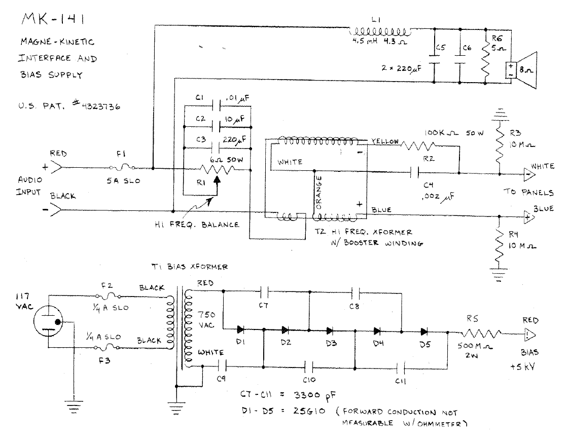

I spent the time tonight to become familiar with these less known interfaces. Attached is a PDF of my hand drawn schematic as well as a picture of the inside. The main difference from a MK121 are the one missing Transformer as well as the RC network that is applied between R1 and T1. I also used my 80k-40 HV Fluke Probe and measured about 4450V on both speakers between D5 and R5. Given the 5uA load that this probe places on the circuit that normally supplies 10uA through the 500MOhm R5 load, I think that number looks pretty normal. Any thoughts on what parts I should replace? At the moment I am looking primarily at the Diodes and Caps in the Voltage Multiplier, Caps C2 and C3 as well as upgrade of the Binding Posts for better speaker cable access. Thoughts or suggestions? c.S.

Thanks for posting the circuit for your MK-131...I had never seen one before. Looks extremely similar to the MK-141, just a few component value differences I think.Attached is a PDF of my hand drawn schematic as well as a picture of the inside. The main difference from a MK121 are the one missing Transformer as well as the RC network that is applied between R1 and T1.
Actually, now that I look at your schematic more closely, are you sure that the primary of your transformer is part of the same winding as the purple and orange wires? Most likely they are two separate windings, physically arranged one on top of the other, but not actually electrically connected. See attached MK-141 circuit.

The bias voltage you measured is good and does not indicate any need for repair to the power supply. However, considering the age of your speakers, and the fact the capacitors (and sometimes the diodes) are known to degrade with age, you may want to consider replacing them now while you’re doing other work. I posted information about suitable replacement parts recently in some posts above.
Replacing the binding posts is a fine idea. Just make sure that the new posts are both properly insulated from the metal chassis.
I don’t have a schematic for the MK-131, but as pointed out by bolserst, it is very similar to the later MK-141. I don’t know the difference between the two transformers, as the change from ‘131 to ‘141 was before my time. However, the primary and secondary connections were basically the same, so your schematic is not quite right (but how would you know from looking at the outside of thetransformer?). The single transformer, limited frequency range MK-131 was first developed for the Modular Hybrid (MH) Series, and was also used on early Model 1+1S hybrid systems. The MK-141 was first used on the hybrid Model One, and at the same time, the Model 1+1S started using the MK-141.
When you said the old woofer had only “one set of connects” are you saying it was a single voice coil woofer? If so, I don’t think it was the original woofer. The original woofer was a dual voice coil model, so that inputs from both left and right channels would be summed into a single woofer. Likewise, there should be two sets of crossover components inside the woofer box, one for each channel and voice coil. The Dayton Audio RS270-8 appears to be a single-coil woofer, so you are listening to bass from only one channel. I recommend you should change this to a similar dual-coil woofer, or construct another box and crossover for a second, single-coil woofer. Or chuck the whole passive woofer idea and use an active system. Dayton also sells some decent powered subwoofers for not a lot of money.
Performing the “C-Mod” is recommended. It’s easy to do with commonly available parts, and will decrease high frequency distortion. I also recommend upgrading the C-Mod’s 47-uF electrolytic with a polypropylene capacitor.
The high voltage capacitor on the printed circuit board can probably be left alone,as it’s already a film type and not commonly known to degrade. It’s also tough to find the correct type with sufficient high voltage rating.
