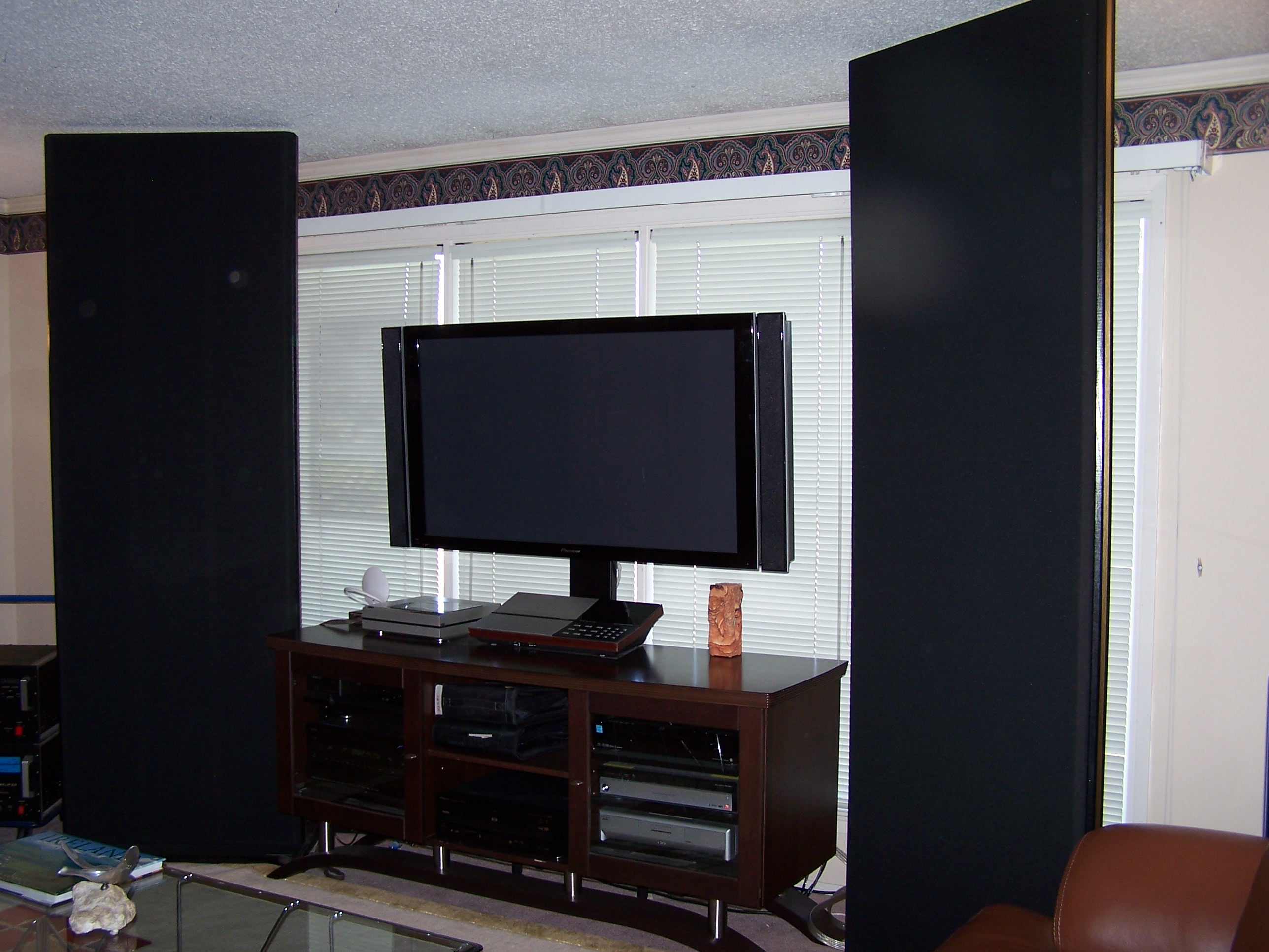

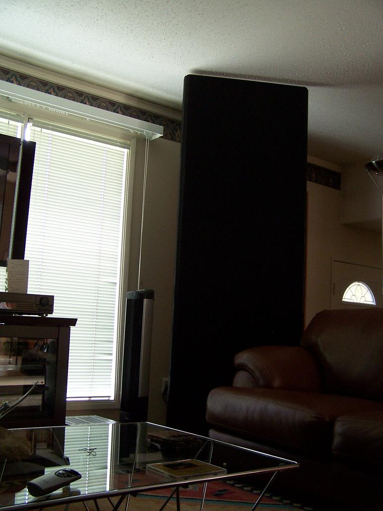

I have been very fortunate having owned 2 pairs of spectra 6600's and a pair of spectra 66's. I have since sold one of the pr of 6600's and the pair of 66' s to person near Edmonton Alberta Canada.
The pair I have left have moved several times across Canada that will be my last speaker ...jokingly I have said to my wife bury me between them..and I will be in heaven
I have attached some photos of them

The Spectra 6600's that I enjoy in some of my listening areas. The rooms may not be ideal but the music is always pure enjoyment
You were obviously lucky in your choice of wives. For most anyone else, bringing a pair of speakers into HER living room that look like the obelisks from 2001 would get HIM buried then and there. 😀

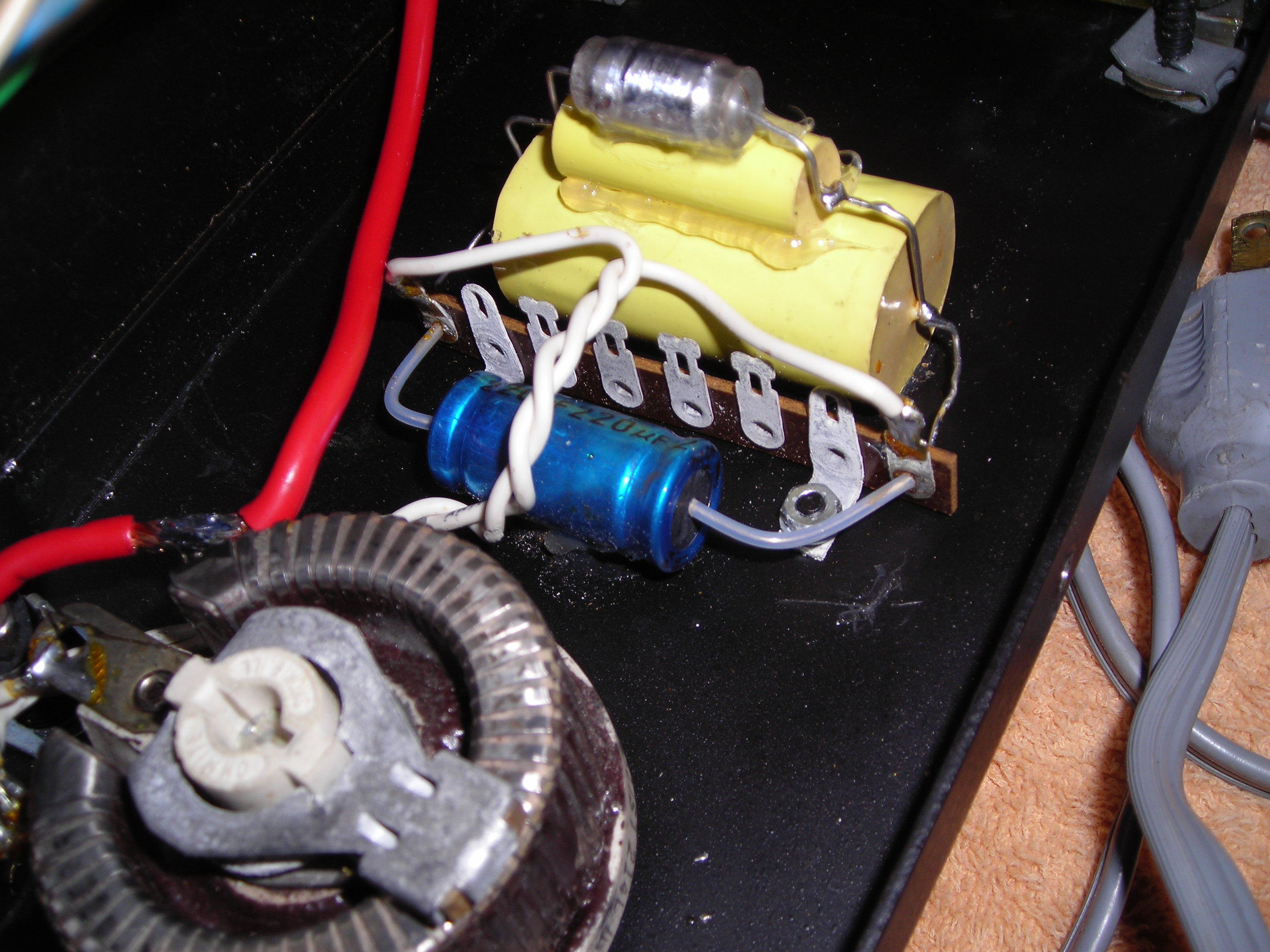

Help needed for Acoustat 2+2 (MK121-2B)

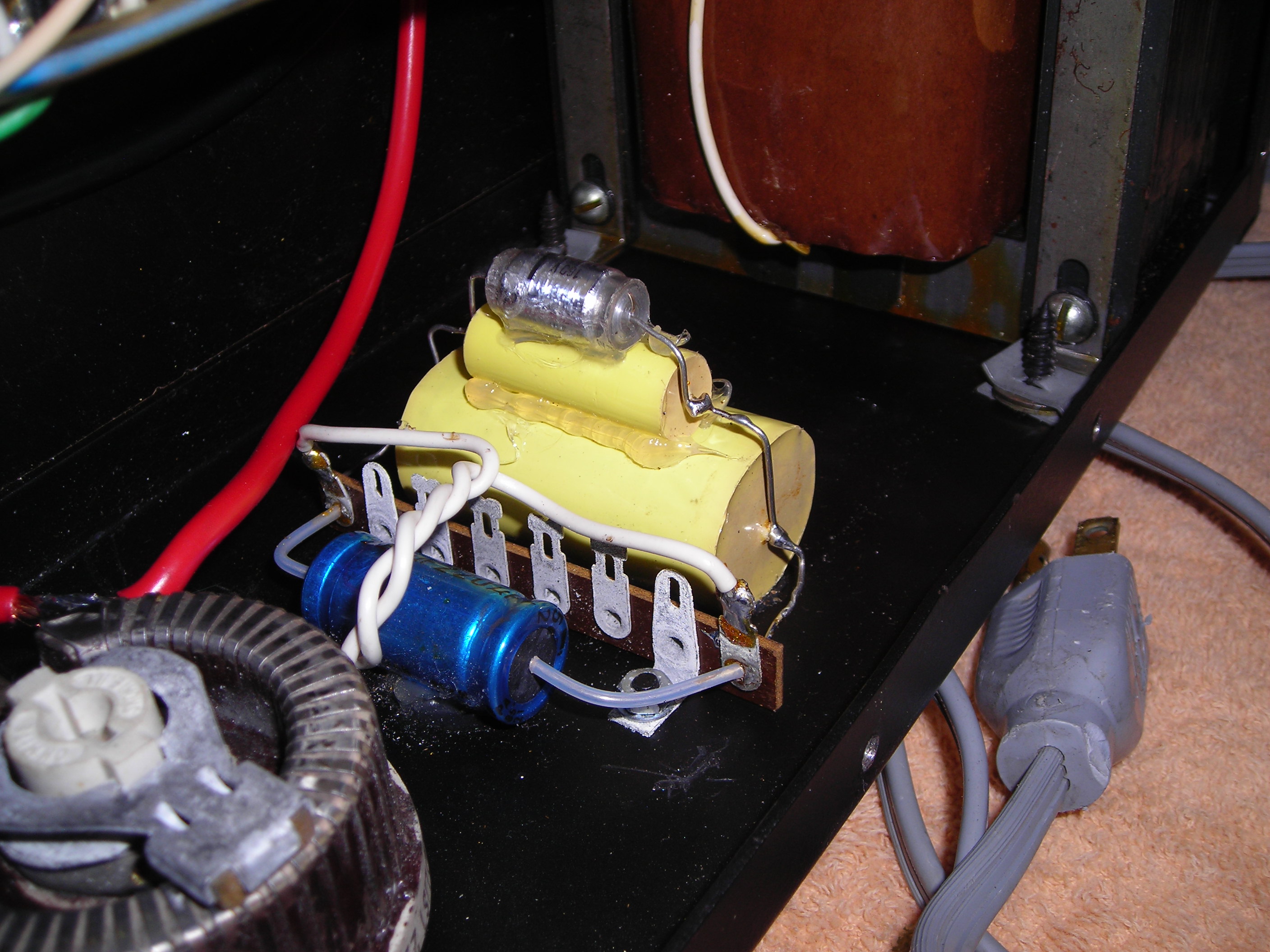

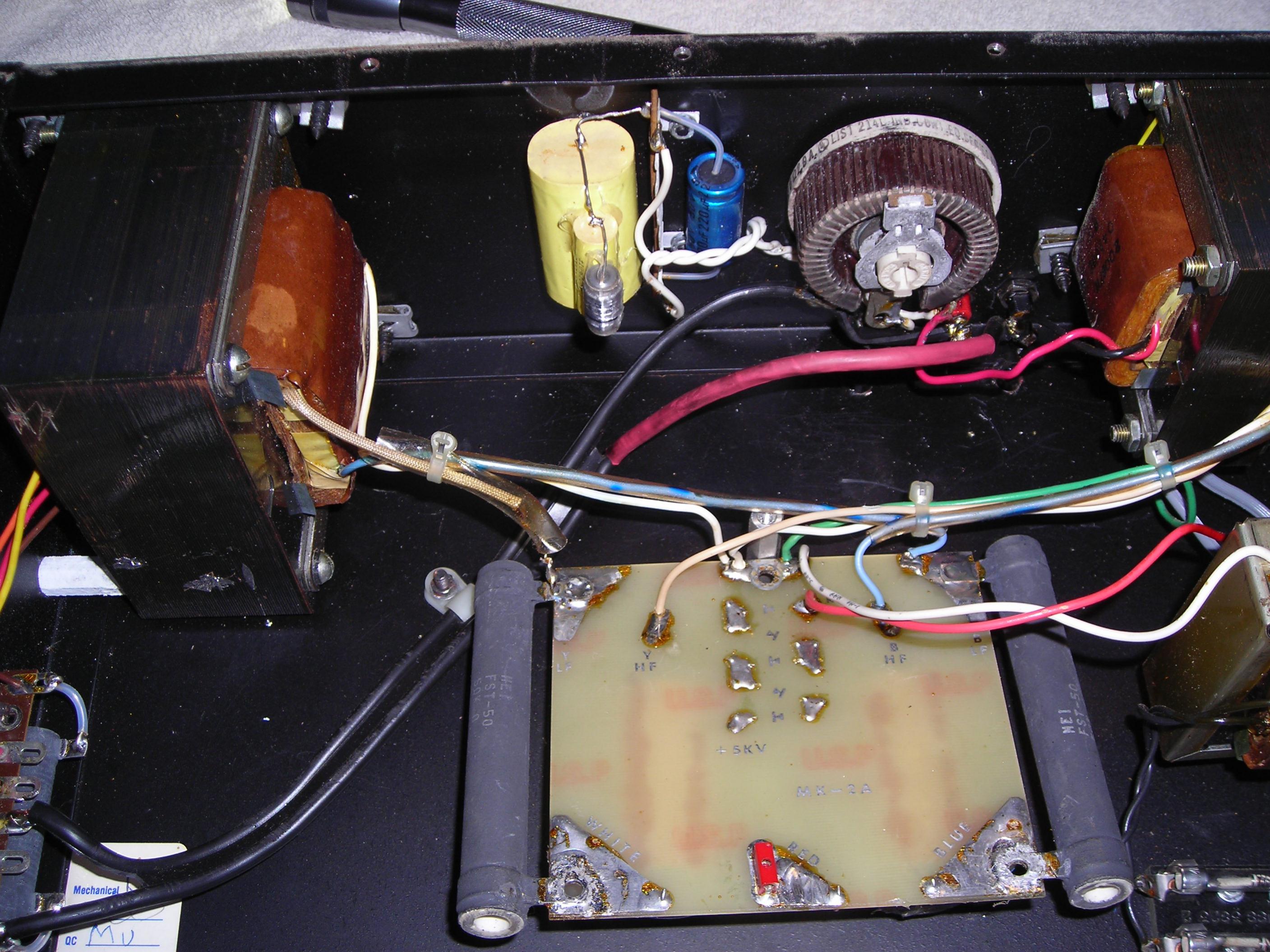

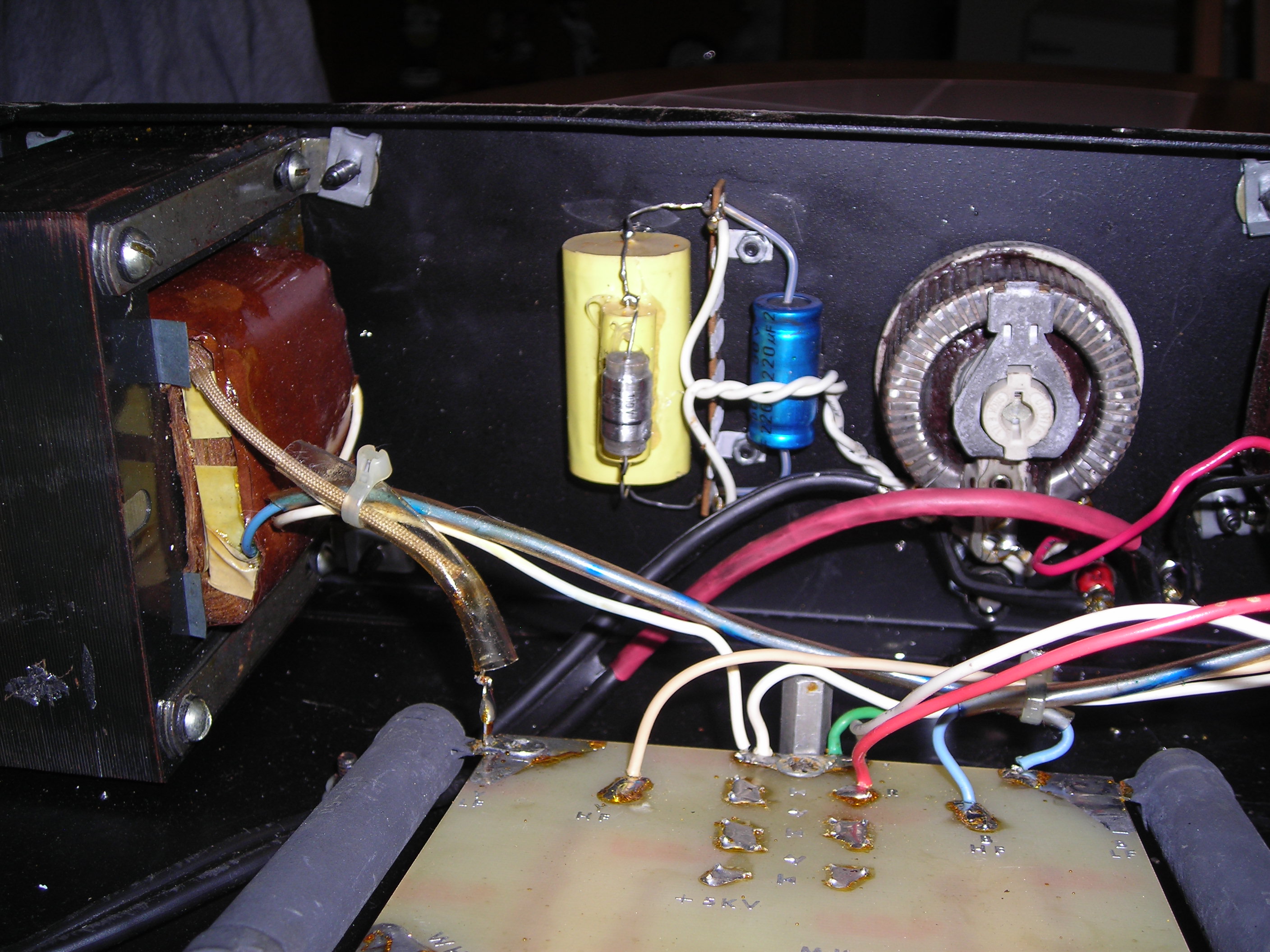

Hey guys! Need your help. I am trying to replace the old capacitors in my MK121-2A interfaces.
I have (3) total stacked together (see pics). The values I can read are 250V 10uf, 200V .47uf and 27 000 160v that's the little electrolytic cap on the end of the (2) yellow caps.
The schematic I have doesn't show the electrolytic and the .47uf is listed as a .01uf.
What should these values be? And should the electrolytic cap be left off or what should replace it.
I've already changed out the binding posts and old Monster wire and put on longer, bigger gauge AC Power cable.
Thanks for your help!
