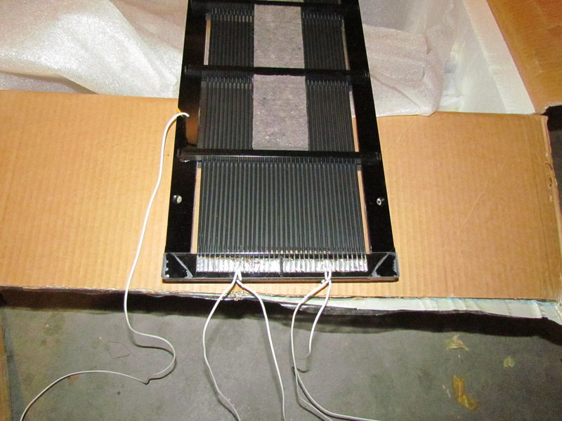

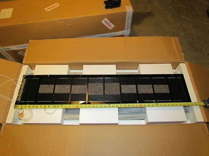

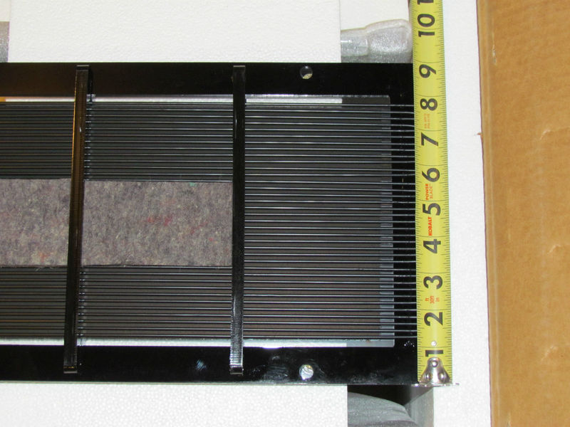

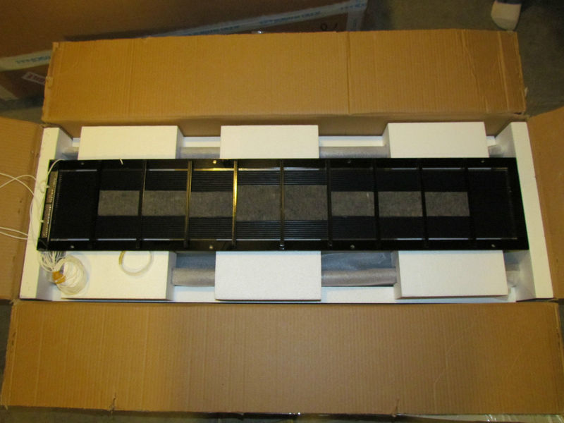

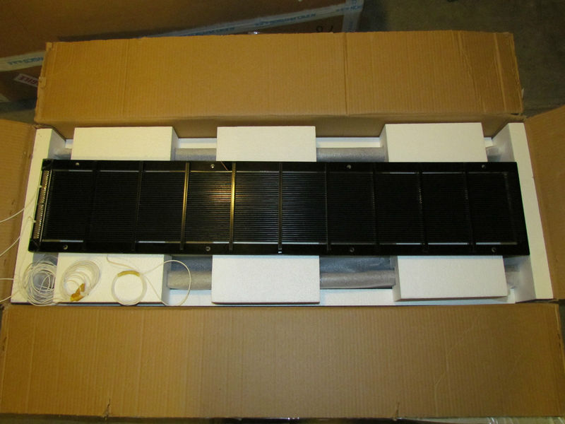

Scale of the Spectra 66's
Hi Andy, I submitted these 2 pictures in reference to one of your recents post mentioning the scale of the Spectra 66's. I had these pictures taken when I bought my pair of Spectra 66's from the seller in Sequel, Ca. At 5" 10" I look puny in size compared to the 7"10" height x 29" wide size of the Spectra 66's.
